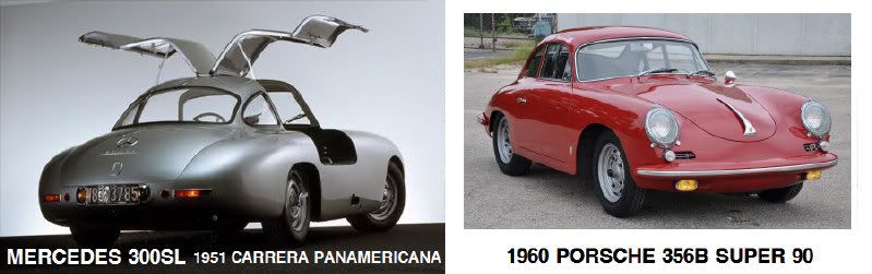

Mercedes first used it on their swing axle 1957 300SL Roadsters, an evolution from the iconic (swing axle) gullwing coupes. The 300SL's had coil springs in the rear, and the camber compensator was mounted above the differential.
Porsche followed suit with the 1960 356B Super 90, in combination with slightly softer rear torsion bars. So modified, the Super 90 was 20 seconds quicker around the challenging Nurburg Ring. Not 2 seconds. 20 seconds.
Source: March 1960 Road & Track, Super 90 Road Test.
