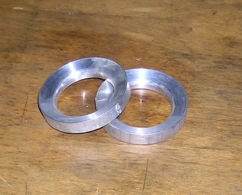

Original end seals get replaced by these:
This provides a metal to metal bearing surface. I see they're now offering these with a roller thrust bearing - sweeet!

Yeah, I run those in nylube as the roller bearings are hard to seal for off road use (the ones on the rods are easy as you can cap the tube), and ours are top hat style so they act as the outer bearing too.

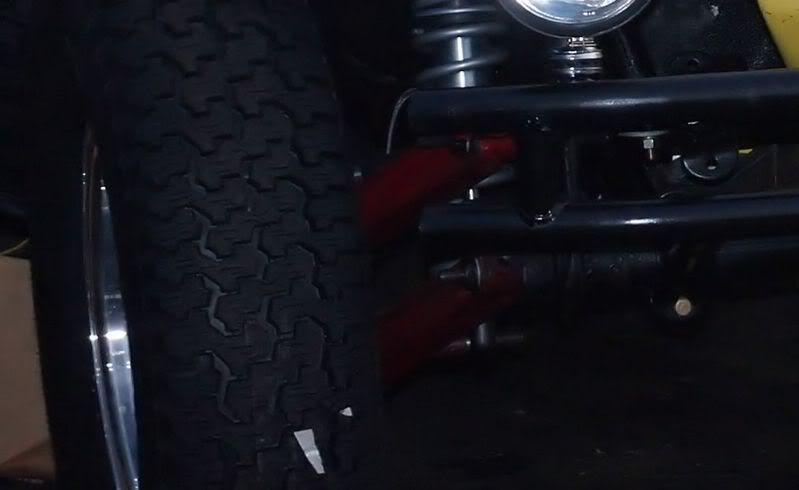

Here's a not so great pic of mine that I cropped from a fullsize pic.r1cpowdercoating wrote:ok maybe i'm having a gerital moment but how do make the trailing arm stay in the beam with the through rods? do you just slide the spring leafs out and install the thru rods with the small ends and just tighten the set screws and that is suppose to hold it all together?

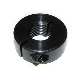

It's just a long rod threaded at each end that takes the place of the springs. Mine uses teflon washers and pinch nuts like these.

sorry been a way for awhile. but that is the best pic I have seen. I did not know that I had to drill a hole in the end of the trailing arm and let the rod stick through and use the lock nut to hold it all together.
ron
ron
Re: REAL adjustable coilover shocks
I lightened the picture up a bit.
