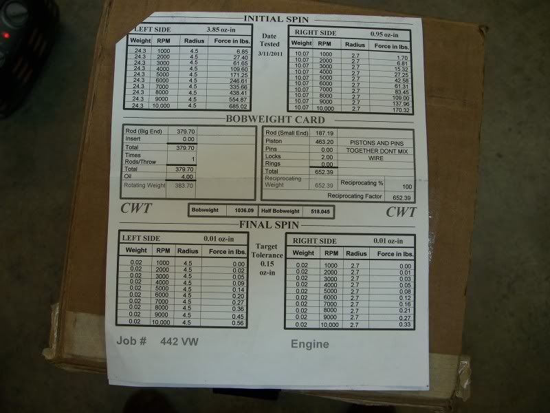

You'll be glad you took the time to do it right. I had my "balanced" Super Race crank re-balanced with every other part of my rotating assembly: Flywheel, pressure plate, timing gears installed, pistons, rods, etc. and was very happy I did. They took a little weight off every cheek on the crank instead of just one. They trued up the crank first and use it as the spindle to balance the FW. A true balance job should come with a print-out of the results, otherwise who's to say it's actually balanced?
Here's what you're looking for if you spend some $$$ on a balance job.

Yeah, there is a highly recommended shop in town ... many of the SCCA club racers use him. Planning to go there. He said he needs the crank, rods, pistons, FW and pulley to get it balanced. I've got it all but the pulley, which is having the reluctor wheel installed. That definitely needs to be balanced.
I would be expecting results on paper.

I do balance jobs and machine work. Even the paper does not say squat about your item. you still have to take the shops word that it was your assembly that hung on the machine when the printout was made. You still have to trust the work on paper, don't you?
it is like doing an emission on a car that won't pass. a shop can run a different car and certify a car that was never on the rack.
If you want to see your part being balanced and read out on the machine, you need to see it on live video. someone gave me the idea coz I did not hook up a printer on my dynamic balancer. Most of my friends will just bring me the parts and we balance them right there while they are watching the machine. We reach a number they require and we stop.
But the video file is a good is not a bad idea.
Let me know if I can help some of you fellas w/ balancing.
