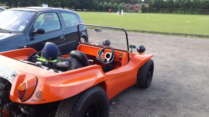

And finally, a picture of the buggy on its first outing :D
