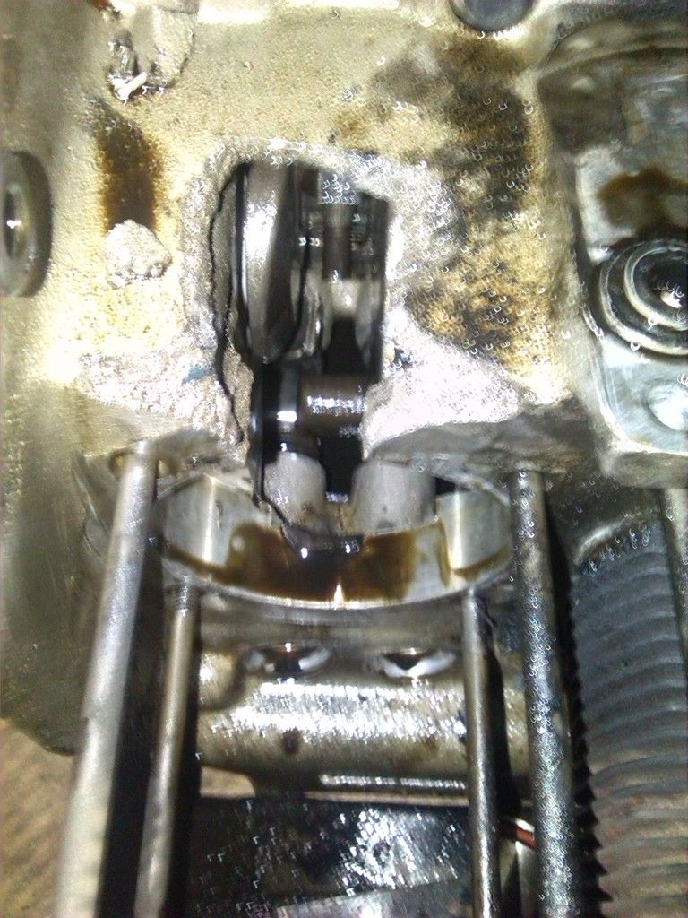

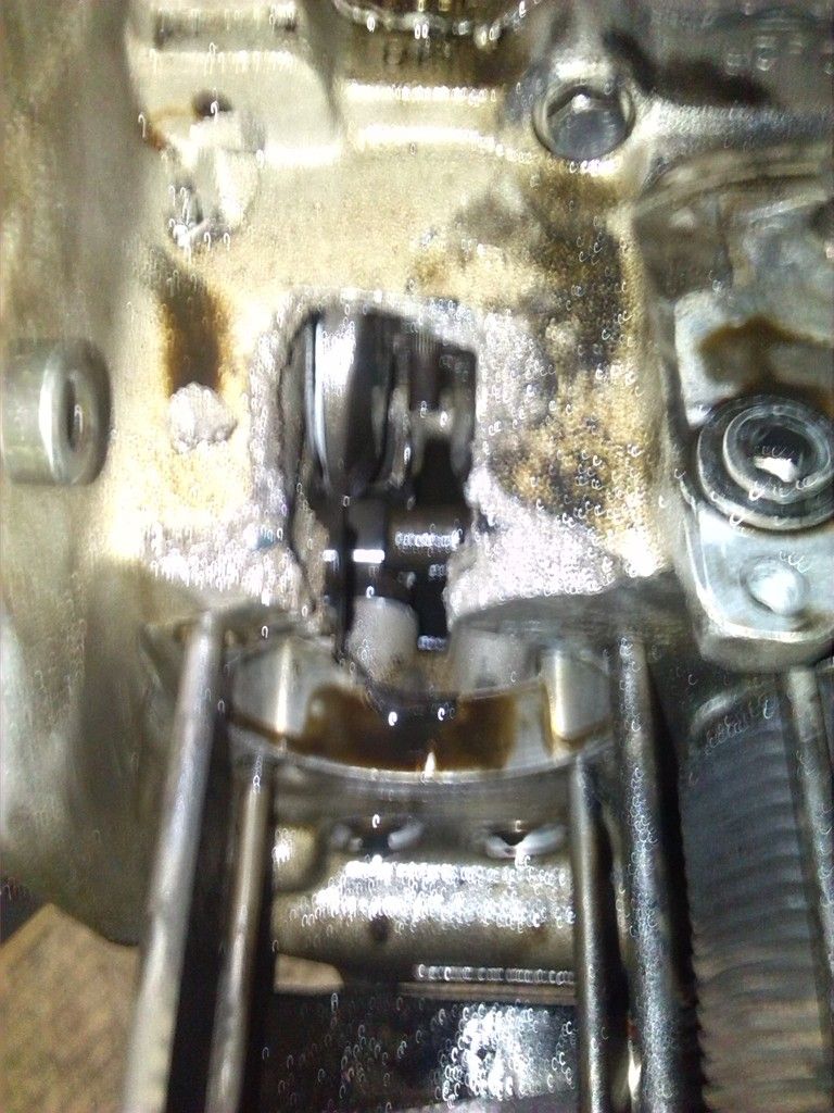

Years have passed... and engines too
After that ordeal, I managed to buy a AS41 mexican
Everything was well until i cracked a crankshaft on sept 2014 and blew the case with a rod....
Bought an Autolinea case GREAT! now, i blew the case again with a rod (curses)
Now, the prospet of buying a new is long term project, very long.
I need the car running.
My idea of short and long term solution is to:
1) JBweld the first case (AS41) for a temp fix.
2) Repair (welding) the Autolinea case.
Am I in a good track? Or my idea is wack?
Thanks for all your replies back then, made me more savvy about vw engines, but one can never get too savvy.

- JB17Atita
- Posts: 38
- Joined: Sun May 24, 2009 6:07 am
Re: NO oil pressure HELP!!!
Thanks for the quick replies, guys.
Yes, I'm checking into the "why is it still blowing rod" thing
I'm starting to think that I might not have torqued it right (32ft/lbs)
Or that I did not secured the nuts ????
What could be a safe torque value or a way to get those nut submarine tight?
BTW I have a OEM rod that doesn't have the slots to pin the nuts secure.
Is that legit? Is it ok to have a rod like that? And if so, I asume that the torque value is higher.
- Posts: 22851
Just because a rod gained its freedom does not mean it was a rod that caused the failure.
The odds of the rod itself failing (not due to other causes, like poor oil flow, etc) are tiny on a near stock engine.
Were the nuts missing?
Was the rod bearing and crank discolored/munched?
Have pictures? We love pictures....
...Nice, detailed close up pictures of carnage are favorites, may allow some failure analysis.
- JB17Atita
- Posts: 38
No pics till tomorrow that I start the tear down.
What else could've caused it?
- Posts: 22851
Case mains beaten out, causing low oil pressure to the rods, rod bearing fail>failed rod>hole in case is typical..
A bigger than stock oil pump does not prevent//fix this, and it will cause other issues.
A counterweighted crank and good balance job greatly reduces the "case beaten out" part, allowing even an otherwise stock motor a much longer life.
- JB17Atita
- Posts: 38
- Posts: 22851
Ouch. What does the crank look like?
I hope the lifter bores are still OK, if that is the aluminum case it may be worth repairing.
Mag can be welded too but far more welders are able to deal with aluminum, and less risky.
