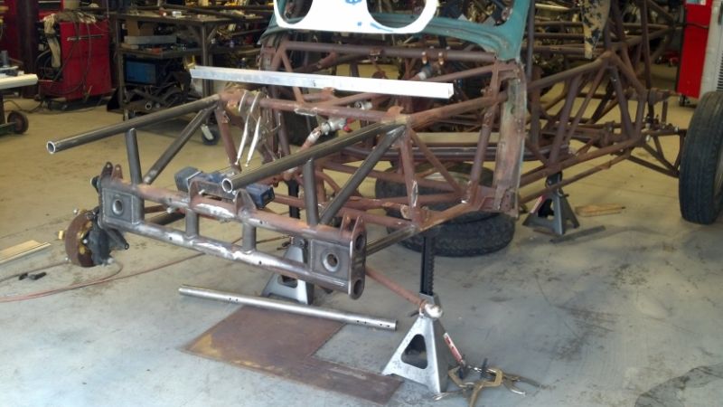

I would still like those A pillars!!!
6" in front of the seam and from the hood opening down to the rocker. The outer 4"-5" of the dash would be a good place to cut too.
Let me know how much $.
Thanx,
Cameron
Need them for the front of this car.
