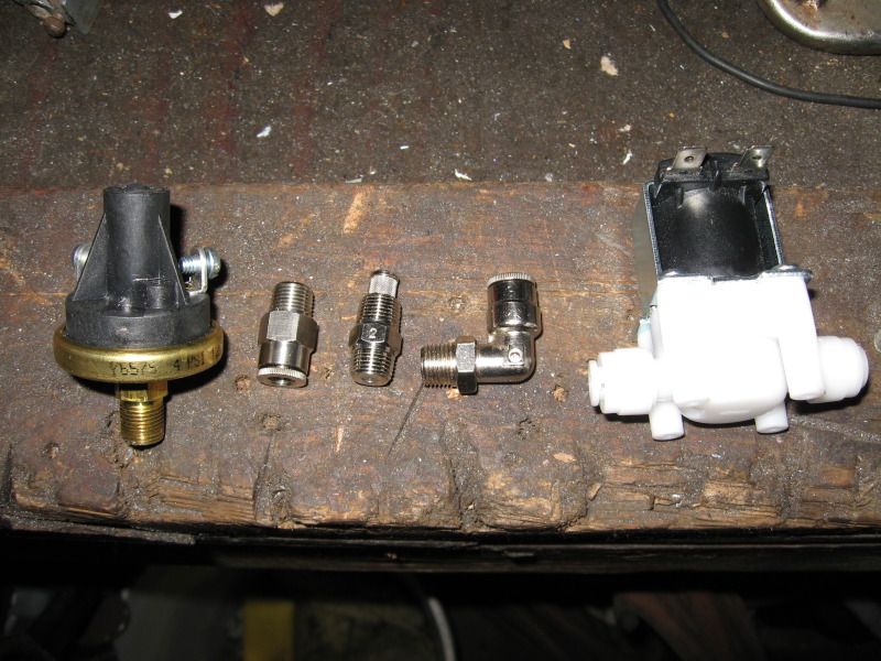

This is sort of what I used to build my setup....rubenski wrote:Thinking of a w/m install somewhere down the road too.
Got a build topic where we can take a look?
http://www.turbomirage.com/water-alcoho ... -list.html
I also read a lot on this site...these guy have been pushing power through an airlcooled engine for a long time and seem to know their stuff.
Lot's of great reading if you dig deep enough...They are all about weight and packaging due to putting it on a Bike but it still is good info I think.
http://www.rbracing-rsr.com/waterinjection.html
For you it will still come down to packaging. It was an issue on my buggy too.
You can see the tank and pump on the right side of the pic hanging from the torsion bar.
If I was to do it over again I would buy the pump from "Devils Own" or someone and maybe the nozzles and then source everything else locally.
All the push-locs and hose can be bought at your local fitting supply store.
The Electric solenoid can be bought for about $11.00 on Ebay.
The Hobbs switch is about $40.00 at my local NAPA Store unless you are going to use an ECU to control WI.
On my buggy it stops the detonation from around 8-10 lbs all the way to 22 lbs so far.
You must make sure it works all the time and never runs out of mix. Bad things will happen when pushing that hard and there is no water......I have an EBC and with a flip of the switch can turn the boost down to the stock waste gate setting of 6 lbs. A good fail safe.
I also installed a low water level indicator light so I know when I am going to need to add the Water/Alcohol mix.

Wonder if that low indicator would trigger your EBC?? One for Mario to work out lol
Clonebug
- Posts: 4756
Re: Safe boost pressure?
Yes you could have it trigger a relay but the problem is when the lower fluid levels make the light flash on for just a second or two. It's quite easy to just hit the switch on the dash and turn off the EBC. I have a second switch next to that to turn off the WI.
