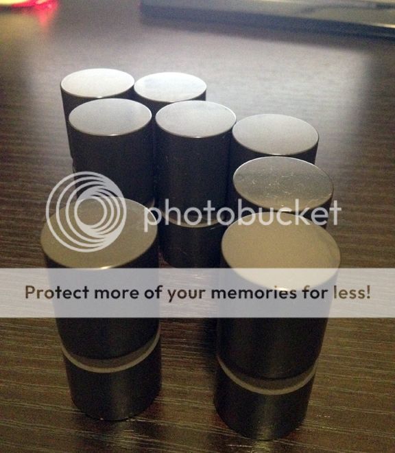

The lifter on the right is an original 356 lifter and the one on the left was one of the old stock 39g lifter, and then the standard bronze bushing.Steve Arndt wrote:I will post a pic of mine. My bushings are shorter, and made of silicon bronze. I am going to run a fairly mild cam compared to Hotrod so maybe I will be okay. I'm sick of high rpm engines. My case has the bushings, is machined for the PTP/BAS 911 fan ring, 911 oil piston squirters, bored, decked, etc. etc. I have a chingaling load of money in it.

Are you Guys making the bronze bushing yourself? In that case, what is the excact type of bronze you use?? Or is it possible to buy them anywhere?? Im planning to use either Udo becker or Thorsten Piper Tool steel lifters in my Next type4 engine, and i should be able to Mount the bushing myself, but i can't find them anywhere.
Those aluminium bushing sure looks nice Richard !

The Aluminum bushings came from Engine Plus I believe, and down the road if necessary, I'll have them bored out to except Type 1 lifters.Hummel wrote:Are you Guys making the bronze bushing yourself? In that case, what is the excact type of bronze you use?? Or is it possible to buy them anywhere?? Im planning to use either Udo becker or Thorsten Piper Tool steel lifters in my Next type4 engine, and i should be able to Mount the bushing myself, but i can't find them anywhere.
The Bronze bushings are made from I believe the same material as valve guides are made from and EMW makes them from Bronze stock as needed, so I don't see why you can't call them and order a set.
Here are a set that were for the 356 Style Lifter, that I had them open up for Type 1 Lifters, the lifters used were from Udo Becker, in my 2.6 ltr.
