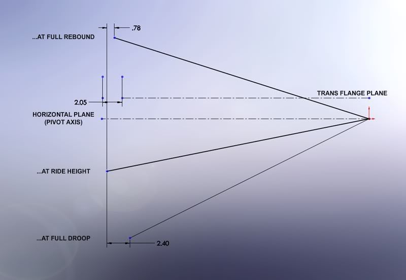

i STOLE THIS FROM ANOTHER THREAD
was wondering how it worked out for you
DesertGuy wrote:Its funny that this thread has "re-appeared"... I am getting ready to mount my trans next week and have been thinking about this again. It "seems" that by minimizing the compound angle associated with the fore/aft movement of the axle would give more axle movement equaling more travel without binding/clicking. I am going to use as a "starting" point setting the trans 2.05" forward when the flanges are parallel and see where that goes (for my dimensions)... By moving the trans 2.05" forward would "equalize" the fore/aft variable to .81"... on a 24.00" axle would amount to 1.93 degrees... we'll see
Here is what Im thinking at this point... as always it is subject to change. :lol:
Comments/criticism always welcomed.

KBWAKESK8 wrote:i STOLE THIS FROM ANOTHER THREAD
I took all of those formulas I mentioned in that other thread (The "Sweetspot" One) and plotted everything out. What I found was that all of the formulas landed you in basically the same spot. My final numbers are a little different than the pic but not by far. For my application, the "sweetspot" had an allowance of 1.50" +/- fore/aft before any changes were noted that had any concern. Keep in mind that I will be running in the neighborhood of 31" axles (cannot remember exact length now but its written down somewhere). Im sure the "sweetspot" tightens up the narrower you make the footprint of the car. Where I ended up setting the trans, I will not exceed 21.5 degrees in the 20" of travel with the 935 CV's.
Basically, given the width of the car, the more forgiving that measurement is... for the sweetspot.
