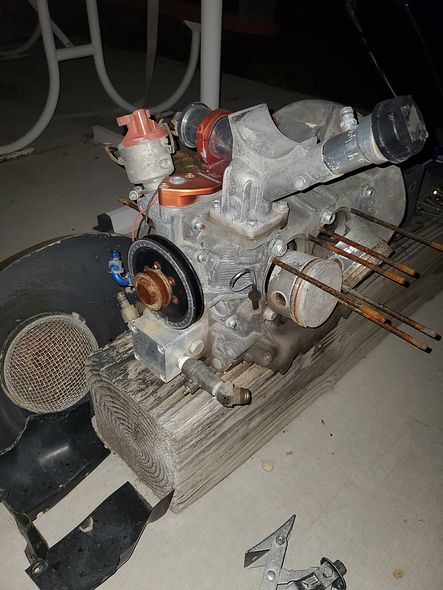

What have I done so far? Nothing really. Well, that's not all true. I bought an offroad racecar. It is a rail, and I wanted the engine out of it. I was told 2L but after tearing into it, it is a 1915. It is all CBP parts. So the guts are good. Im not sure I want a 1915. I like fast and fun. Not a daily driver. My last 2206 was a turbo, and it was fun. There was not much difference in size. Im not sure I want to to turbo again. I am going EFI. I will likely buy a kit, but I may dive into the system people here build. What say you? High CR NA 1915 or stroker or turbo 1915? The only reason I'm thinking of 1915 is the quality parts I have from the race car. I don't know much about building the engine. The heads look different to me. Deep cut. The engine has a dry slump, likely to be removed. I like to make it myself but fear messing it up. The engine builder for it is in Reno. He said 3k to rebuild it. Long block. I talked to another builder, but he refused to rebuild anything but a stock engine for the Nevada desert.
Im open for ideas and decisions. The racecar also has a three-rib, likely built for racing trans. Im not sure what I'm going to do with the Car. I already stretched it and raised the roof to fit into it. It needs a new A-Arm front end built.

Not sure what I have here. Yes, some rust, but any details on a 48cc and flycut data?
