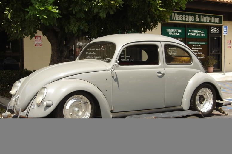

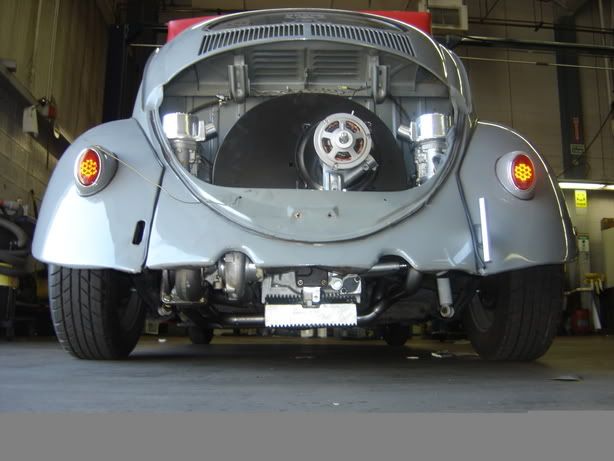

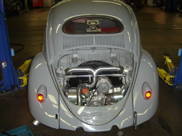

8) Hey guys. This is my first post. This is my fourth bug I've owned. It's a 57 bug. I got it from Cali. (Thanks Paul). I plan on building a 2332cc T04 muffler, under the deck lid, 11sec bug. here's some pics of my progress.

This looks like a sweet set up :D BUT why the carbs and not itb's
With efi you will have a lot more control on timing and fuel .With the carbs you are alway going to be messing with it :?
But i must say that it is a megga claen set up you have there
If you do step up to efi do your home work befor you spend that cash
efi is not cheap and ge a set up the someone you know can tune it right for you .You can spend $1000-3500 on a ecu and not gain a thing at the end of the day the efi is only as good as the tuner have fun with it we would like to see more pics
www.emeraldperformance.com :wink:
