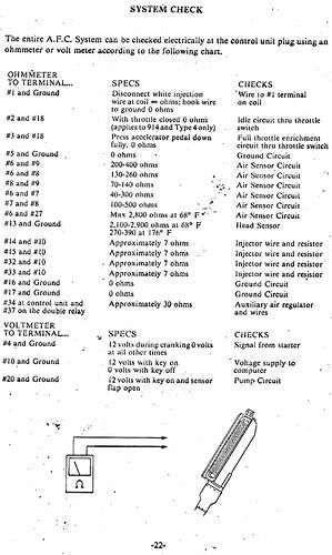

Posts: 14100
Type II FI diagnostic chart
This may help also.

Posts: 14100
I tried to make it bigger in paint no luck.
