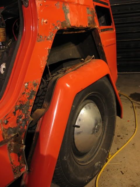

I discovered a lot of rust and expanding foam as I started to dig in under the PO's attempt at rebuilding the rockers:

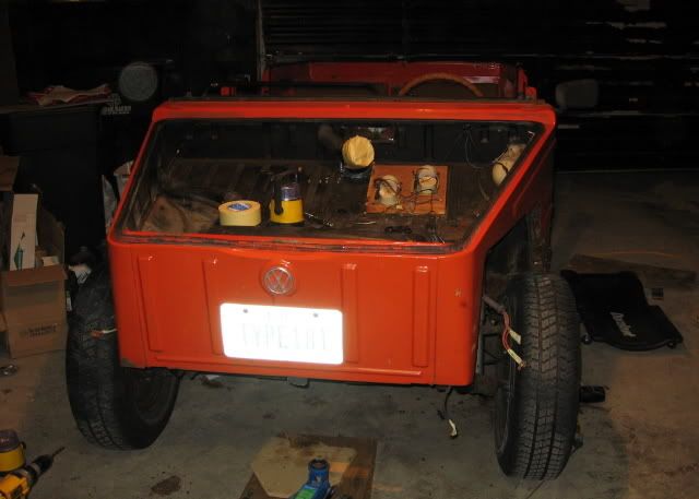

Here it is after taking off the windshield, hood, rollbars, and top:

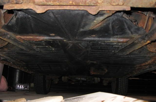

The pans are mostly solid, but for some weak areas along the outside edges:

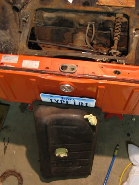

Took the gas tank out:

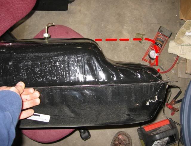

Here's the replacement 1961-1967-style tank I will be using. I'm flirting with the idea of expanding the tank as shown, to hold a couple more gallons:

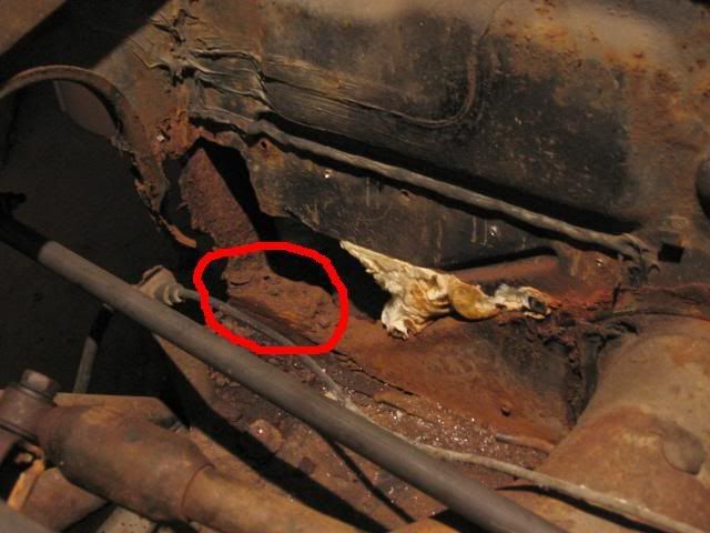

More rust. Note where a body-to-pan attachment point used to be...

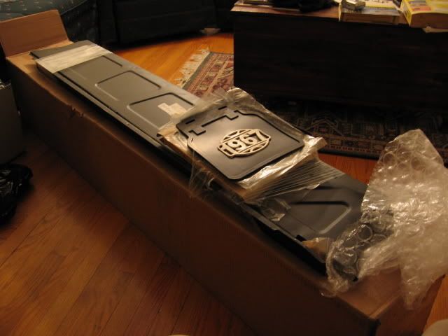

I haven't been able to do much lately, but some neato parts came in! 8)
Once my credit card cools off a little, I'll put in an order for outer skins, possibly NOS parts this time. Althought the Danish ones ain't too bad!

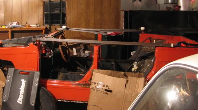

I've gotten some leftover bed rails from my folks, which I'll use as reinforcements to keep the pillars from moving relative to each other when I remove the body from the pan. I'll still need some more angle iron to do it right, but you get the idea:

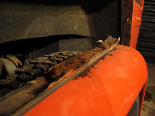

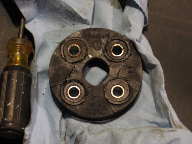

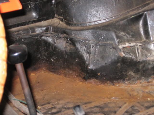

Didn't do much today. ("Today" meaning the tail end of yesterday, if that makes any sense.) I disconnected the engine wiring, and drained the brake fluid from the front circuit. I spent an hour removing one of the rear fenders. God, that sucked -- the body panels behind it were really crusty, so when I got the fender loose from the body, some of the body metal had come with it! Yep, this cancer patient will need a bunch of cosmetic surgery to prevent certain psychological damage! :lol:
Closeup:
And here's why we inspect/replace steering couplers every so often:
- Scott

Scott(Towel),,,,I don't know if you are looking for replacement sections, but I might have a front "firewall" section that would help you out with rust repair. That pic showing the complete lack of metal in front of the passengers feet is CRAZY! Us CA guys really don't know rust!!!

It's crazy. Much evil has been lurking underneath the riveted patch panels:

Post by Kubelmann »
I recently found the same thing behind my back seat on the edges and in the corner of the outside rear of one of the rocker panels. Once I started digging i found a number of old riveted repair. Found the same thing all over m both my pan halves once i started to dig and grind. I ended up with two new pan halves. Turned out perfect. Once you start digging you uncover some weird stuff on these old cars.
