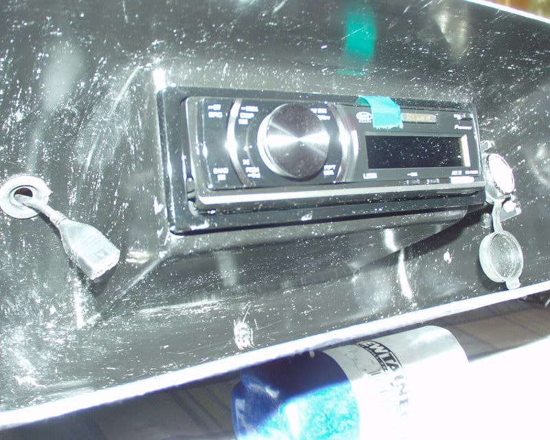

I had one of the figerglass gloveboxes sitting in my closet for 5 years and just got around to this project...
Ipod adapter plugs right into the USB on the left side...no wiring necessary.
The hump for the head unit wasn't quite wide enough, so besides having to cut the hole for the mounting collar I had to thin the walls to either side of the deck just so that it fit between them...didn't hit daylight, but it was kinda' scary.
Wiring is a breeze...two power wires (one hot all the time to keep the clock from losing time, the other to operate on - simplest way is to give them both constant power from the same source - requiring you manually turn the deck on/off) for the deck and a ground...and a +/- to each speaker.
As for up front I've got the (not so) cheap plastic kick panels...that's next weekend. You can also purchase these in fiberglass. Typically mounted with four screws each...creating ~3/16" holes (easily filled-in to return to stock)

Here is how I ended up supporting the glovebox:
http://img.photobucket.com/albums/v212/ ... 100097.jpg
