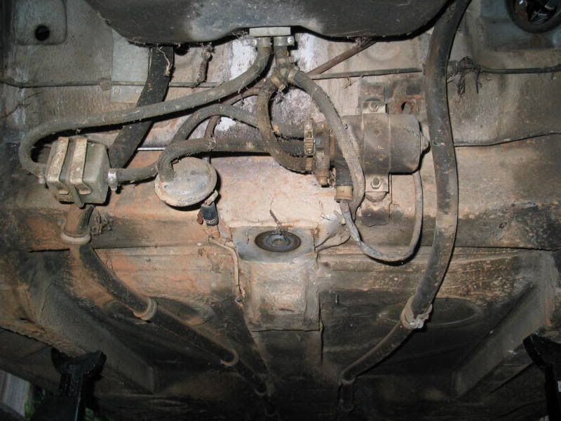

What are these pipes under Bill K's car?
wshawn
Posts: 209
Joined: Thu Dec 27, 2007 6:36 am
Post by wshawn »
What are the thick pipes under here that run down either side of the car for?
Single 60
Posts: 60
Joined: Fri Mar 15, 2002 12:01 am
Pipes under Bill's car
Post by Single 60 »
I believe they are for air conditioning lines going from compressor on engine to front of auto.

raygreenwood
Posts: 11910
Post by raygreenwood »
Yup!..and its time to change some of those fuel lines. It looks like the ones to the "Y" have the original crimp type clamps. Do not trash the AC if its still there. It worked well enough that its worth saving. Ray
