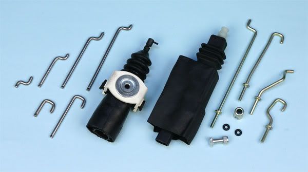

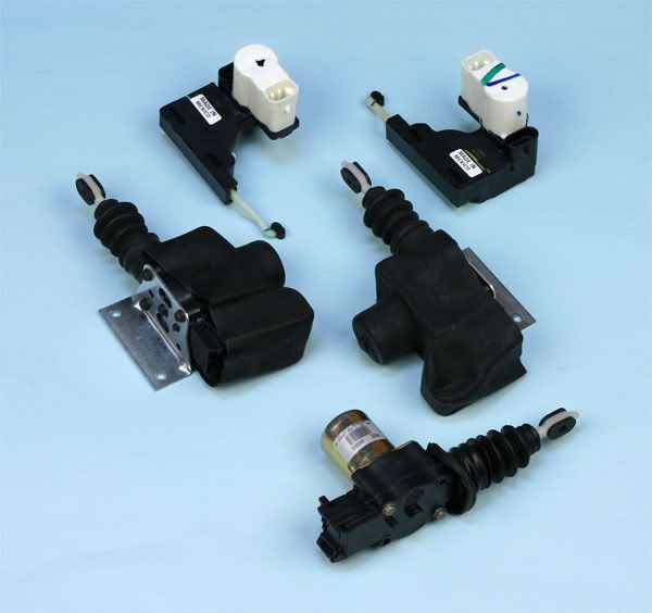

A couple of door lock actuators should do the trick. They usually have one bolt holding them in place. And they only move a inch or so. 90ish fords would be a good choice plenty in the bone yards.
Or Chebbies
http://www.a1electric.com/actuators.htm
Or Chebbies
