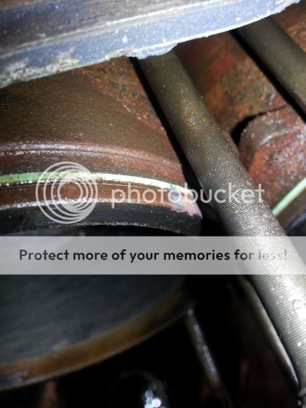

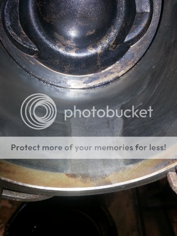

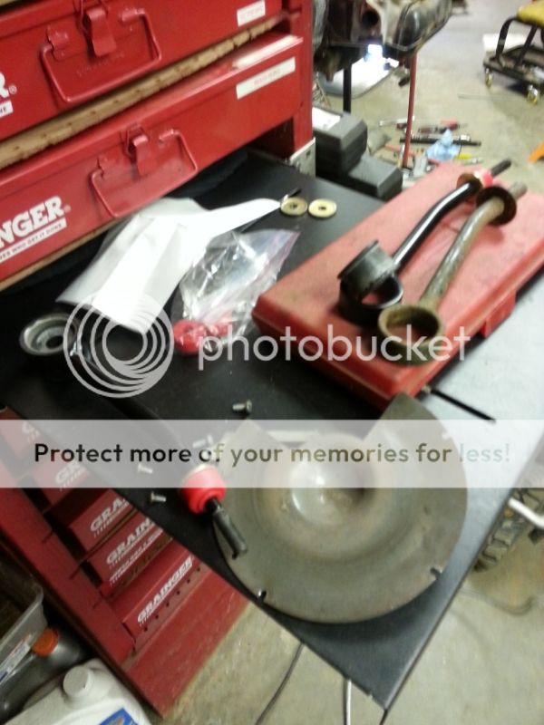

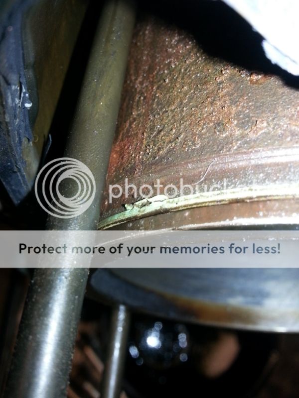

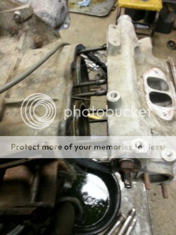

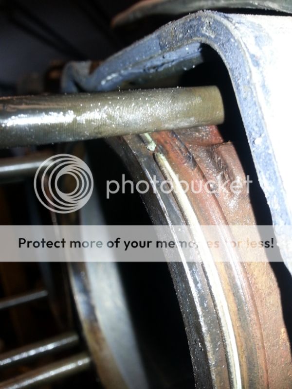

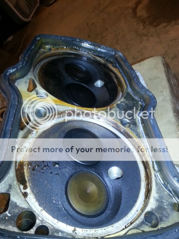

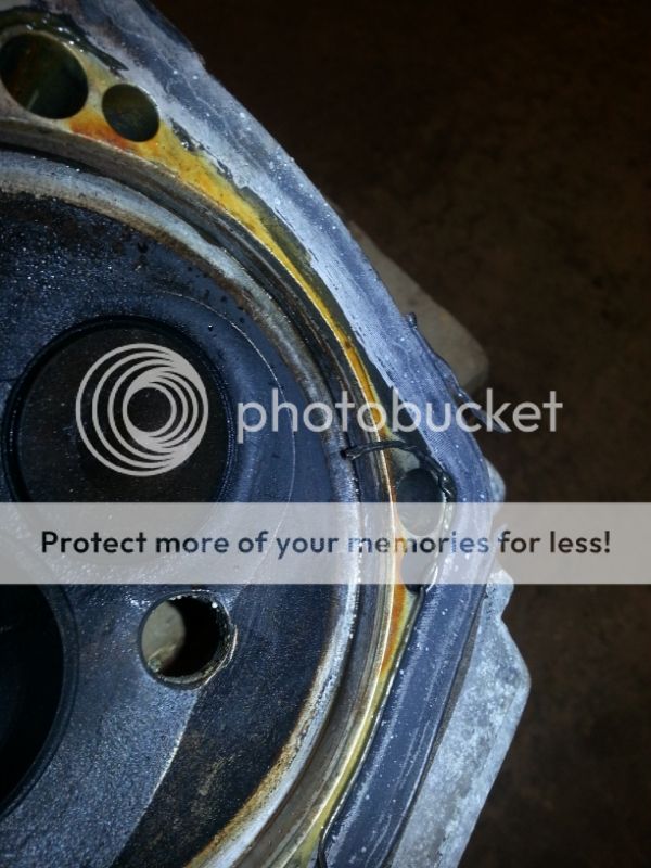

Well Last Monday I decided it was time to investigate the engine with Issues and see if another attempt at assembly was worth making. After finding a rusty plug I had a feeling the 1-2 side was the head to pull and try to find the issue. well after pulling the intake runner, power steering bracket, valve cover, rocker set, and pulling the push rods it was time to unbolt the head. well it turns out the right stuff really glues the head on and really gums up the head bolts.
That head did not want to come off:
First impressions:
Starting to look at the green o-rings where I suspected the issue was:
This looked like it might be an issue though it did not seem big enough to be the primary issue:
Then I noticed this on the other cylinder not happy but should not have been an issue:
THIS looks like the root of the problem the O-ring is completely severed:
Here are the o-rings from each cylinder notice one is broken:
Evidence in the head that this was where the leak was:
as I was cleaning things up I went to put the cylinders at mid throw and noticed something strange with the bottom of the cylinder:
well I have all the gaskets I need and a spare cylinder to replace the bad one, unfortunately my spare ring set got rusty so I had to throw them away so I am gong to reuse the rings on the piston in the new cylinder. I cleaned up the head so after putting the piston in the new cylinder and putting them both back in the case it will be time to put the head back on, hopefully successfully this time.
First impressions:

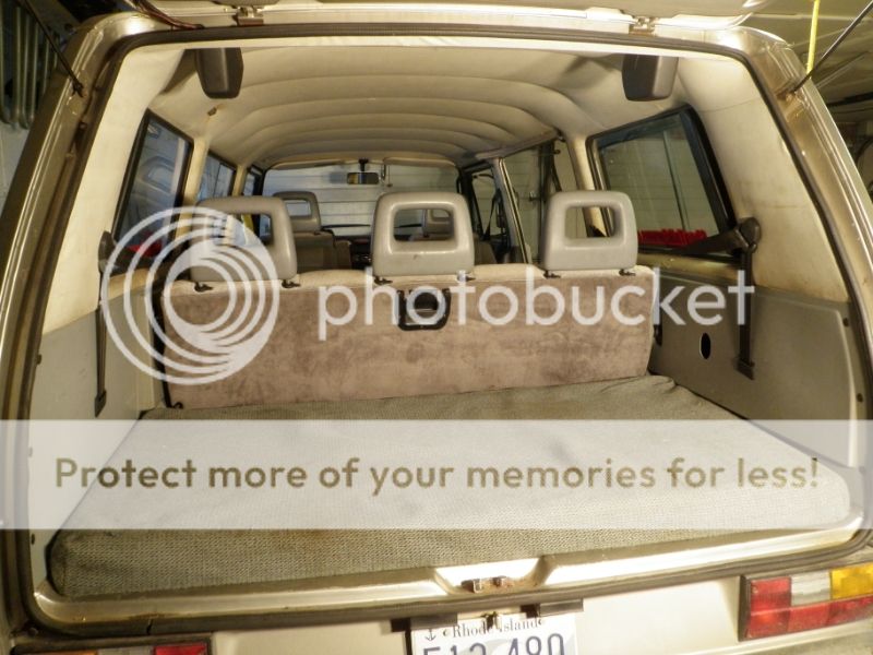

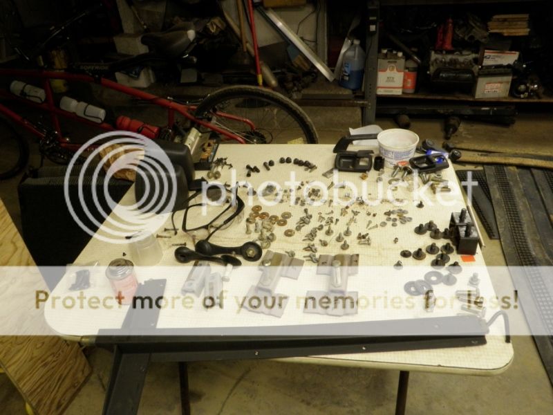

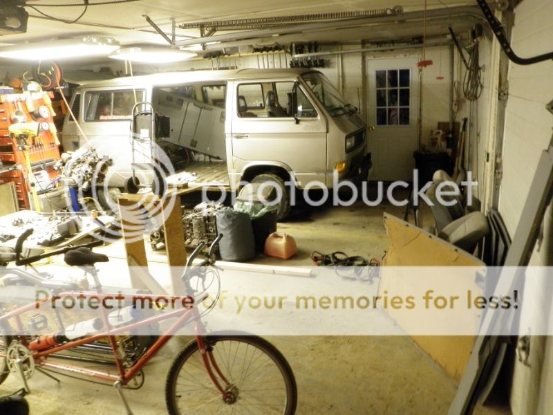

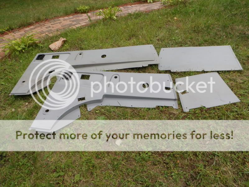

Well had a productive weekend working on the Syncro my parents needed the basement cleaned up a bit and that meant my Carat interior needed to be installed in the van to get it out of the basement. I first stripped out the interior luckily not finding any rust I didn't know about (aka the passengers side) and worked on installing the bracketry for the table.
here is a shot of all the small hardware for installing the interior luckily there is a lot of extra hardware that I had gathered for the other Syncro and just some spare bits. notice I have 4 of the extra brackets to space out the back pins one pair for reference and one pair to install.
as it turned out my first positioning of the top bracket up inside the wall I had positioned too low and the table did not move slowely so it all had to come out (minus the seat as I hadn't installed it yet) to get things to line up and work. after moving that one piece it all went together fine and works nicely.
I used the earlier speakers up above as most carats had AC with the speakers in the AC ducting and I don't have AC and the Speakers were in the panels by the elbow of the back seat. I was lucky to find these panels for a van without AC even thought they were not very nice they cleaned up OK and I was able to add the holes for the rear belts using the AC panelset for reference
After getting the interior swapped I had to fix some exhaust leaks there was a crack in the input pipe to the muffler and the pipes didn't line up nicely so I got them installed but after a few heat cycles things seemed to have straightened out and the bolts came loose some new bolts and gaskets and things were sounding better.
now that the van was all back together and looking nice with its new interior I had to pull it apart to move some furniture for my parents to get them recovered. I ended up pulling the mattress pad both jump seats and the passengers seat to fit it all in but I ended up getting a chair, a love seat, 2 couches plus all the cushions for all of them into one load in one van.

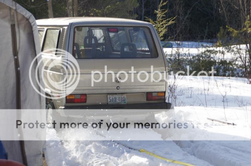

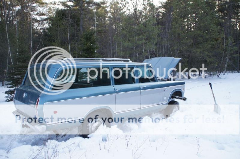

Re: Getting the syncro back on the road
Here is where the Vanagon made it to trying to take pictures before I had to get out and walk as well as where the pulling began
Throwing some snow
Syncro's can throw snow with all tires
Where the Travelall managed to make it to
The swath after getting it free to shallow snow
The Travelall in shallow snow
Throwing some snow
