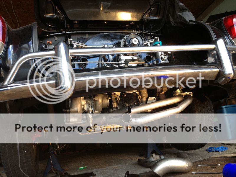

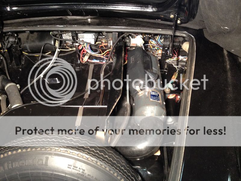

Ok here is some progress,
I have been working on two things :
Gas heater install, its a late BN2 and it works very well ...Check out my rats nest :)
Turbo header
I am stuck for now, waiting for some tight 2.5" bends to come in for the outlet pipe, then I can start to figure out the primaries for the left side of the engine. I will also need to make a fancy custom heater box for that side.
The oil drain is too low and will be moved up 1/2", I think I will have to make a 1/4" aluminum skid plate to protect it.
It is a mashup of a t4 header and a t1 header
