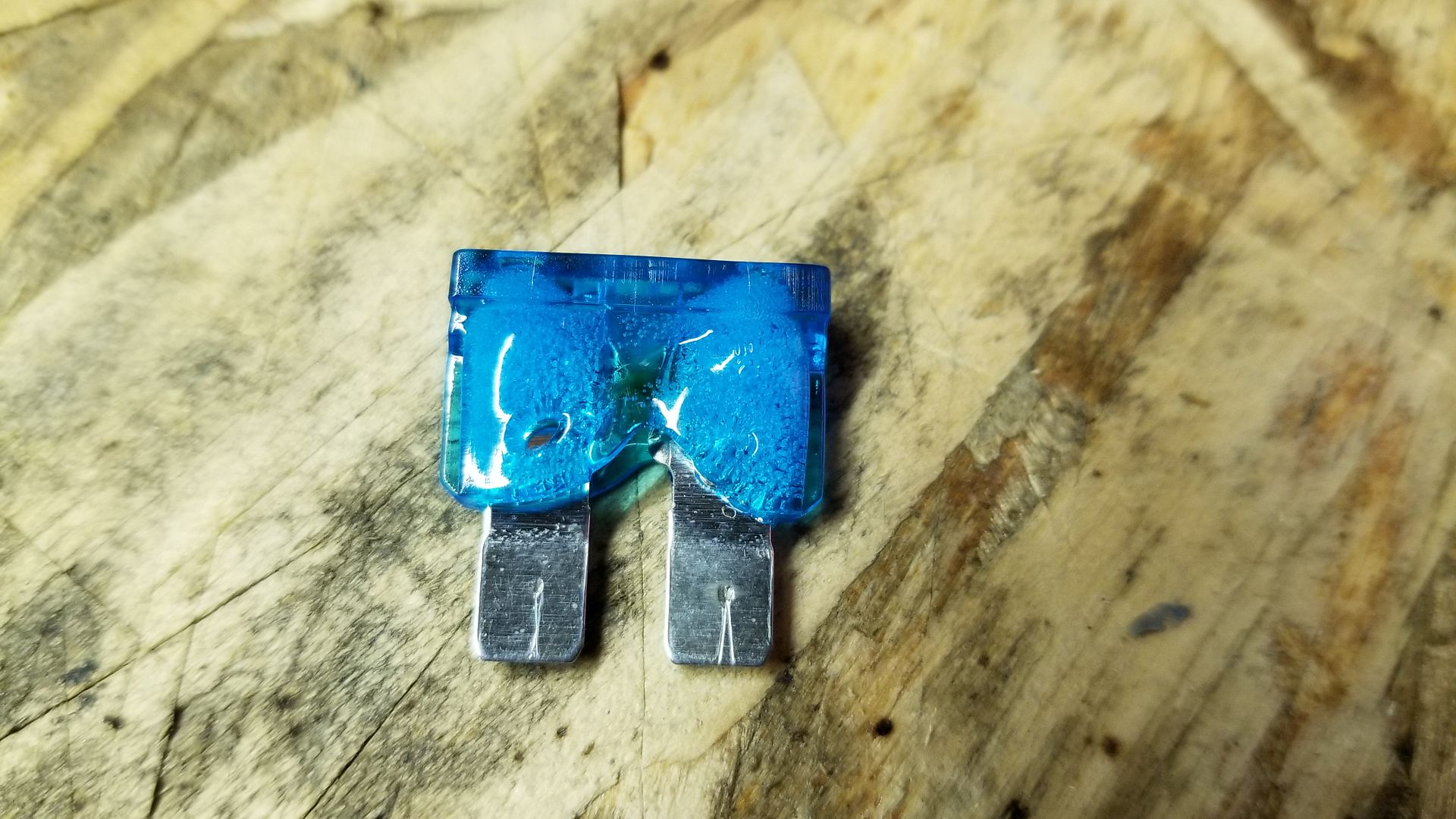

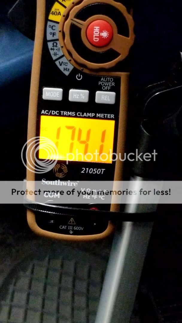

Little update to start off the holiday weekend. A while back I noticed my dash blower motor fuse #13 was looking a little crispy, so it got my curiosity going. This is a 15 amp fuse where my '89 should have a 20 amp fuse here. I decided to test the current load on this circuit. Using an amp clamp, I found with the blower on high, over 17 amps is pulling through that fuse, depending on mode door positions (restrictions to air flow) the blower would draw as little as 12 amps on high speed. So, no I run a 20 amp fuse and try to avoid using the high speed setting

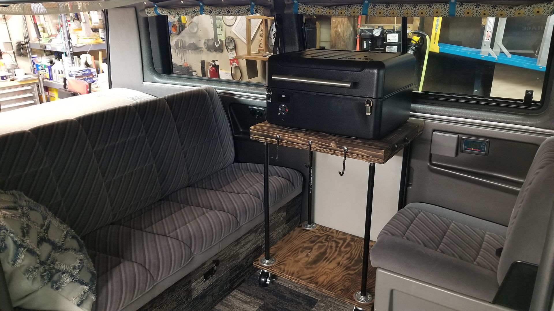

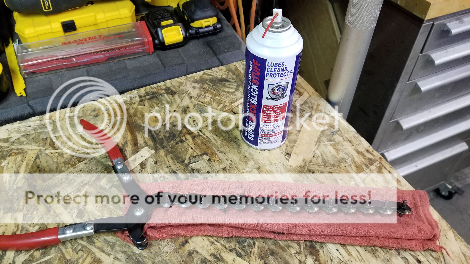

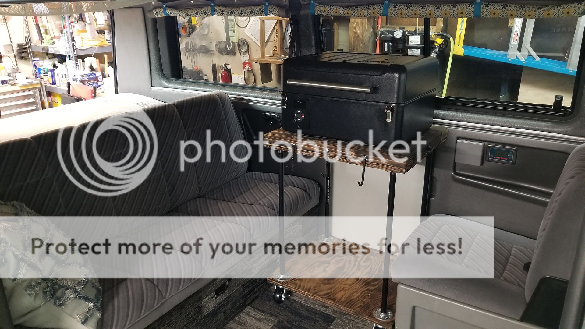

We picked up a little Traeger Scout and I built a small table with caster wheels for the it. Turns out it fits PERFECTLY in the Van and should work great powered with our small 500 watt inverter. Tried to use it once this Summer but were foiled by a local burn ban where we were camping

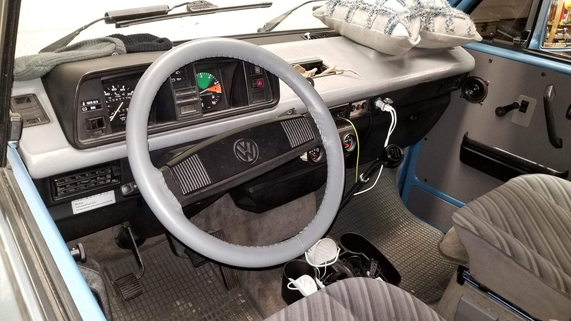

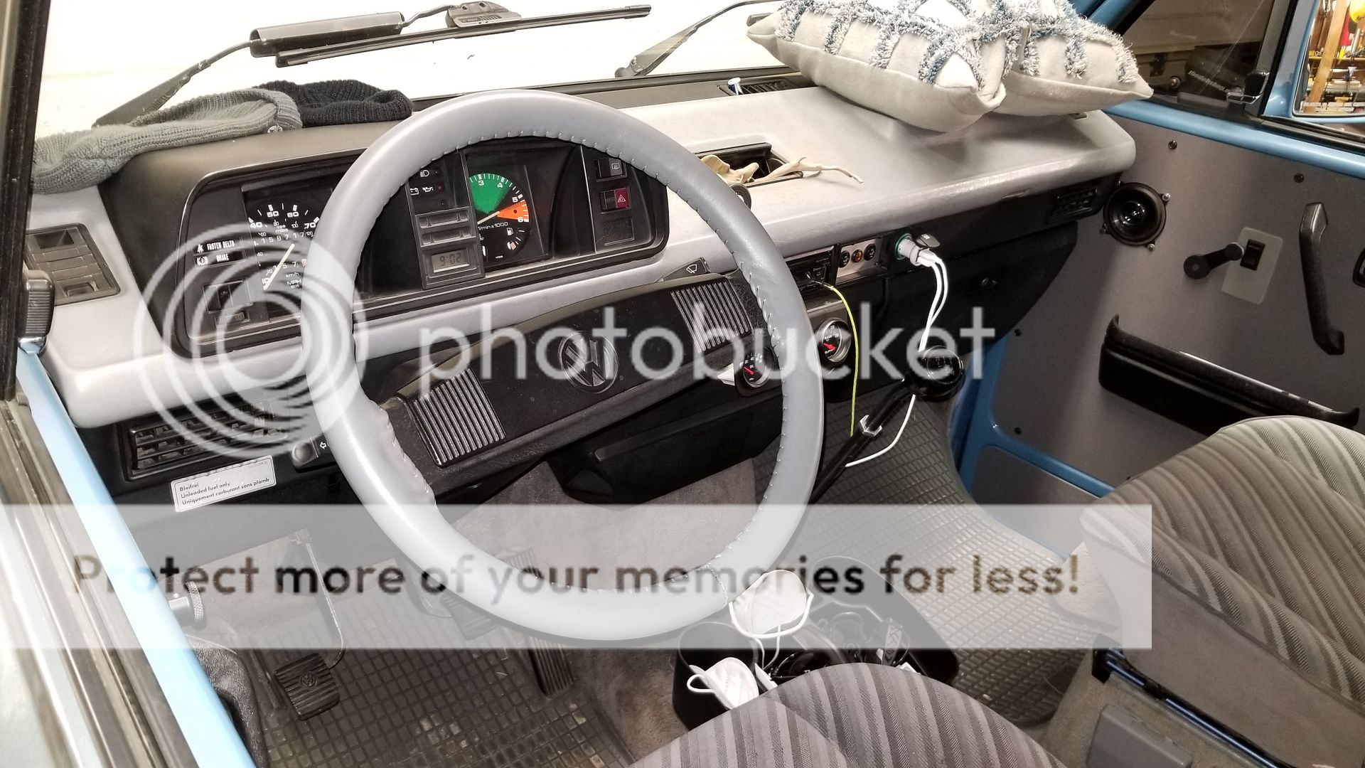

I finally put the Wheel Skins wrap on our stock steering wheel, sorta matches the grey "bluestar" interior theme, and of course adds 10 horsepower.

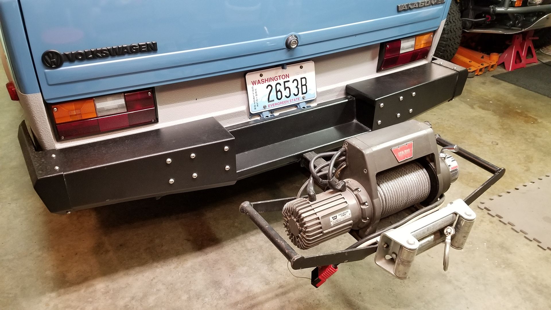

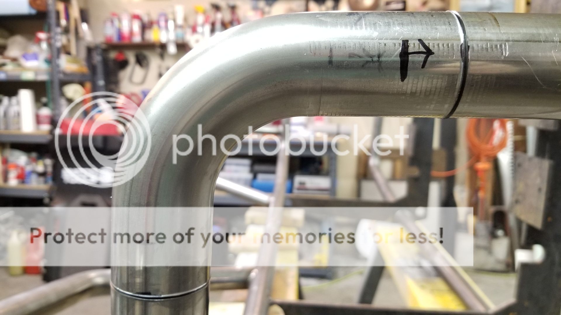

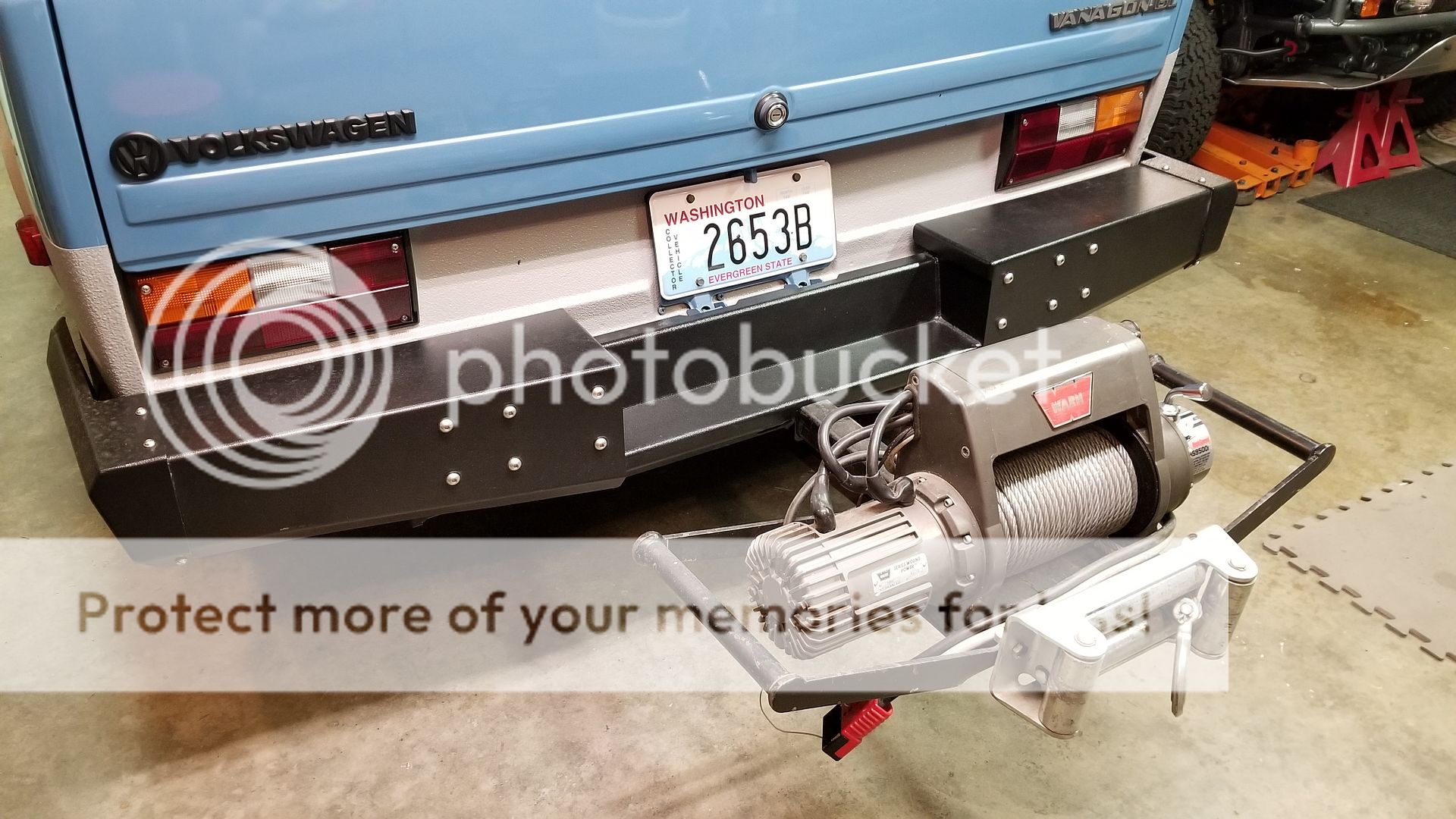

A few years ago, I posted some pictures of a bumper I was going to try and mount on the Van. It's basically a Syncro 16 nock off design. The local shop I used to work for had a run of these built with a "small" design flaw. I knew it would take some work to fix this correctly, but I had an idea how to do it. Basically the upper cross bar assembly needed to move forward and down about 7/8" to sit in the saddle on the two from ribs. If I cut each corner out with 7/8" length difference, they can be flipped and it should drop the bar right down where it needs to be. I went to work with a couple squares and my eyeballs and put the chain cutter to use. It was close, but the small differences from side to side on the whole bumper structure needed work too. I'm currently in the process of clearancing a few key areas to make this fit over my fiberglass bumper ( was designed to fit the thin metal or no bumper Vans).
I managed to get my hands on a 20 year old, used twice, Warn 9500I winch, just in case...

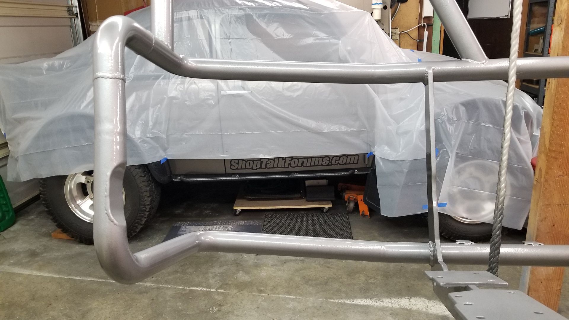

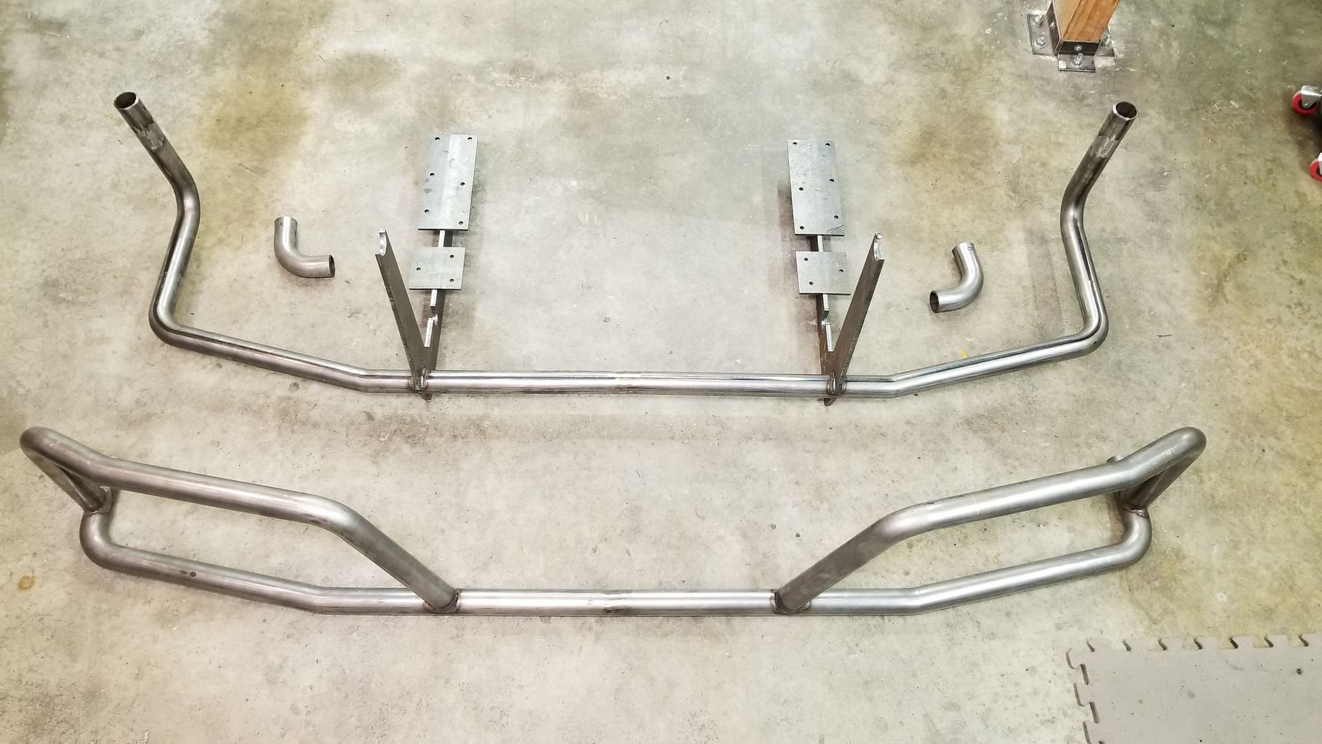

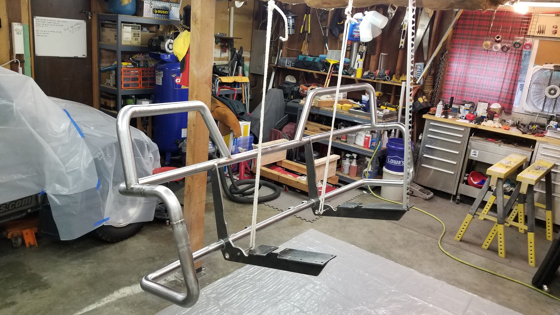

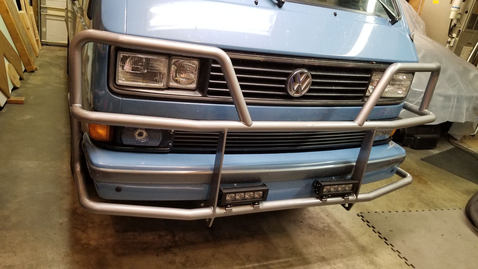

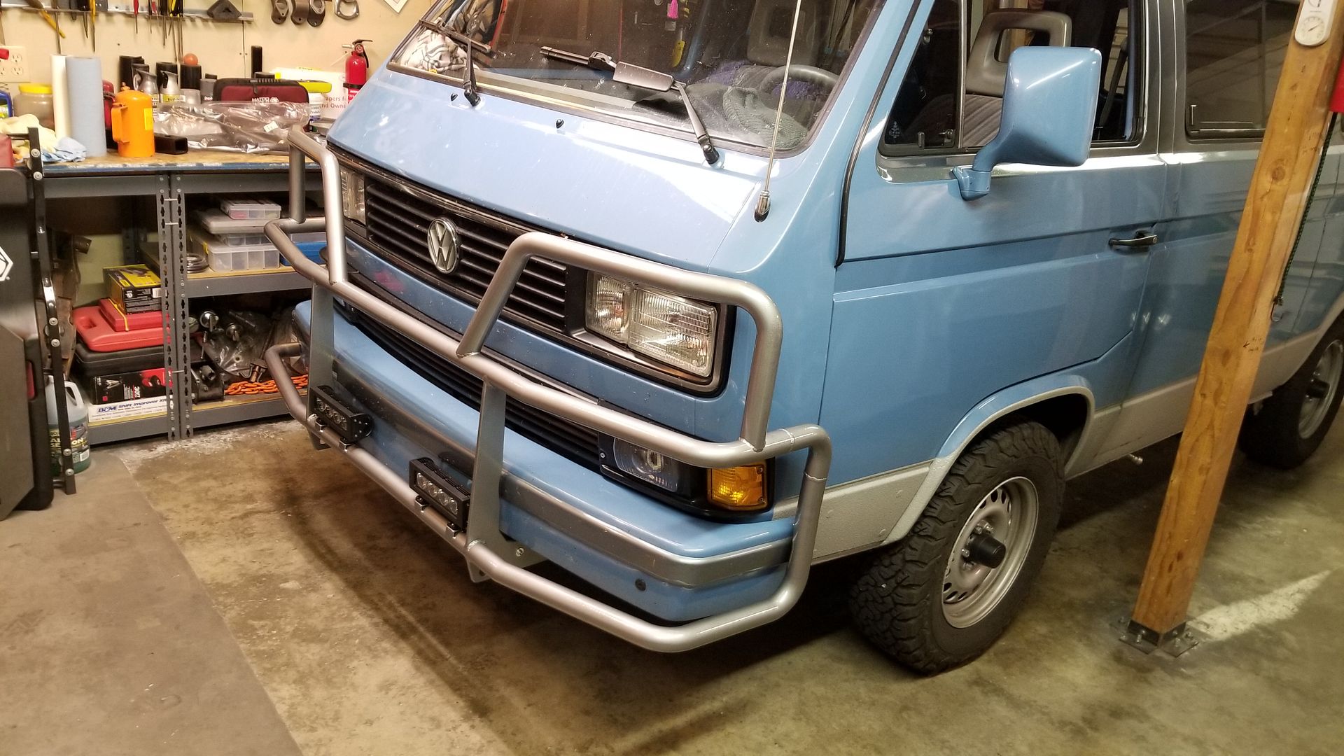

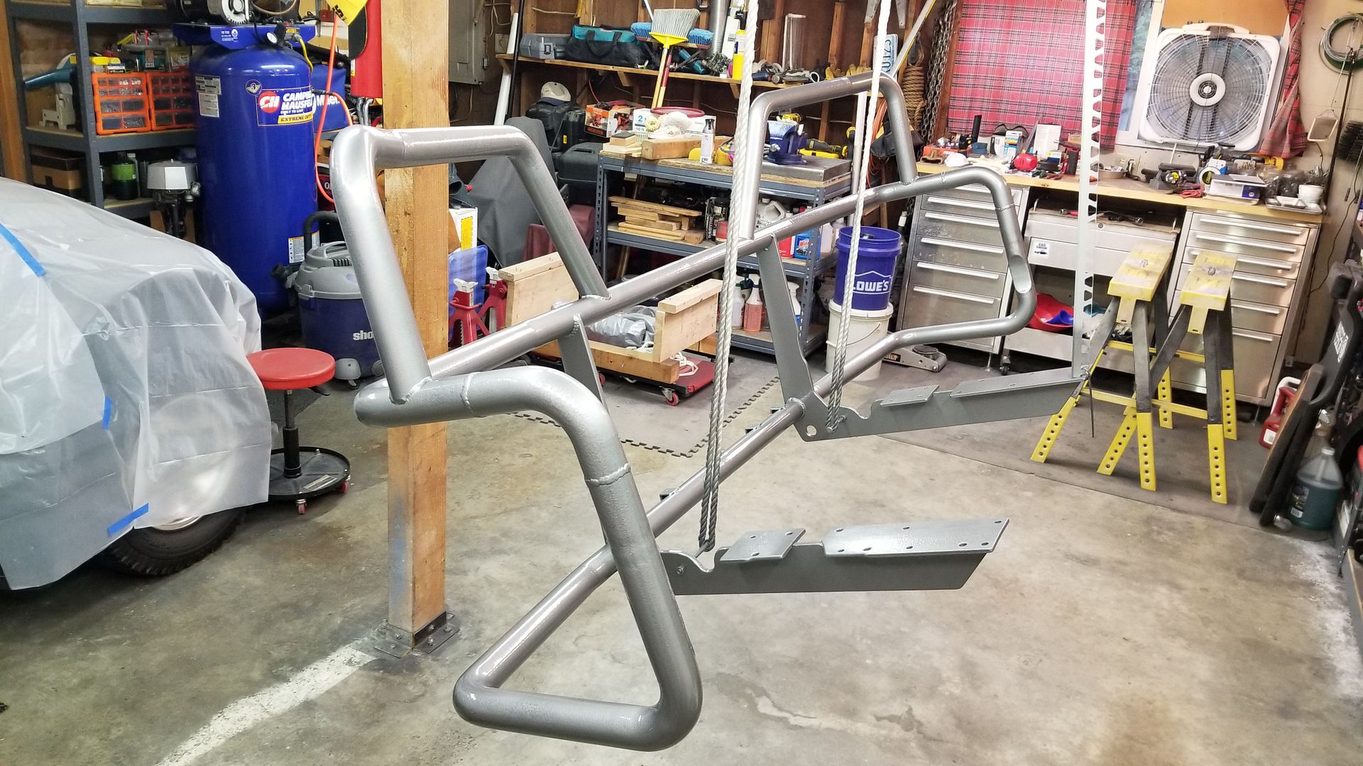

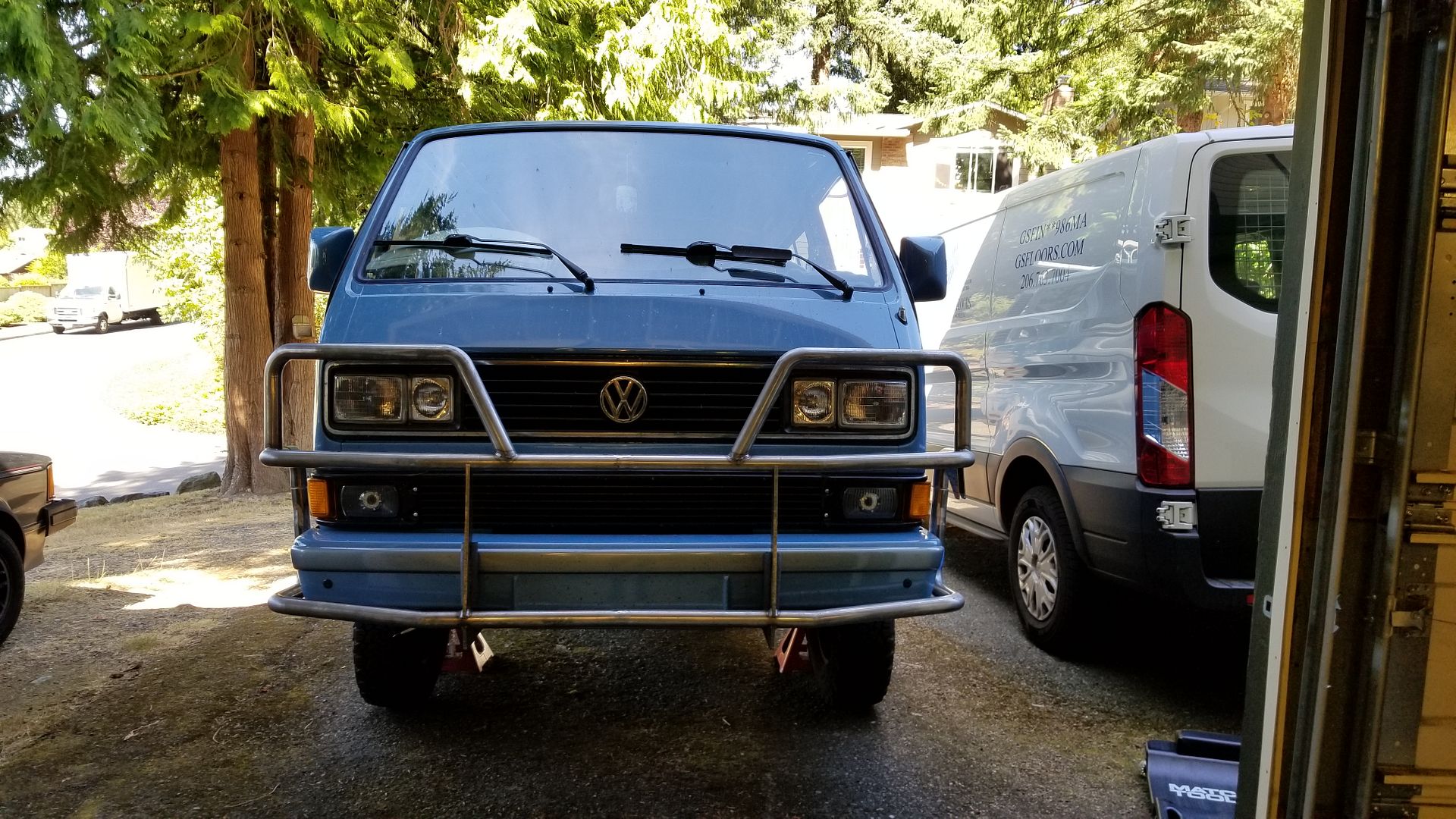

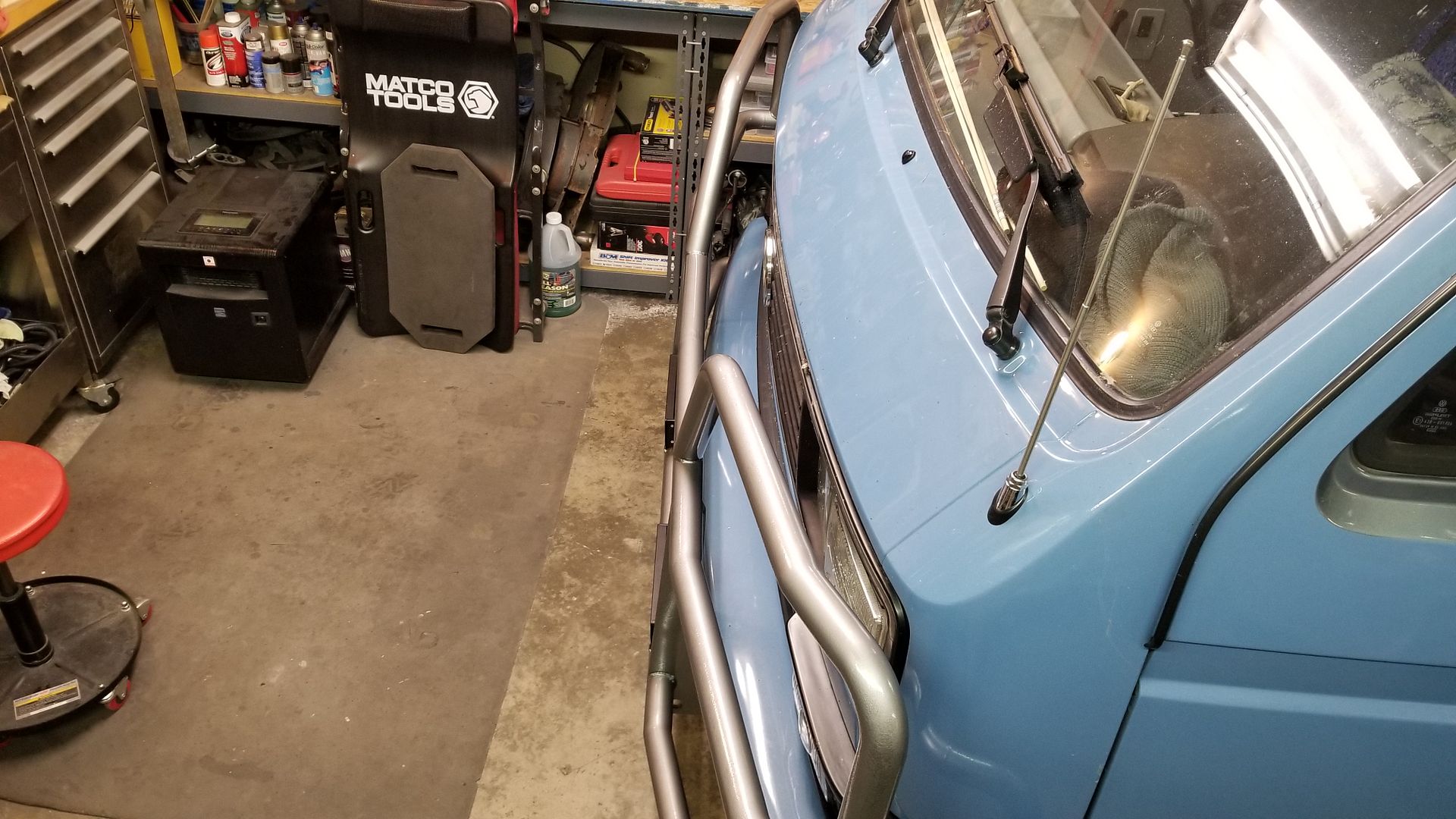

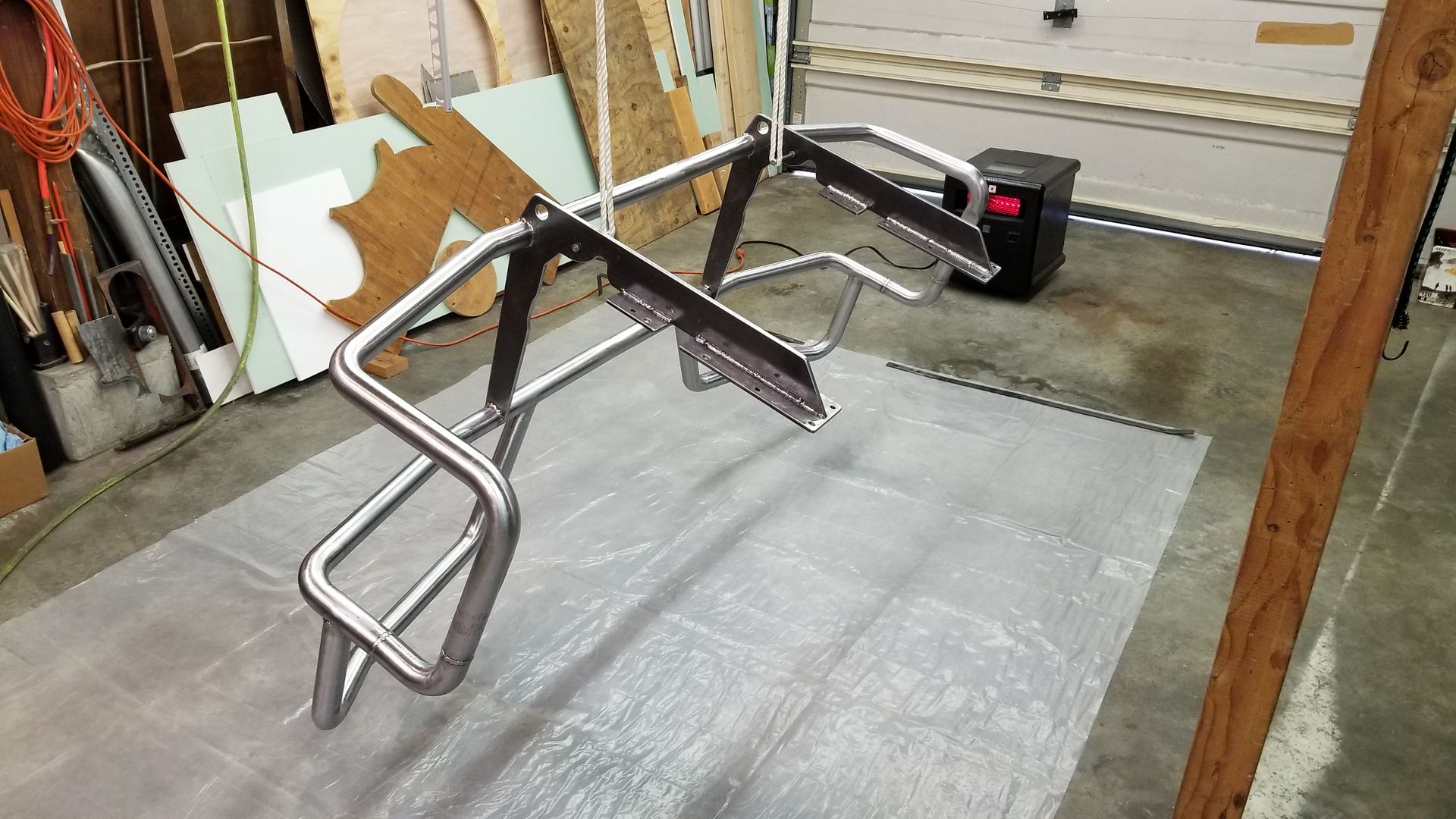

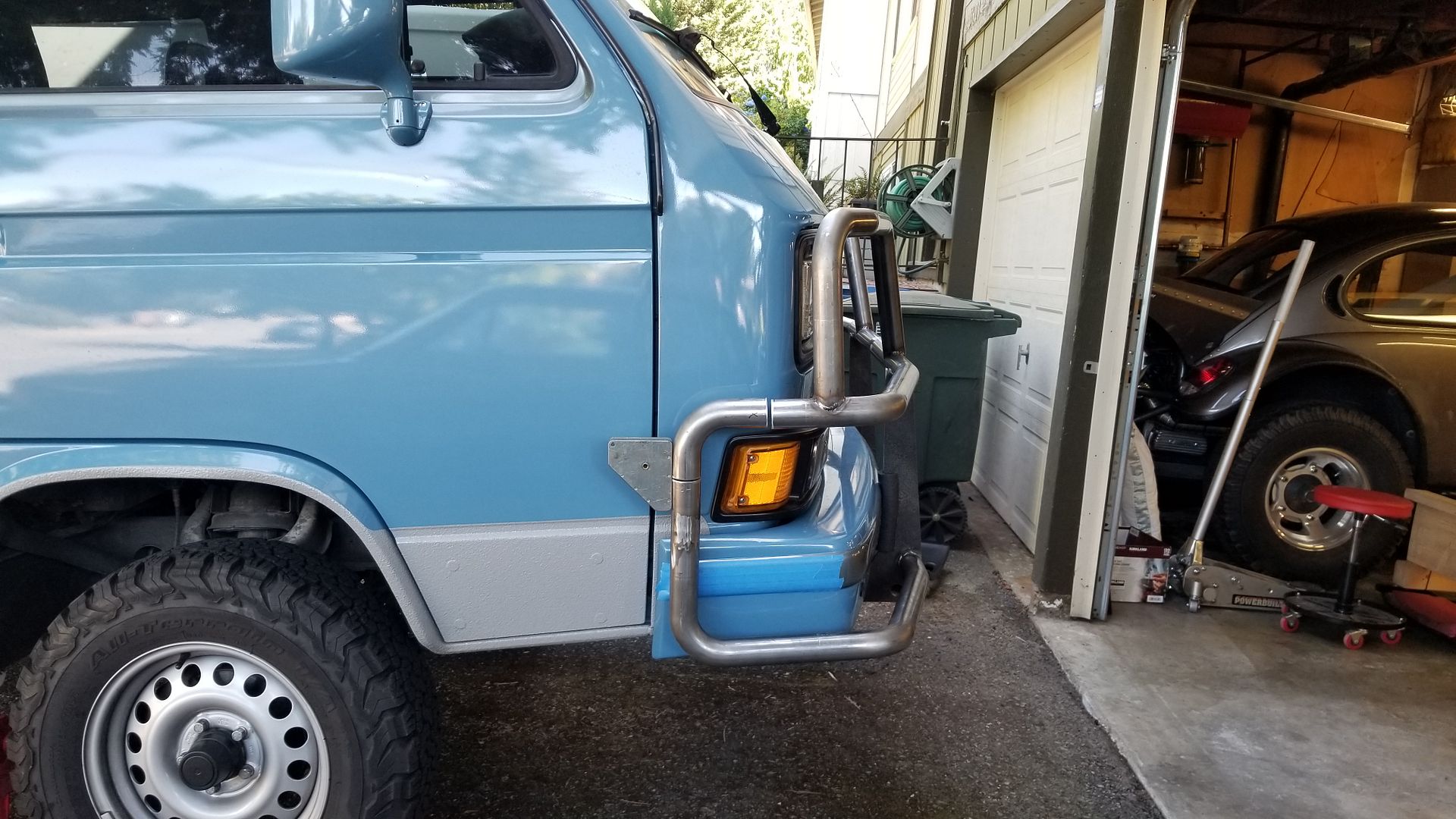

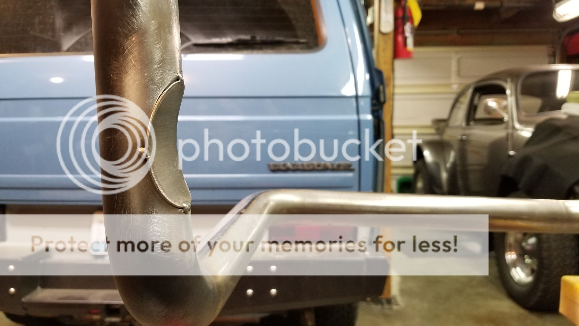

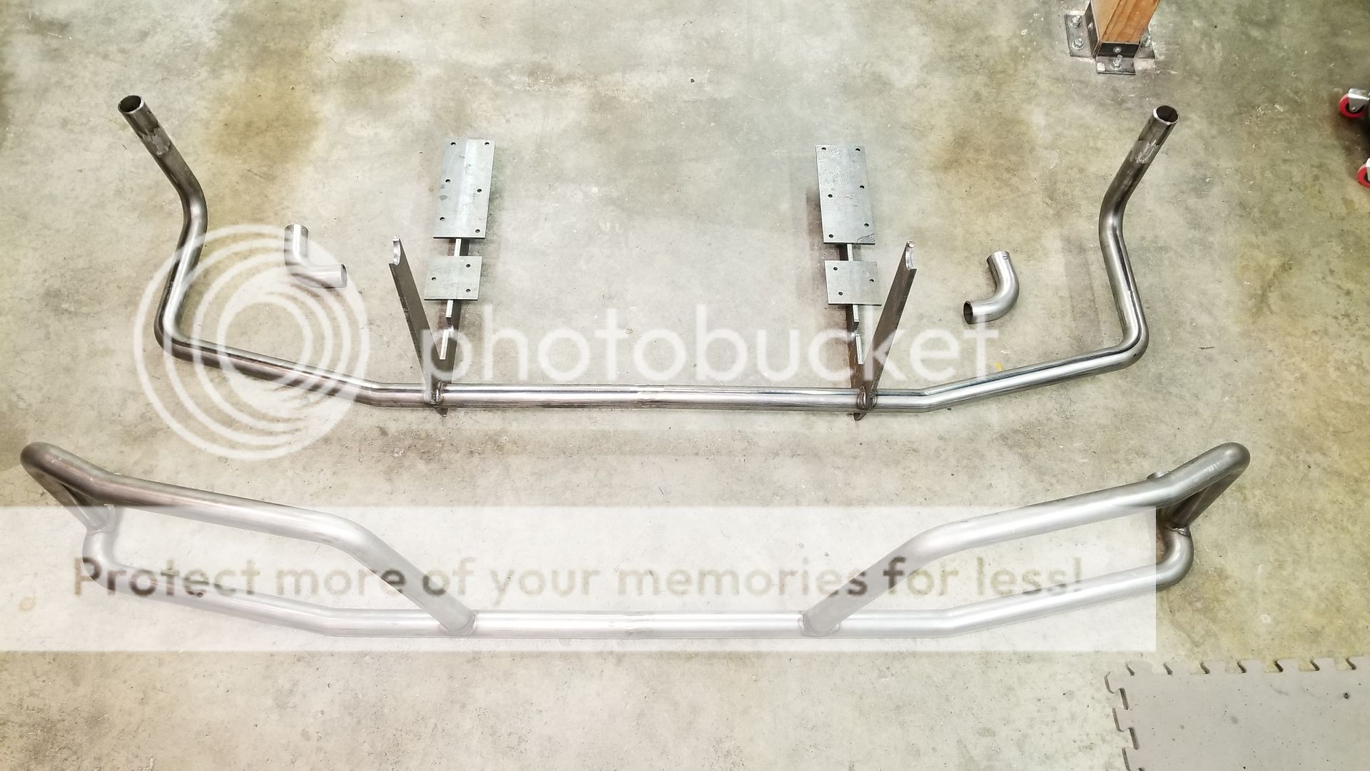

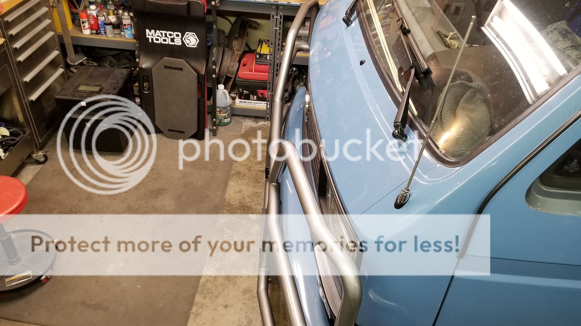

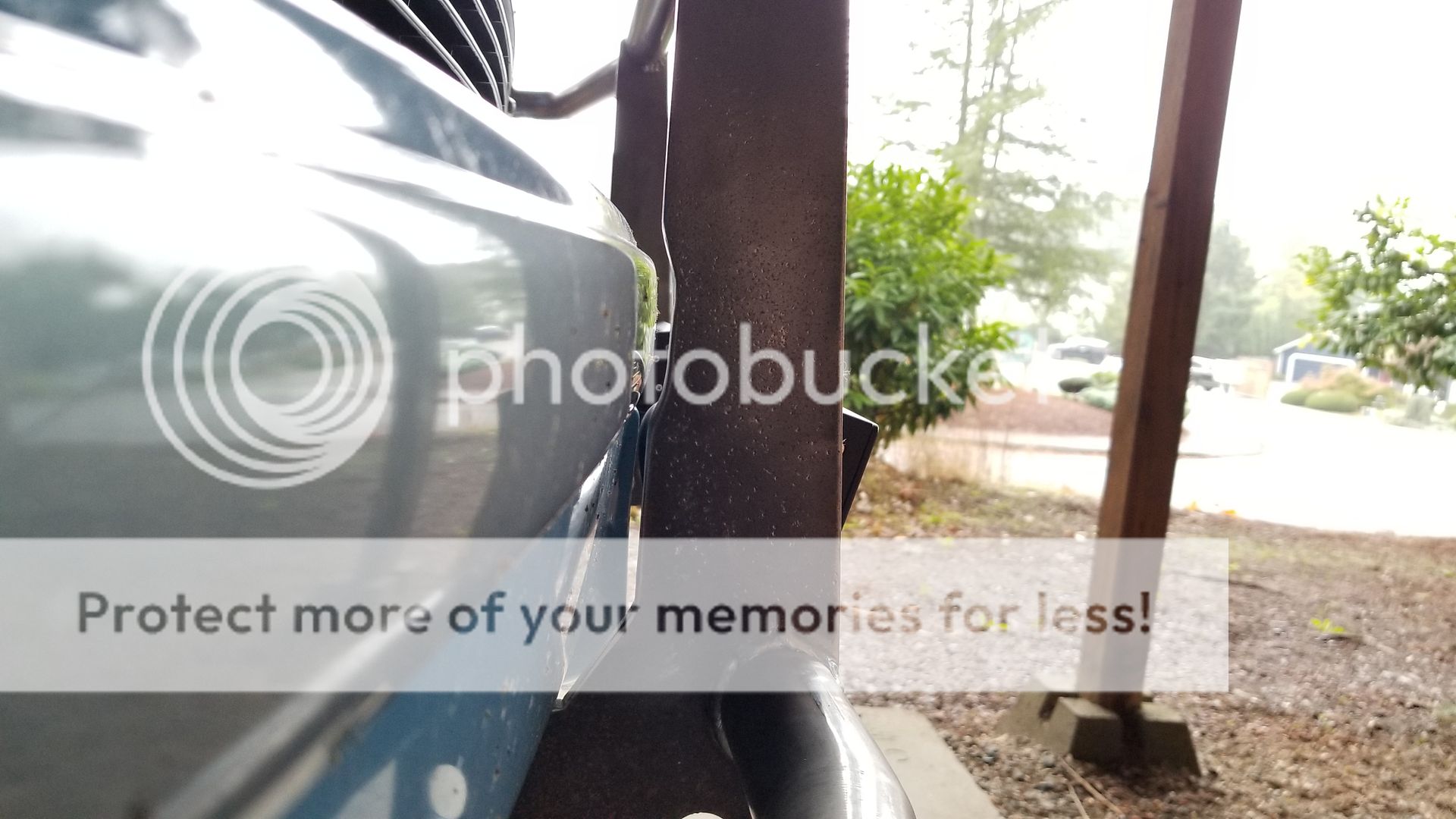

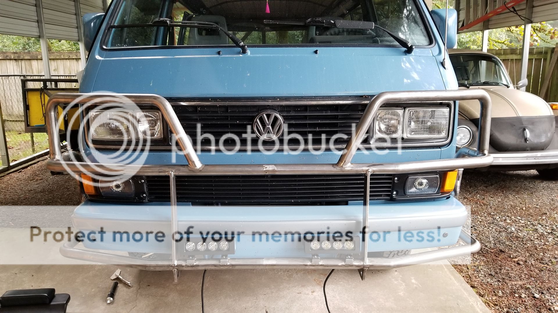

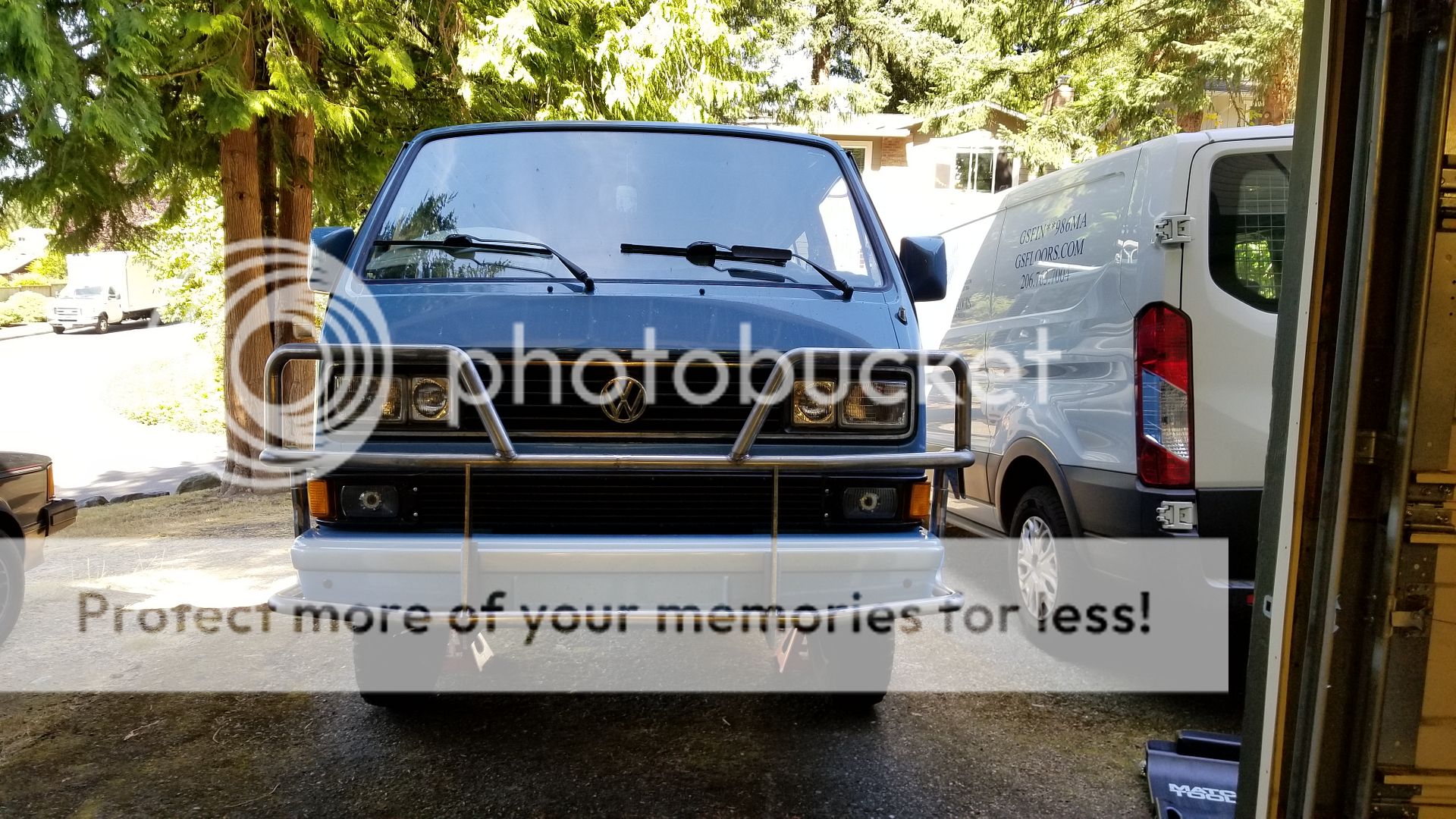

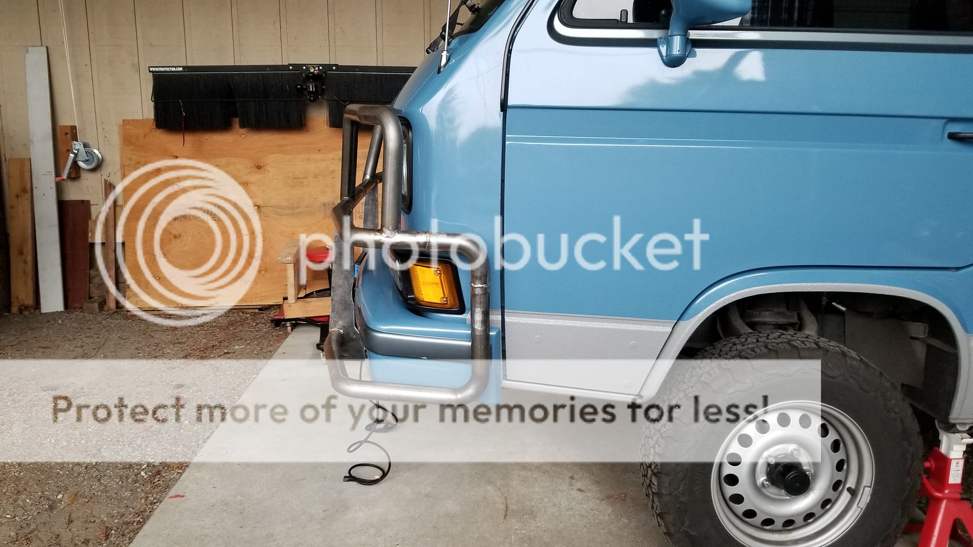

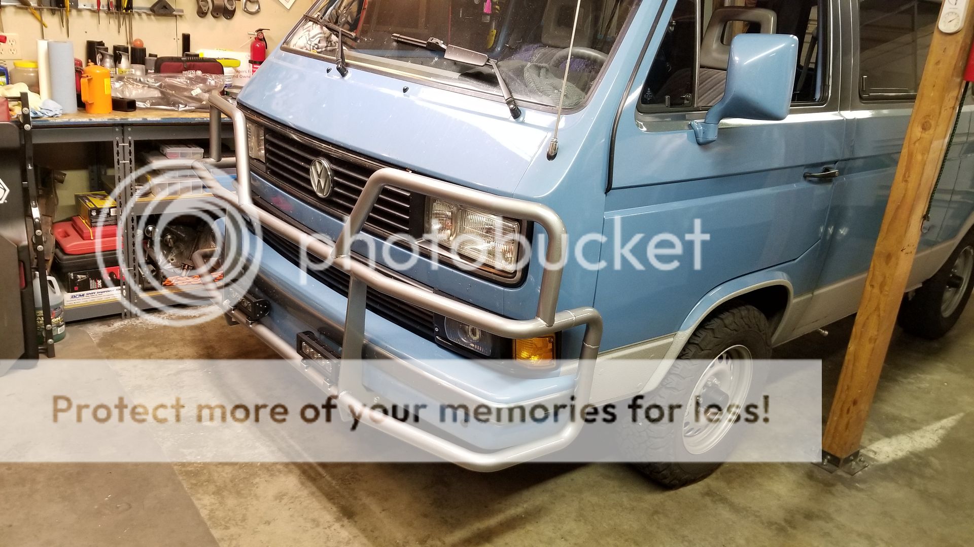

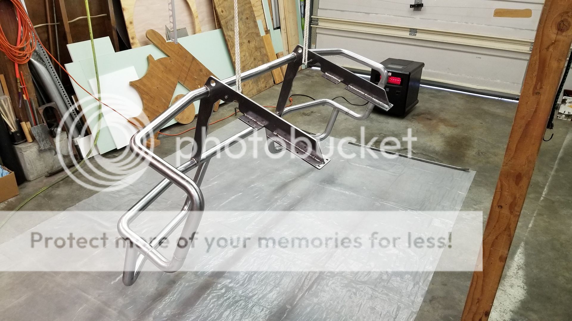

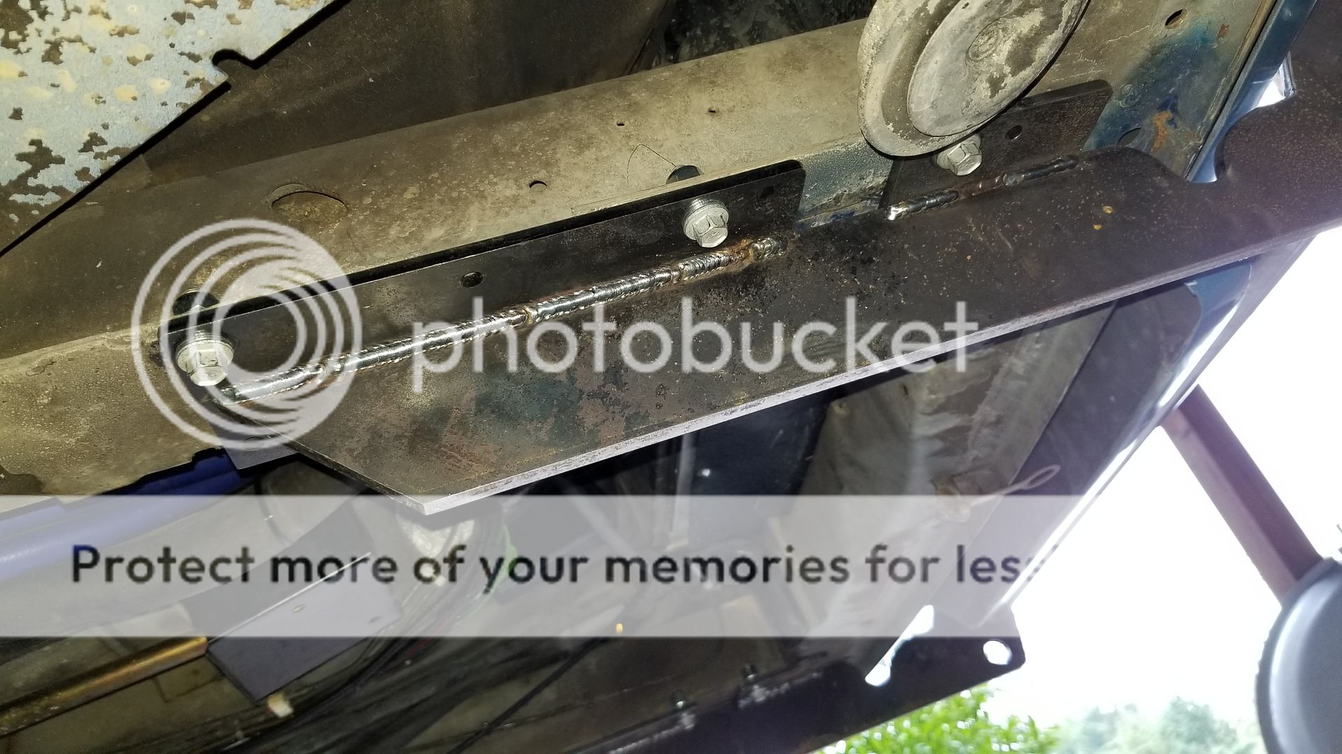

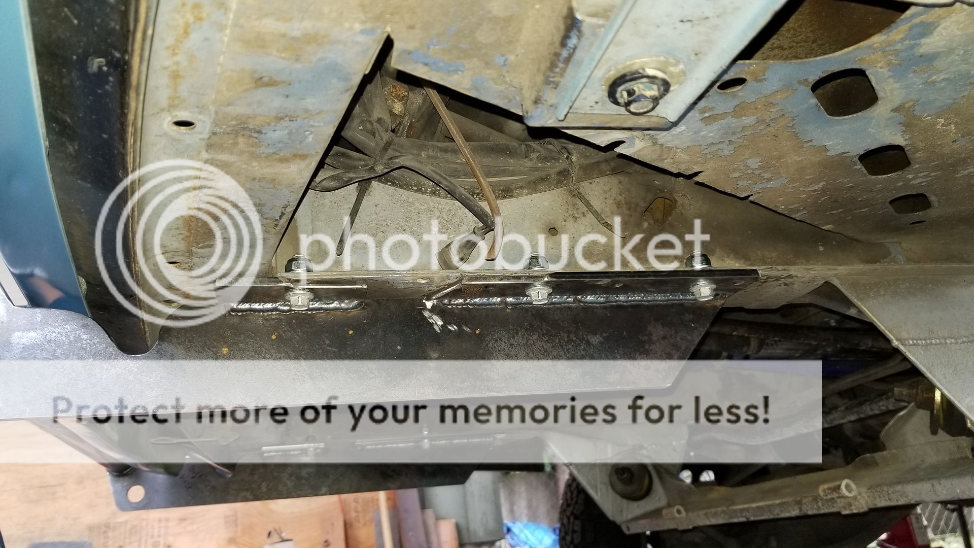

Finally got this bumper done and mounted, took about 3 times as many weekends as I'd hoped, but it's done. I had to test fit this thing dozens of times, so it made sense to build a dolly so I could get the Van up on jacks and just slide this thing into position, then lift about 1" to the mounting surface. The problem was that each side of the bumper wraps around and fits snug against the fiberglass bumper. It ripped the "protective tape" I put down multiple times, and ended up scratching the paint up pretty bad. So, now that the bumper has it's own roll cage, the paint is already jacked up pretty good

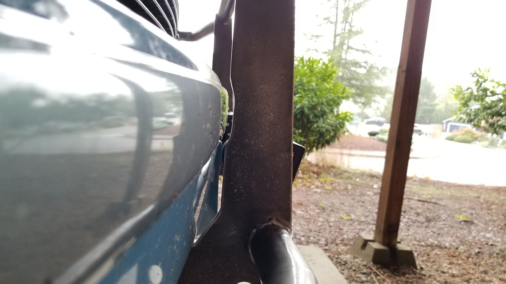

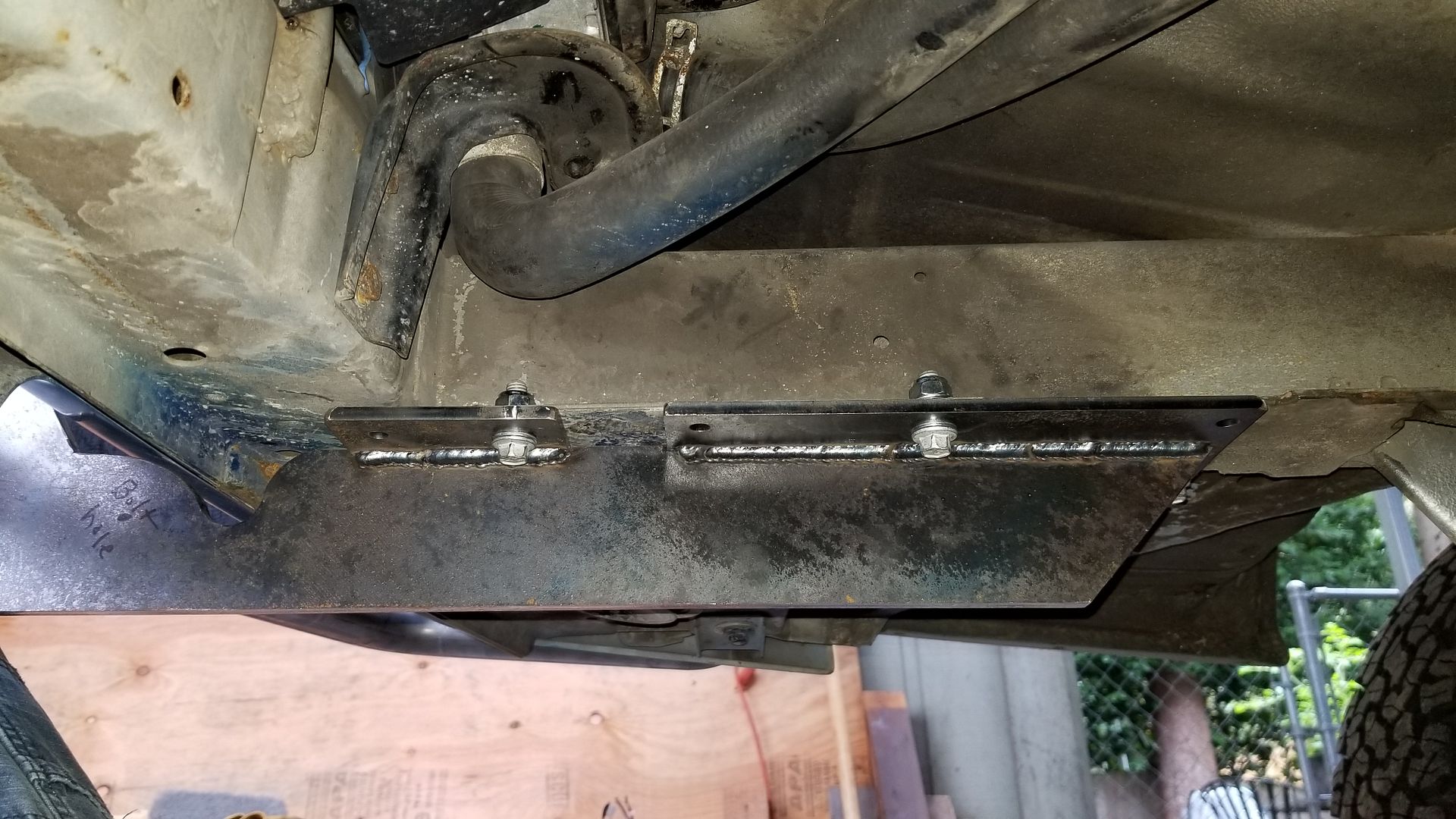

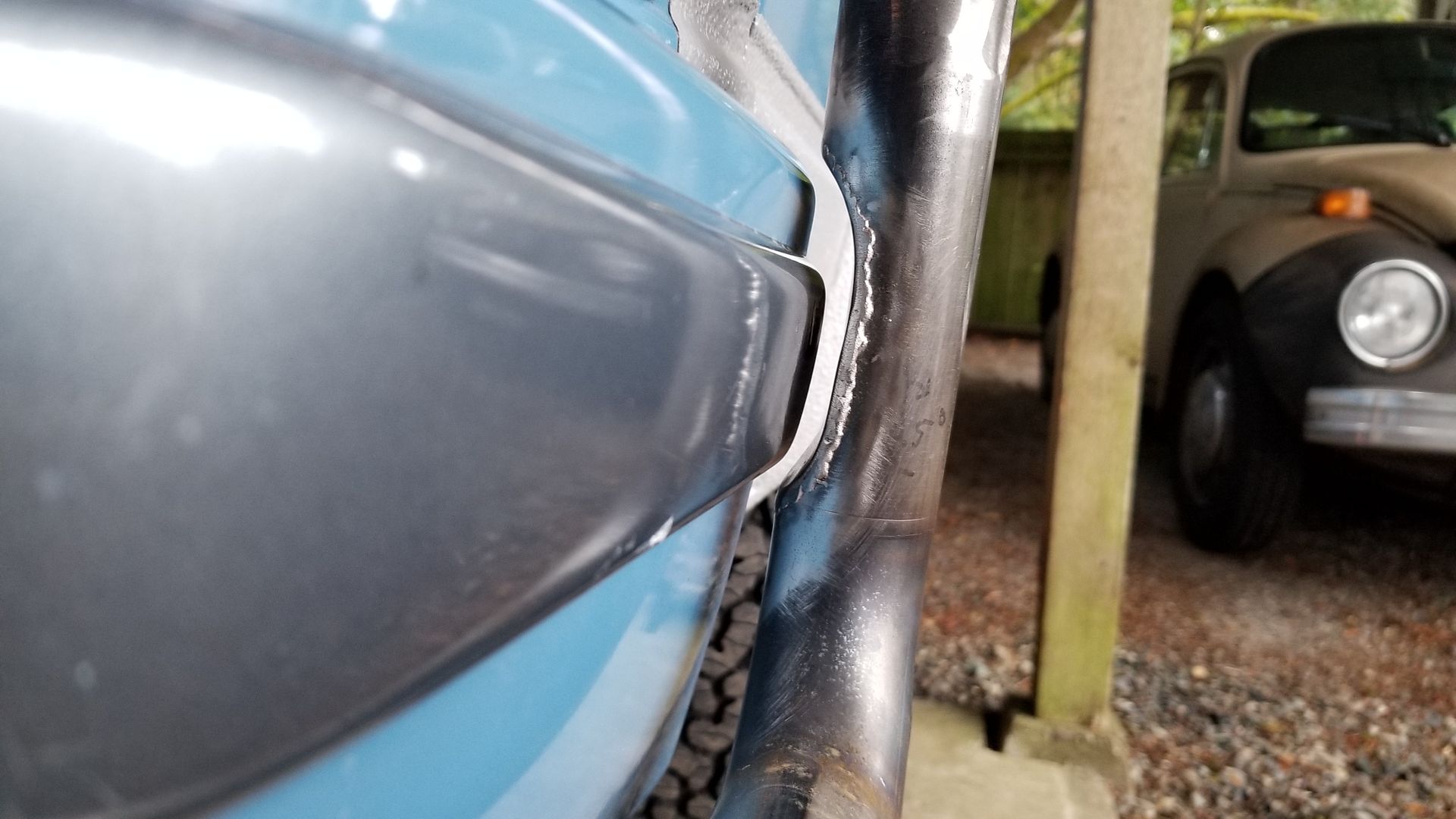

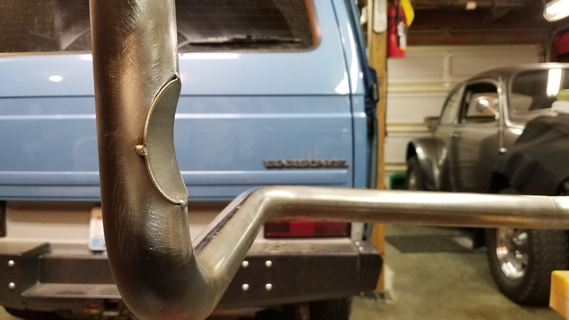

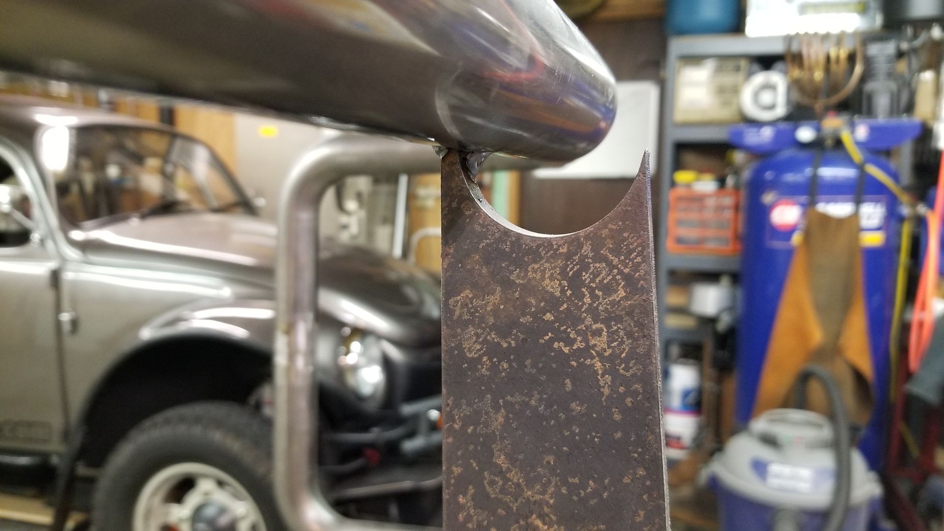

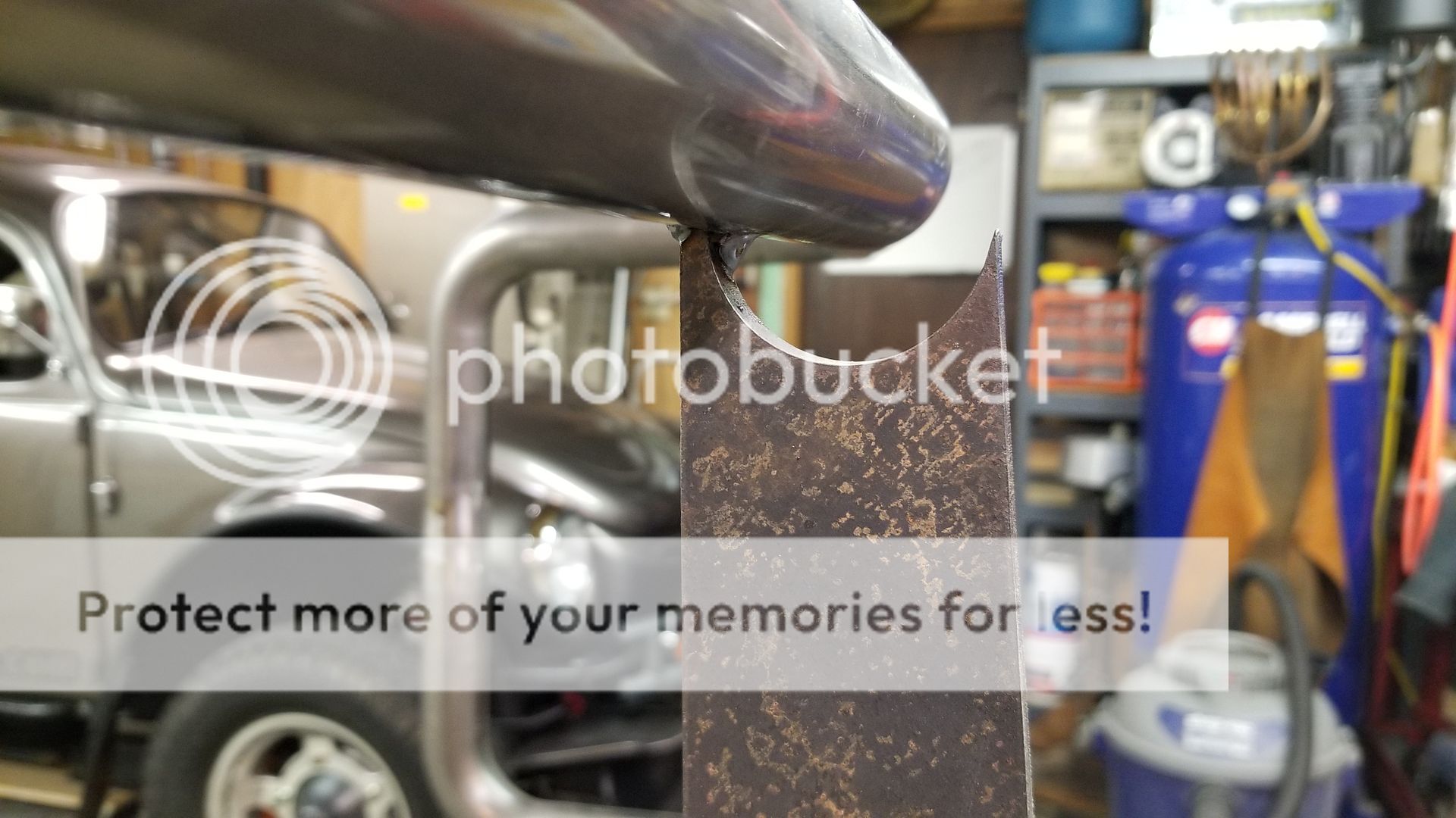

. I thought all I needed was a little clearance, so I used some 5" stainless exhaust and cut a couple biscuits out to make these.

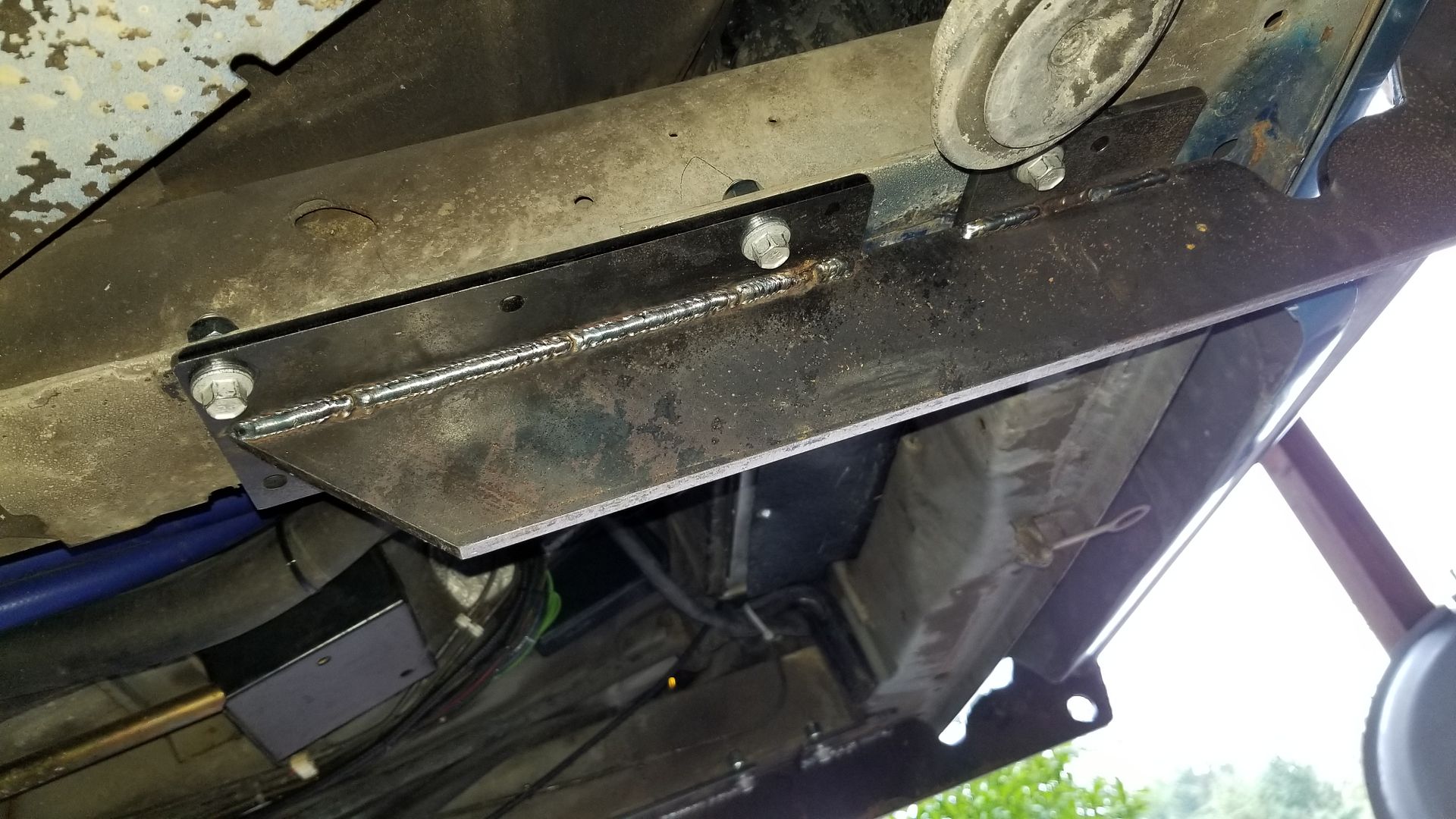

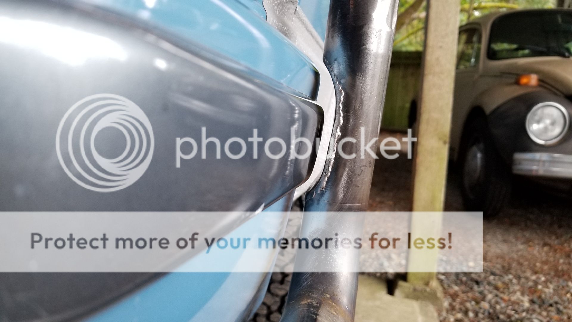

After some more paint damage test fitting, I realized I needed more space. Also, the exhaust was pretty thin wall stuff. So, I found some decent scrap plate steel and made these.

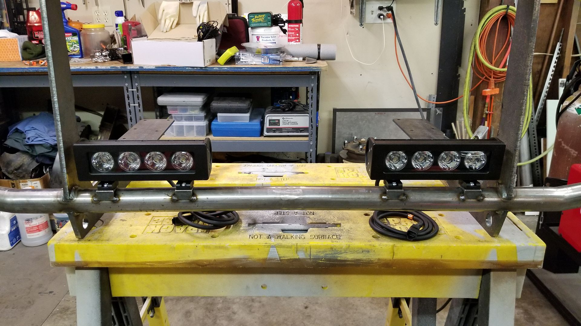

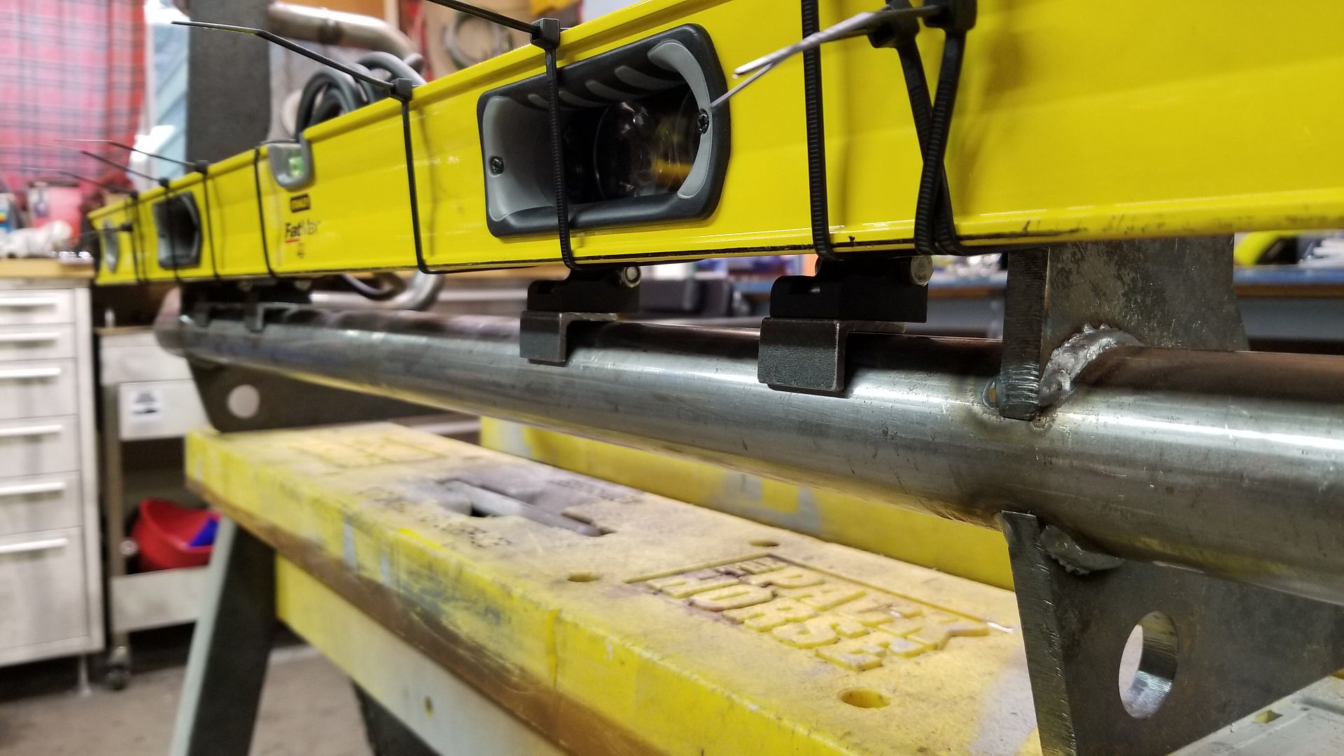

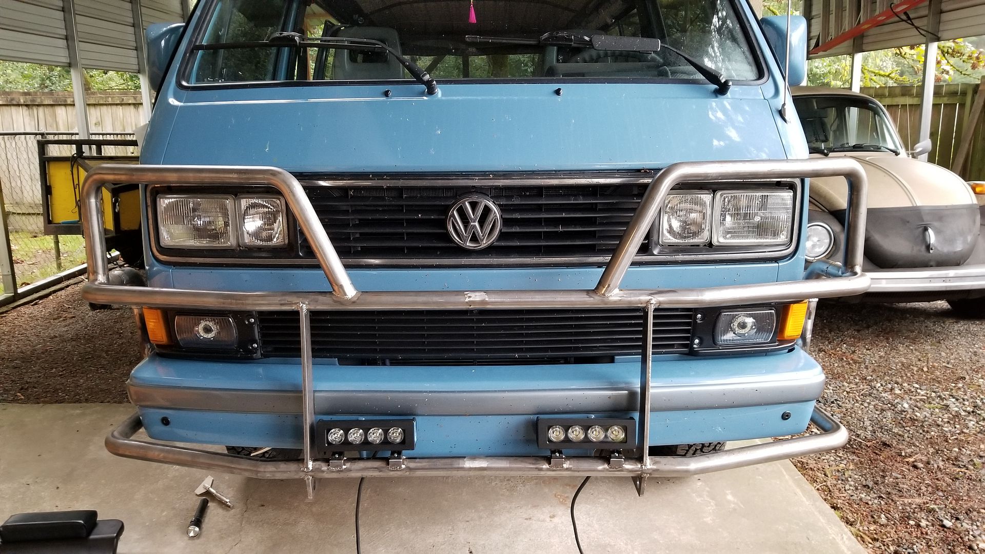

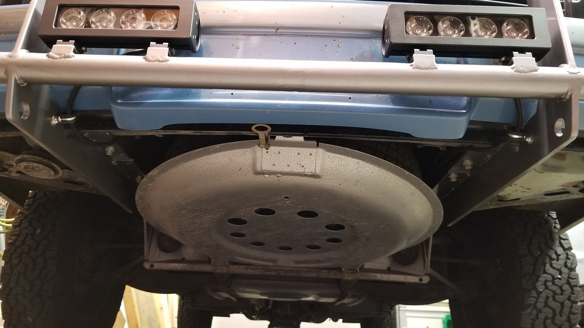

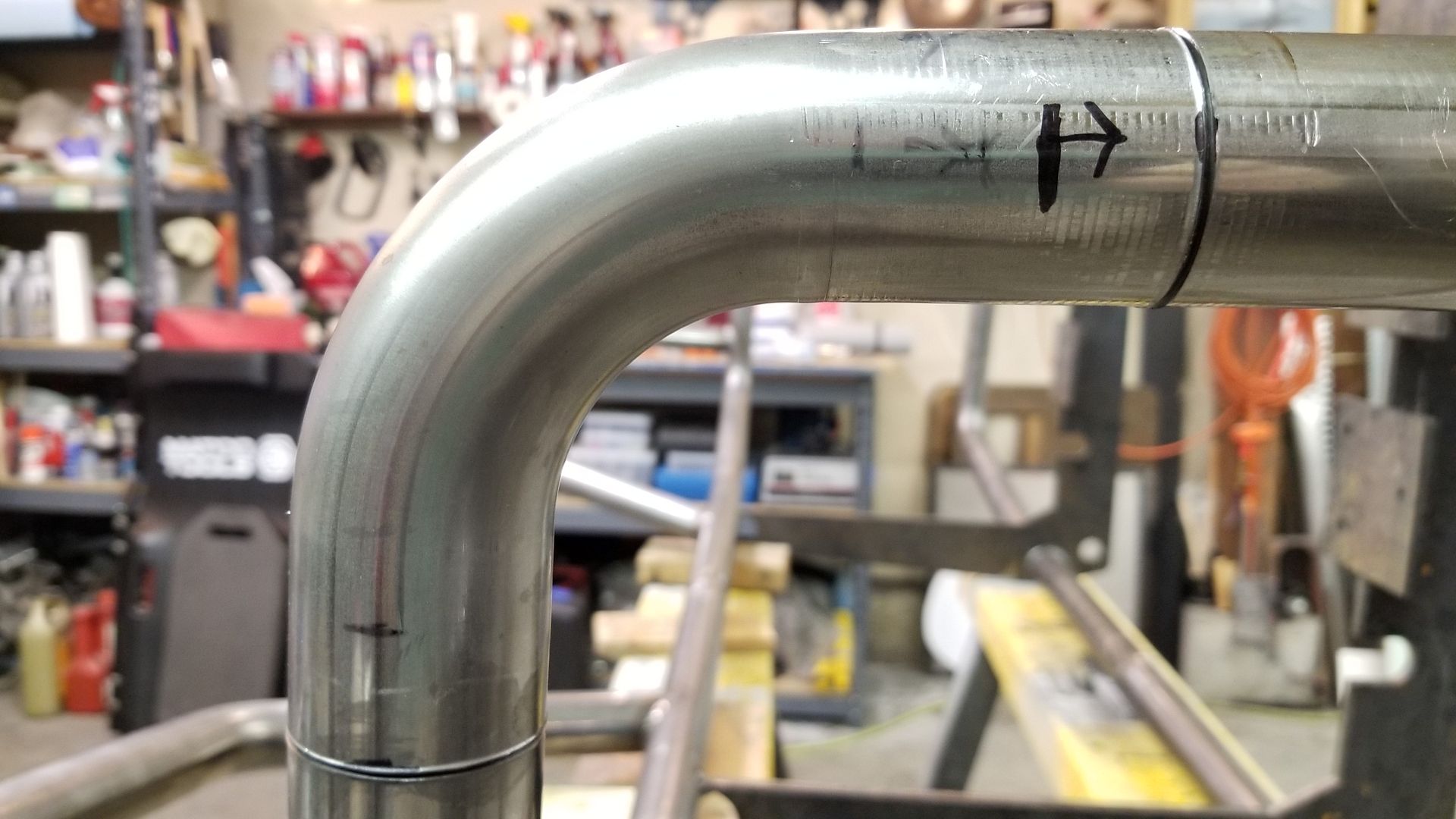

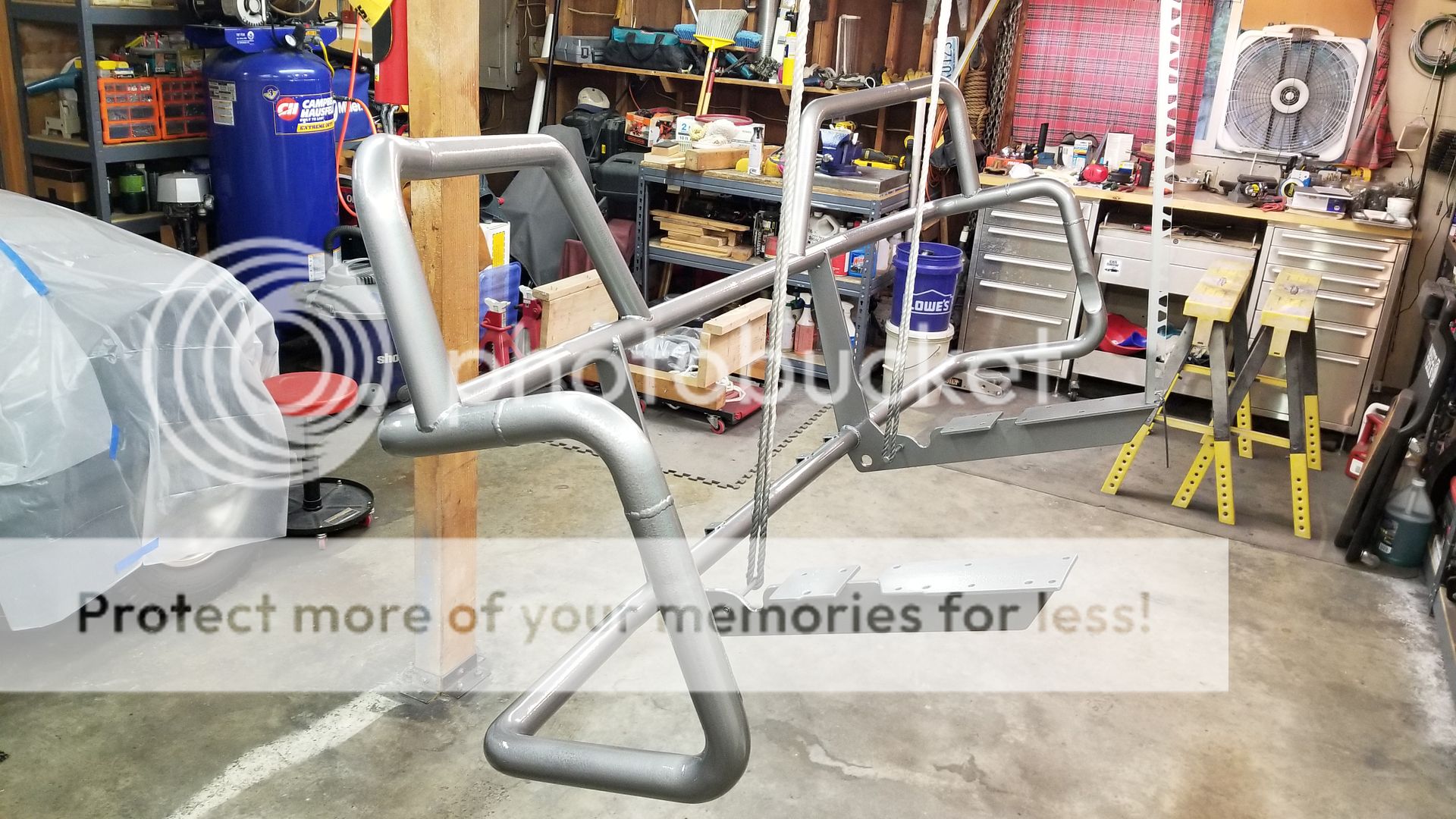

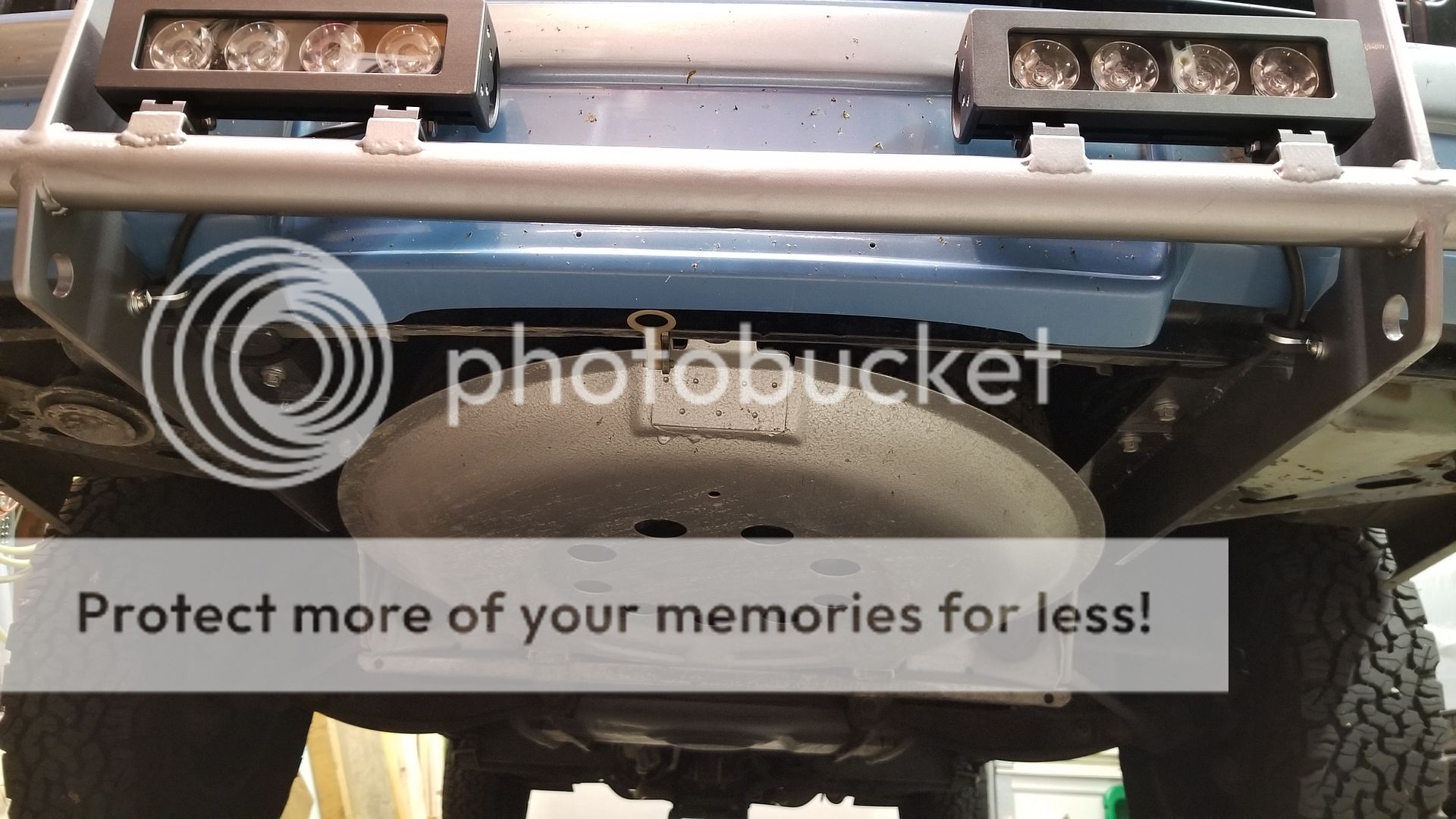

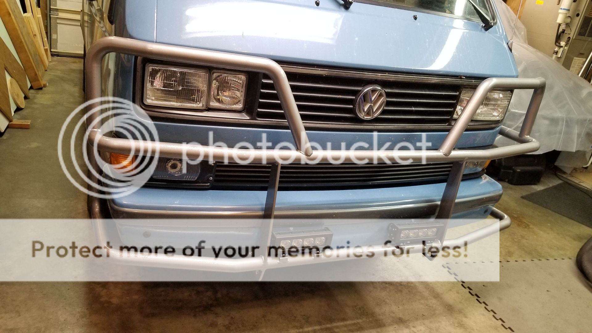

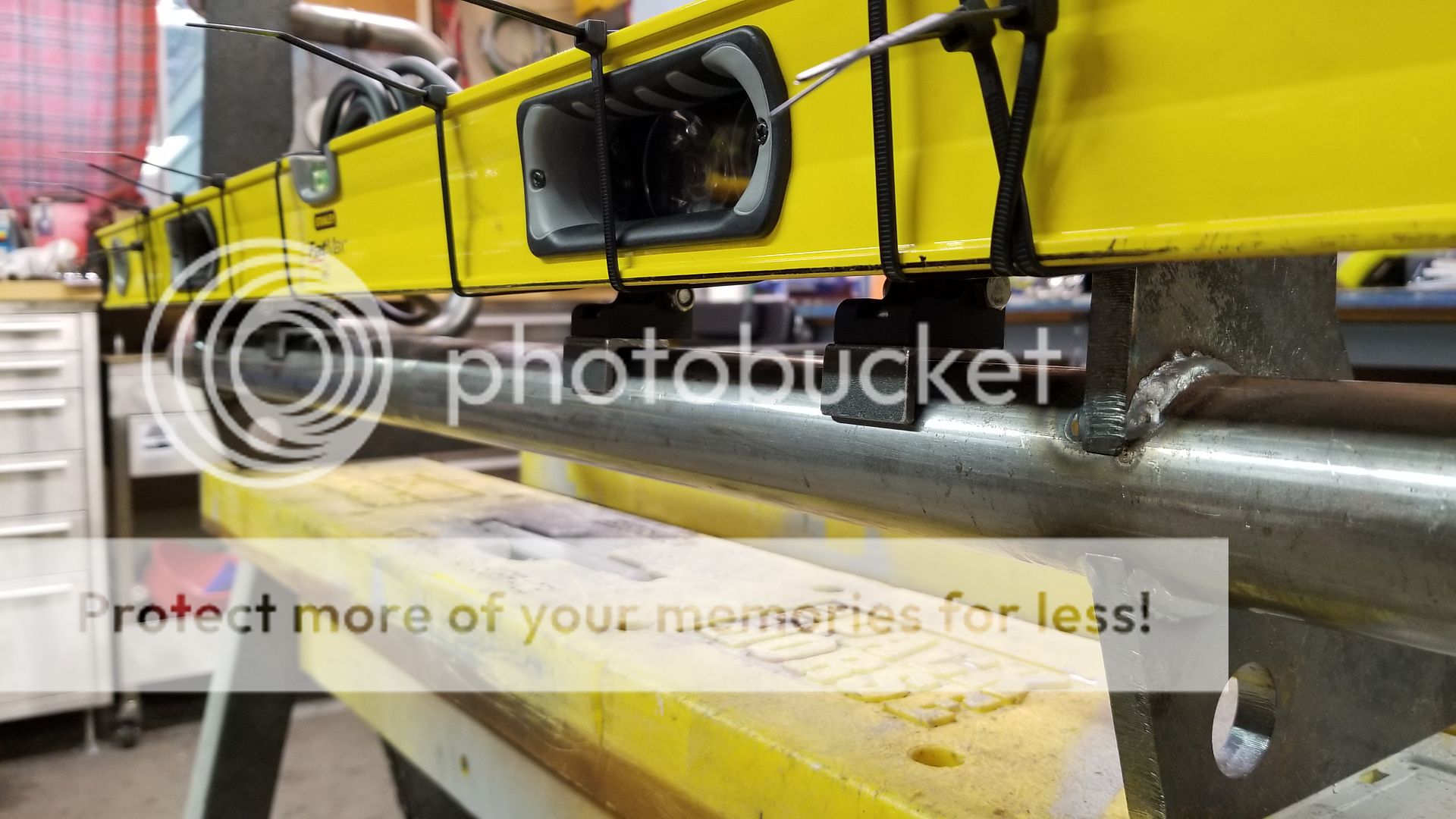

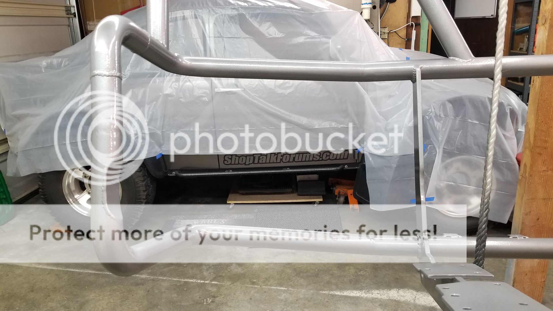

I needed to mount a couple LED driving lights while I've got bare metal. The lower cross bar had one of 4 sleeved butt-welds from the manufacturer and was NOT straight. So, to get the lights mounted up "true", I used a straight edge (48" level) to hold them in position while tacking on the brackets I made.

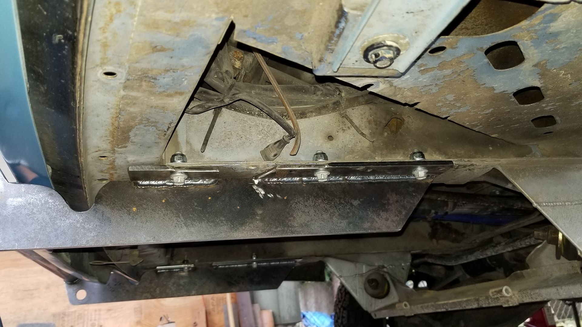

Everything all welded up, last full test fit, free of any additional paint damage

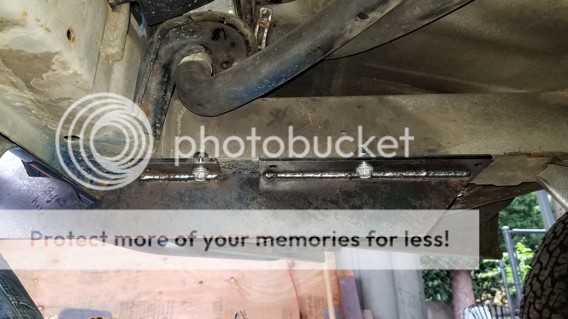

. Got the mounting holes drilled, hardware sorted (10) 10.9 flanged bolts, M10x1.5
Had to clear that little rib in the front bumper too...

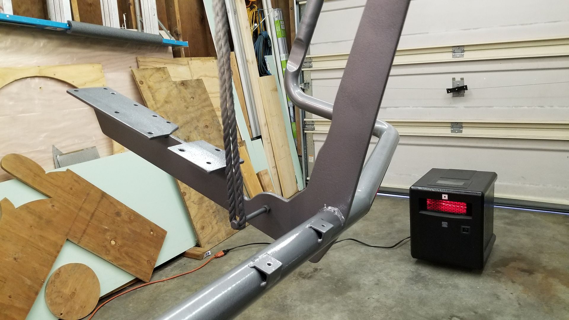

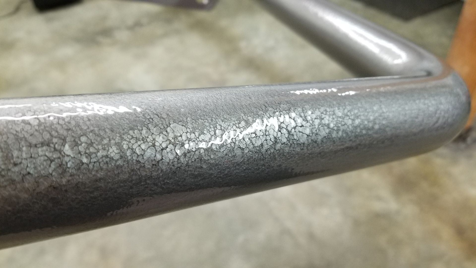

Fitting good, so I got it cleaned up and smoothed out a bit, degreased and sanded. Washed it one last time and hung it up in the garage to spray with some rattle can hammertone. Came out "ok", feels kinda quick n dirty. This is our Go-er, not a show-er vehicle, so focus is on function, mostly. If the paint ever fully cures, we'll be hanging hammocks from the top bar
I wish it all looked this good...
