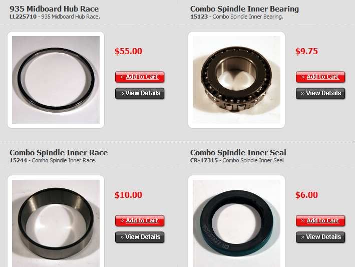

Napa is a no go @ 130 clams for 2 inner bearings 2 inner races and 2 seals plus have to be ordered. I have tried Advance auto, Auto-zone, Bearings and Drives, Motion Industries, Pep Boys, Car Quest, O'reilly's, to name a few.
- david58
- Posts: 14100
Re: NQ JQKE Dead Line Approaching (MAY)
Not sure if this is the right seal different part # but the prices are closer to my budget.

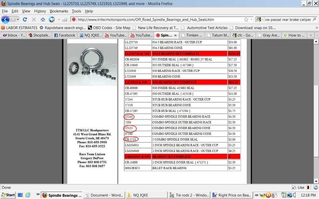

OK ladies I have been on the phone with some real nice to talk to people. I called
http://www.tritecmotorsports.com/Off_Ro ... _Seals.htm
And was given Gregory Dupree's phone number, this guy is the King of Customer Service. He was more than helpful and had some killer prices on bearings.
Only problem was I didn't need enough parts to fill their 100 minimum order, so he refers me to http://gryarea.com/2001.html because they don't have a minimum order, and sell their parts, again Great Customer Service. Both these guys are really worth looking into. Especially for disk brakes if you want to save a few bucks. Gray Area is working to get their products online so we can shop online, give them a week or so and the site should be up and running.
We have a board member that saw I was having trouble finding parts, inner bearings and seals and is going home to double check to see if they are what I need and send them to me. It is really great to have friends here I am lost for words. I was hoping to have the bearings today locally, but that wouldn't and couldn't happen. We still have http://www.tatummotorsports.com/store.php?cPath=6_36 also with half the price of NAPA.

This morning I ordered the inner bearings and seals for the combo spindles from
I am getting 8 races, 8 bearings and 8 seals shipped for less than what I could buy 2 each of from Napa.
