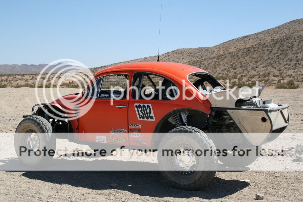

I chased 1303.
Cross-threaded is tighter than Lock-tite

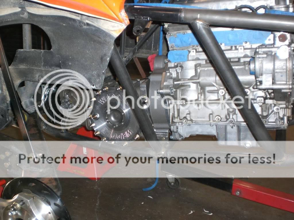

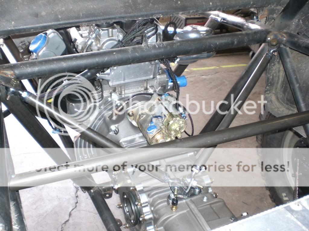

some mounting pics
CentralWAbaja
Posts: 4291
Re: Central WA Baja
Post by CentralWAbaja »
Thanks for the pics Busk.
Why the adjustable support struts on the top of the trans?
Did you do a cable shifter or a solid linkage? I will be doing the solid linkage and probably a ProAm or Fortin shifter on mine.
Also I am thinking about using bushings instead of solid mounting? Not real sure if that is a good idea or not yet?

Busk
Posts: 307
Joined: Wed Dec 01, 2010 8:02 pm
Re: Central WA Baja
Post by Busk »
i made the top mounts like that so its easy to remove, no fighting the bolts to get them out, ect. plus the parts were pretty cheap to make them like that. i use a solid rod for the shift shaft with a u-joint at the trans and the shifter. i use the same shifter i used with my bus box, an empi trigger shifter. im using the linkage that weddle sells that moves the shift rod to the front of the trans. as far as mounting i always solid mount everything but a dense bushing would work as well. this probably goes without saying but just make sure you mount the motor and tranny the same way, both solid mounted or both with bushings.
great build by the way. looks really awesome
