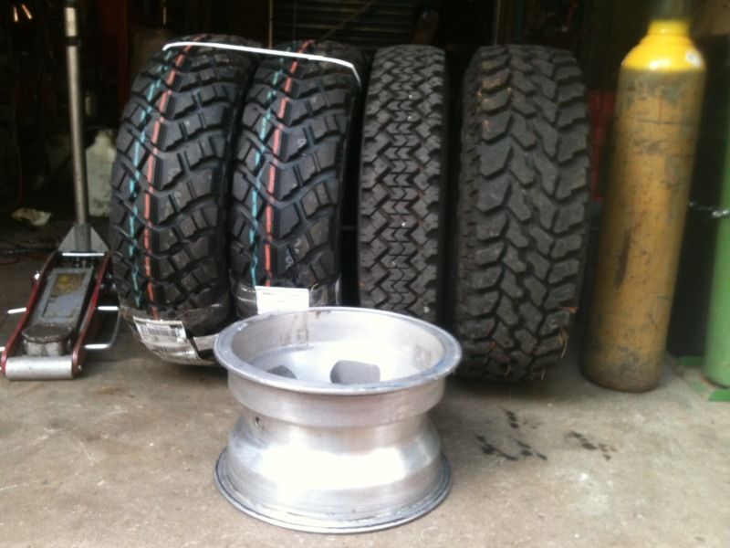

Dad picked me up a new larger welding bottle so I can weld some Sport Beetle seat-frames back together for his ex-wife - who he's selling his old `69 Beetle (the one that was converted to RHD for a couple years)...So now I'm thinking about finishing the roof rack too - so I've been shopping for lights :(

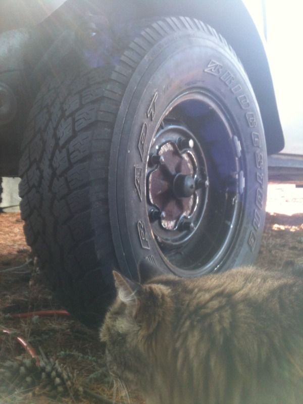

The new Geolandars next to the 7.00R-15s on 4" BTR's, and one of the old Firestone Destination M/T's on the other Ansen.
My current spare is a 235/75 on 6" reverse center `66/`67 steelie, and my Baja supervisor:
My other 4-lug spare ;)

I did find/check the bolt-on wheel-adapter and with ~.080" or so ground off each point it should nest right inside the Type III drum. The wheels are at the re-finisher and being matched to a picture of my BTR's...pretty excited.

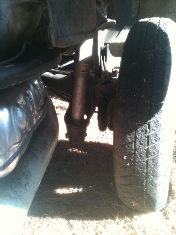

I figure I'll have to put the Baja back together if for nothing else than to test the transmission...So maybe I'll do the swap next spring so Dad and I can drive it this winter, I have plenty of things to do on the `69 before it's ready for running gear anyway.

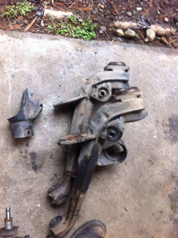

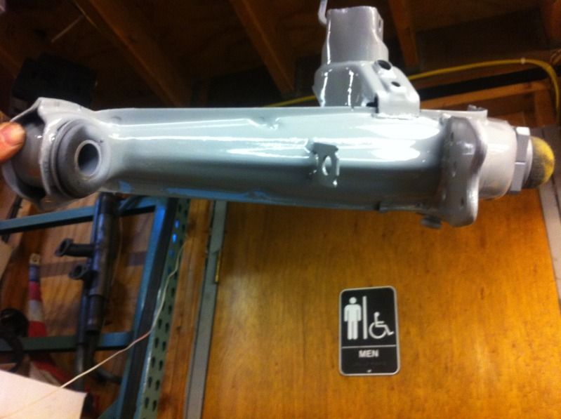

The shock pocket wouldn't allow the stub-axle to come out - so off it went.

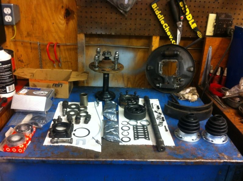

Well, got the control arm all re-assembled and the axle built too...but it was raining and the garage was/is a mess so we cleaned a bit...and Dad swapped nosecones on a 4.125 transaxle for the red-`69, and I shortened one of the AVIS adjuster bolts ~5/16" on his `69 so the swaybar stopped hitting it - also centered the steering wheel finally.

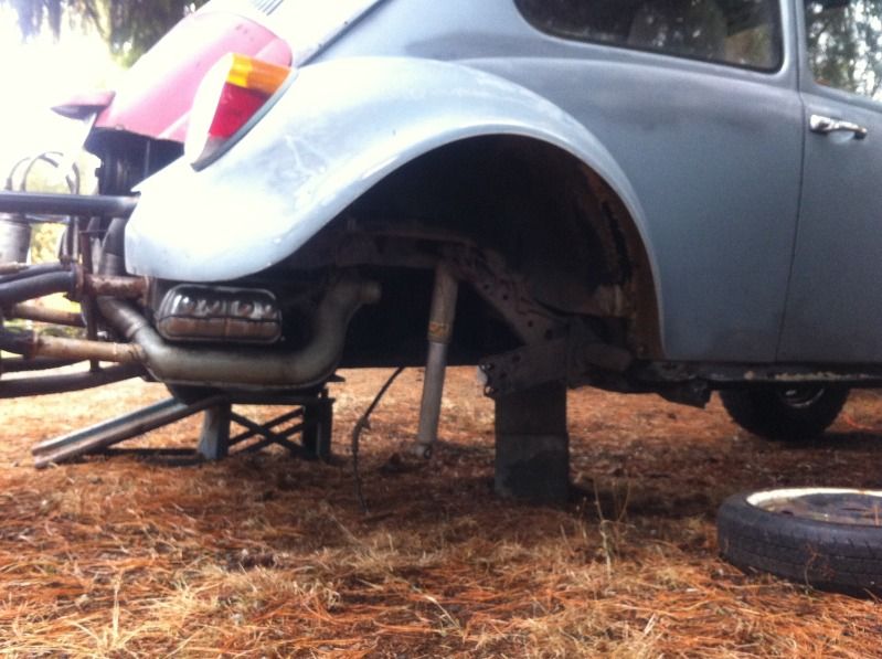

Got the engine/trans in the `69 - so I used it to pull the Baja upto the garage after I installed the rebuilt diaganol arm...but it's pretty wet out there, sooooo final-drive flange seal, half-shaft, battery, and put the brake back together tomorrow hopefully. :) The server fans came - so maybe I'll get to hacking the wiring later too.

Got the final drive flange pulled-off and ground it down in three places where the balls hit - the stub axle was smeared in the same way, axle went in no problems. Got the brakes put back together and bled/adjusted...tossed the yellow top in and she fired right up after getting oil pressure...

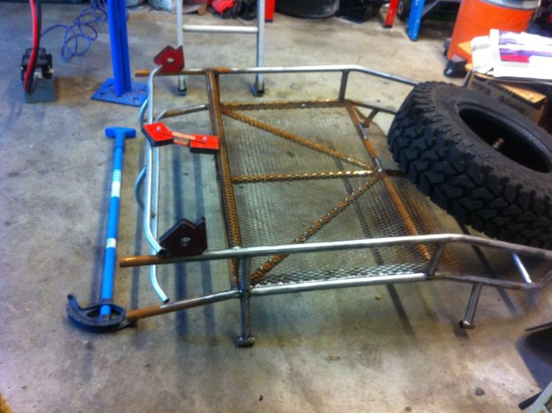

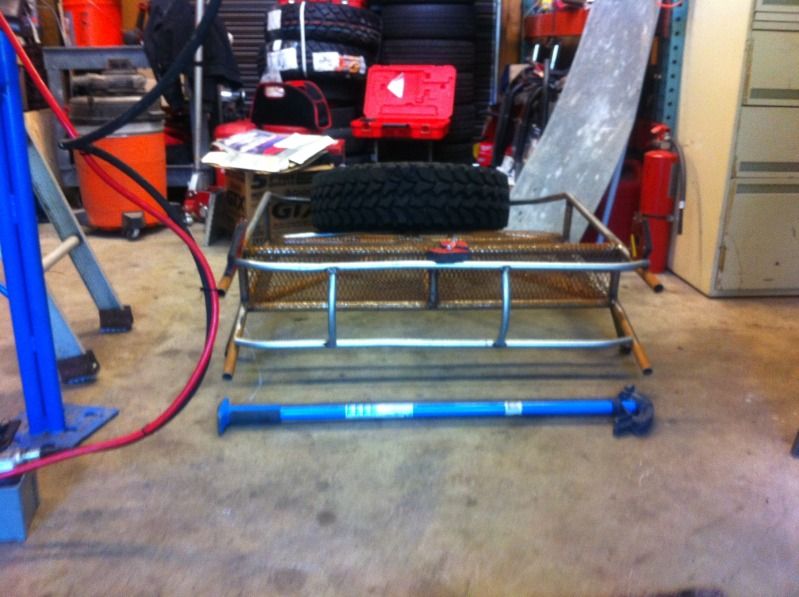

Picked-up 60' of tubing so there won't be any running-out for awhile...Didn't want to waste any of it, so I tinkered with some scrap 1/2" EMT to get an idea. Whatcha' think? I'm a little worried about lighting up the hood so I'm thinking I should keep them low and set-back from the windshield a bit...
Just got word, the Ansen wheels are roughed-in and just may be back to me tomorrow after polishing! $100 cheaper than quoted too!
