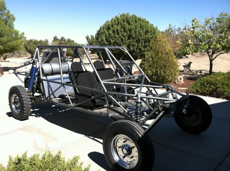

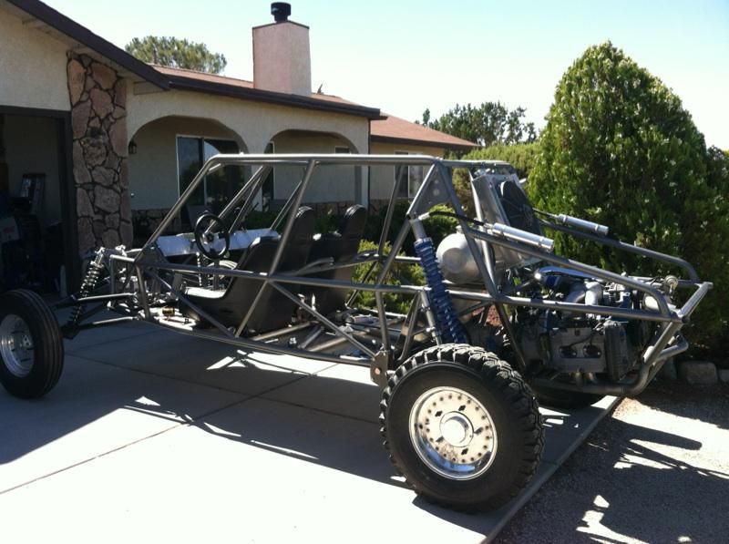

Been working like crazy on her to get her ready for the upcoming season. Finished up the rear suspension and bump stops. Shoved the engine back 4.5" to get rid of the compound angles on the CV's. Front suspension is done besides limit straps. Dash and rear firewall mocked up. Brake plumbing in process. Gotta pull the tranny back out and have it rebuilt. Reverse makes noise and pops out once and a while. Then bolt it in, hook up the axles, plumb the cooling system and wire the car. Gonna be tight on time!
This was from a couple of weeks ago, before I buttoned up the rear, just wanted to show the CV angle at ride height.

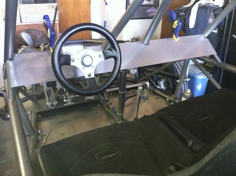

Little more work fitting the dash. Now to figure out how to secure it and where to put the gauges and switches.

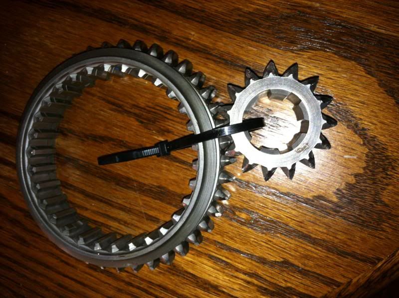

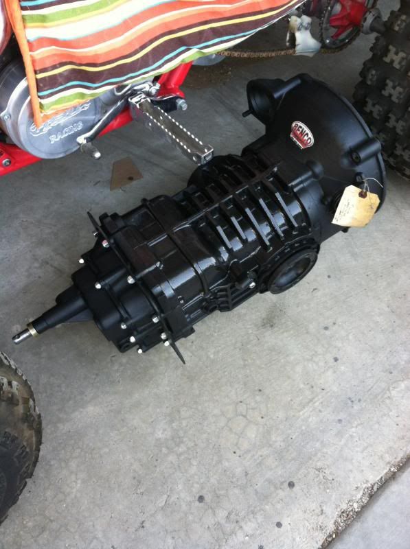

Just got the tranny back from rebuild. Looks like the noisy reverse should be fixed. Tomorrow I have a bit of welding to do for fuel pump/filter mounts and then I will put it back in!

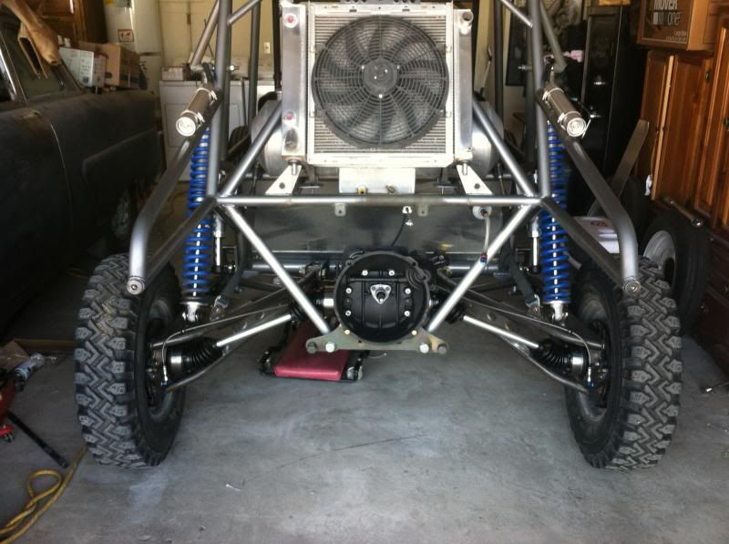

Mounted the fuel pump and filter and installed the tranny and CV axles. It reminded me how much I hate CV grease! :x
