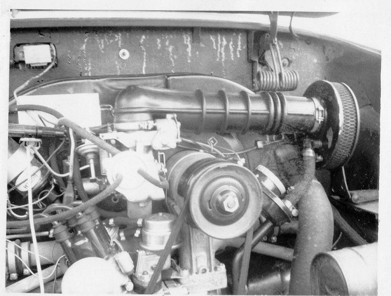

Above: Modified air cleaner, on brand new 1972 Ghia -- in 1972.
Hi Randy,
Check the main jet size in your carb. You probably have an original Solex or a near Solex clone Bocar.
You want a 127.5 or 130 main. You might be running around on something much less.
And, yours being a Ghia, there is precious little room on top of the carb for an air cleaner, and you need some "stand-off" area above the carb mouth. Bug's had almost five inches of built-in velocity stack because of the air cleaner design. At WOT, a considerable fuel fog boils up out of the single carb as manifold vac drops to about 1 to 2 inches of vac. On a Ghia, you can clamp flexible tubing to the carb top and locate the air filter to the side, similiar to what the factory used to do.
These low-profile air cleaners actually cause flat spots on full accelleration, and limit top end.

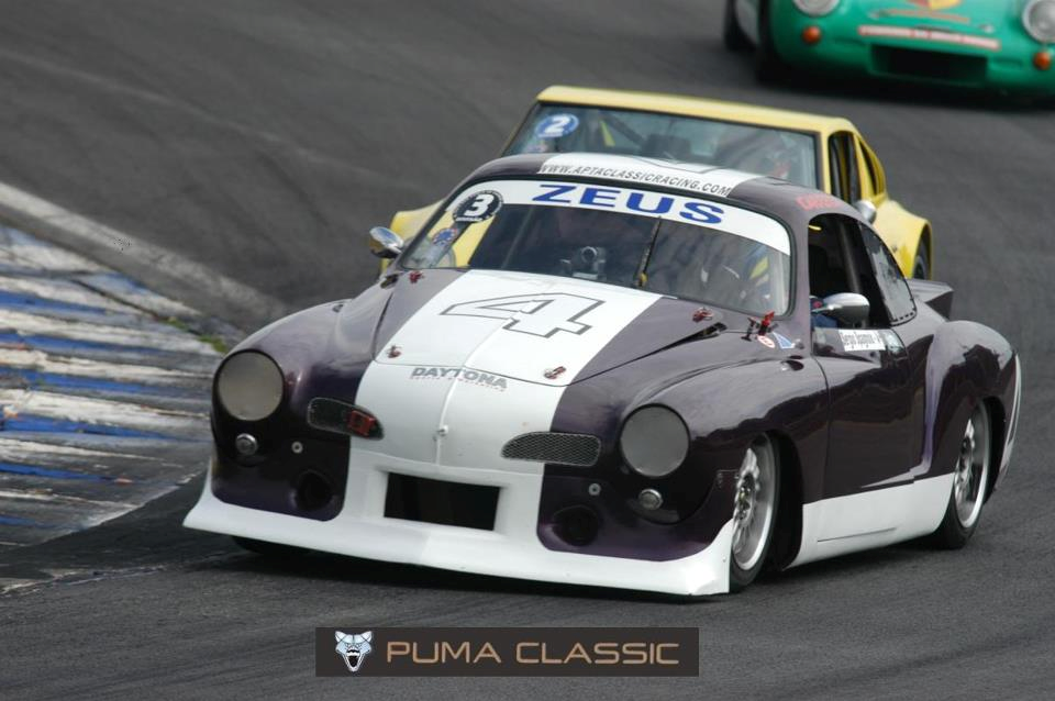

Wow ... my car is going to look like a ret compared to that!Fiatdude wrote:Hey Randy -- I went with Kirkey seats and with the cloth covers, I've found them to be very comfortable, but I haven't done a 300 mile trip in them yet
[/url]
and you can see with my cage and me being 6'4" I had very little play room
I really like this shot Any guesses on how much it is lowered and what wheel sizes/offsets are on the car? As near as I can tell it was for sale in Portugal in 2012 ...

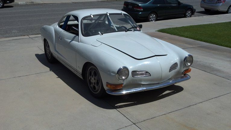

Tow Bar hits the bumper blues ...
I've been putting this off too long ...
Today was fit the towbar day.
First up was to mount the bar and see what clearance issues I might have: There is next to no clearance between the towbar and the bumper (it would not go on at all with the front plate on the car): And it puts the hitch only 11" off the ground when the bar is hard up against the bumper: I did some measuring and grade 8 math and went Harbor Freight to see what I could scrounge. Less than $100 I was back and thrashing: Oh yeah baby ... this works! No welding required!
Notice how I cured the bumper clearance problem? I just took it off.
Pretty good day, had several people honk and or wave at the car ... no cheerleaders yet ...
Randy
