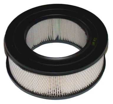

round air filter
hi travis, look on your plstic cover you have a ,,no,, 022,129,620 you can find this parts no. on the air filter , look bughouse.com ,,, 15,$

oh,,, bill,k,,, make attention with the filter ,,, bughouse sale one air filter , they said he fit for the 412 but i have one with me ( not from bughouse ) and the cover d,t close tite , and we have a air leak onder the cover ,,, look for that ,,, it is not expensive but if you want the original from bosh look in the ,,,,pellican porsche parts ,,,porsche 914 -70-73 ,,,1700 cc,, or you can look in ,,,autoattlenta,,, porsche parts ,,, for same model ,,, more expensive 20.$ but original to vw ,,,

I tried Pelican - NLA. AtlantaAuto shipped me a Napa Gold 6036 - wrong size. No luck other places as well.
Returning to K&N web site per Ray's suggestion, I found the "find by dimension" tool. My old filter measures about 3.22" tall on ID, 2.94" tall on OD. The triangular sectioned boss on the ID ends of the filter do the sealing (3.22"). The top filter housing has inside lip of 4.87" OD. E-3218 looks like the ticket - 3.25" tall with 4.875" ID.
http://store.knfilters.com/search/produ ... rod=E-3218
http://store.summitracing.com/partdetai ... knn-e-3218

bill, i can send you the exact dimention for this filter if you want ,, i have the same ,,022-129-620 alb.

Please do. The green wagon I bought recently came without a filteralbert wrote:bill, i can send you the exact dimention for this filter if you want ,, i have the same ,,022-129-620 alb.

One note, about what Albert is saying with the filter fit.
Many aftermarket filters...especially the Fram...have a rubber/plastisol ring on the top and bottom that is designed to crush down. It will not fit properly. The rubber is too hard. It not only leaves a gap around teh outside edge of the two plastic halves...it props them apart under too much tension. When the plastic gets hot....it will crack. Been there...done that.
Also be sure that any aftermarket filter you use is not too short. I have had some in the past that I had to build up about 1/8" with sheet rubber. The K&N is probably the answer. Ray

bill, i have on my 412-73 round air filter from mann pn ,, C2180,,he fit no.1,, look on ebay or samba , and look in the type3 on samba or porshe parts
