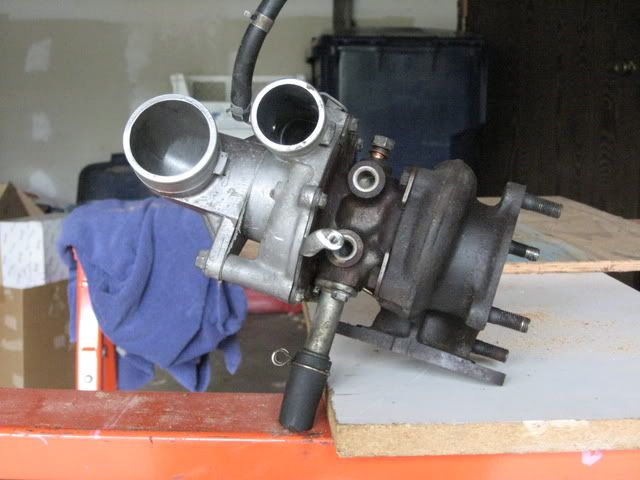

Hey Everyone,
I found these two Items at the Portland swap Meet and couldn't pass them up.
So I guess I have now begun the turbo mod.
Turbo is a IHI RHB5 form a subaru 80's or early 90's
Weber IDF 44 Carb
Has 32mm venturis
135 mains
160 airs
F-7 Emulsions
65 idles
90 F5 pump
I hope to get turbo emulsion tubes and either build my own header or modify an existing one to try it.
Also want to boost refernce the mechanical fuel pump like I think Mike Thompson mentioned.
Engine is a 1600 dual port with dual kadrons in a Safari Dune Buggy.
I have been driving this for 2 1/2 years now.
It's nothing fancy but it gets me where I'm going and is fun to drive.
Will be ordering The books from CB Performance and possibly turbo emulsion tubes within a few days.
Thanks for all the excellent reading You people have posted. I have learned alot just reading the last year or so. I hope to contribute my joys and sorrows as I work thru this.
Weber IDF 44 Carb
Has 32mm venturis
135 mains
160 airs
F-7 Emulsions
65 idles
90 F5 pump

Seabee,
It is not a t3 flange. It is a three bolt funny triangle but specific to a Subaru as far as I can tell by my research.
I prefer to not cut up this header in case I need to go back to it. There is one more semi local swap meet coming up and I hope to locate a cheap header that I can modify to work. If not, then I will either cob something together or buy a cheap one. Although prices on everthing seemed to have jumped in the last few months.
A friend has a header kit with leftovers bends that I can get cheap also, that is another option.
I did price flanges for the heads and tubes. Add in a couple for the turbo and I came up with over a 100 bucks without the welding and straight pipe.
I could just as well buy a ready built one for a little more.
Although..... I do have a collector laying around I can use.
What kind of tubing would you use to build a header?
Standard exhaust pipe seemed reallly thin to me.
Would .095 11/2 tubing be too heavy???

Mike Thompson,
I have read your build and posts with great interest due to the fact you have the same engine specs.
I have spent soo much time reading that I can't recall where and what info I found.
I am particularly interested in the stock pump mod you spoke of and plan on getting the Turbomania book to read up on that.
I picked up the parts in the pic for less than $100 so I couldn't pass it up.
I originally was looking for a holley 390 cfm 6299 like MOLooker talked of but in a year of looking never found one.
From reading and thinking it seems that blowthru is the better way to go, as I didn't need to get a carbon seal turbo. That and carb icing will be less of a problem. Of course falling into these parts at the swapmeet pretty well sealed the deal.
I am on the prowl for a centermount intake as I speak and so far looking at new, the aluminum centermount low rise manifold CB Performance has is the one I would choose if I can't find a used one.
As far as max boost I am not sure what the blowoff is set at on this turbo so will have to do a checking on it. I am sure tuning wll take some serious work and time to get right.
Thanks to all on this board that take the time to post info so I can learn.
Clonebug
