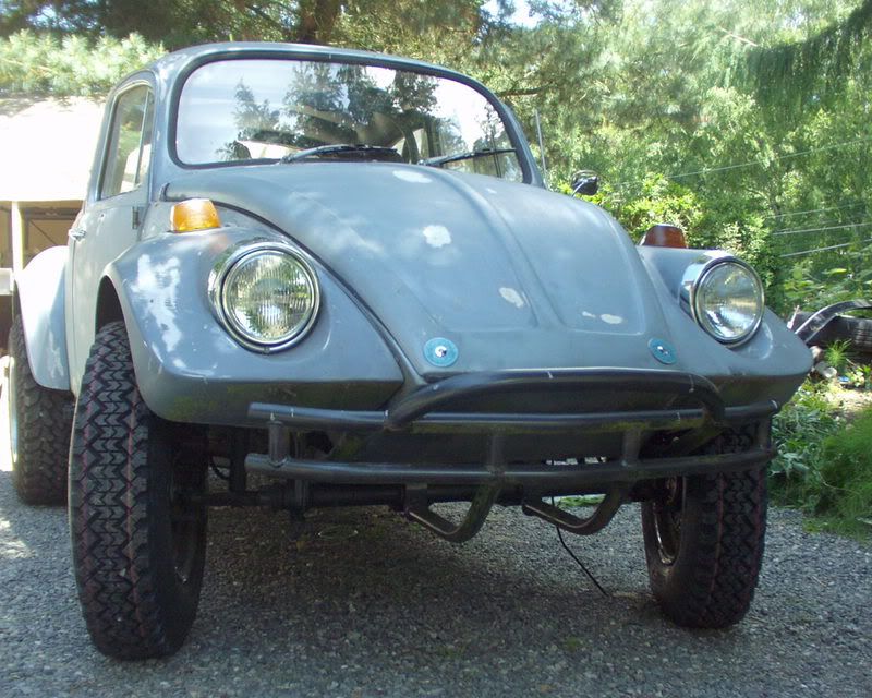

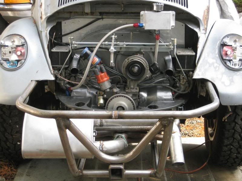

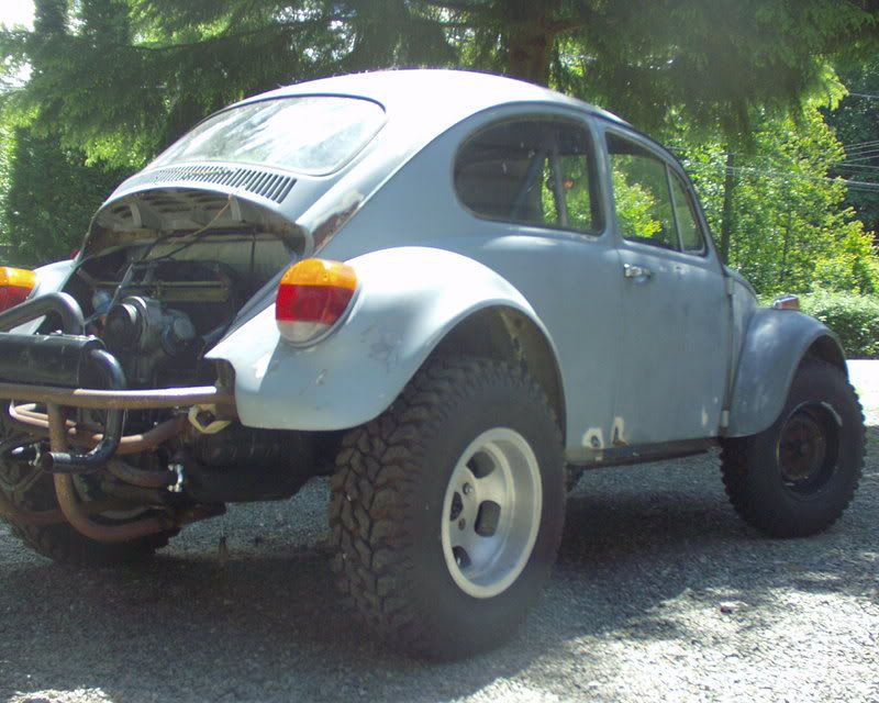

Bumper is coming along really nice. Looks like you've got some practice on that bender. Are you going to solid mount your engine/trans? Looks like you don't have much wiggle room, could just be goofy camera angles though.

turbobaja wrote:Bumper is coming along really nice. Looks like you've got some practice on that bender. Are you going to solid mount your engine/trans? Looks like you don't have much wiggle room, could just be goofy camera angles though.
Actually it's my first time on a JD2 tubing bender - but I bend electrical tubing by profession, so it's not too alien for me.
I'm actually planning on running stock early front and rear mounts and adding a Type III rear engine hanger so I'm hoping it'll be fairly rigid but not so much that it'll shake out the fillings :wink: There's a little wiggle room on the exhaust too just in case :lol:

Yesterday I got the trailer receiver located and tacked into place, bent a couple somewhat snazzy looking tubes to support it. Bottom is at ~14" - just a hair higher than an old Land Cruiser that was in the shop.
Up to now the bumper mounts are just 1-1/2" with ~3" stubs of 1-1/4" hanging out (they're plugwelded in). the rear bumper simply pushes on... I'm having a local exhaust shop make me some flanges and hopefully Monday I'll get to flanging everything on top of the 'locating' stubs.
I think I forgot to mention I tied the bumper mounts together side to side by running an 1-1/2" above the starter motor/clutch lever.

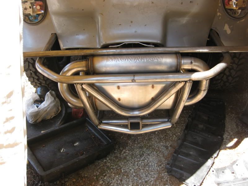

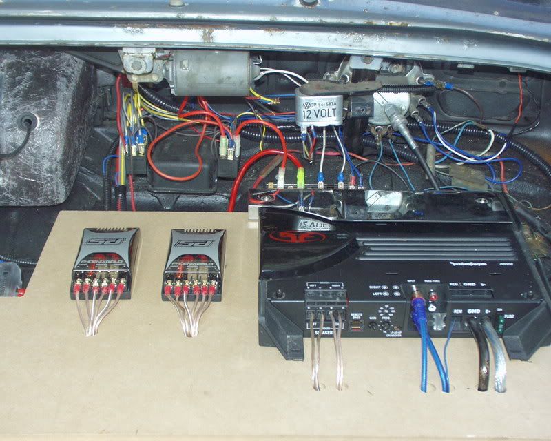

Got the rear bumper all welded, flanged, and bolted on...installed the 2087cc engine, started to think about finishing the amp-rack and calling to put it on the insurance.
This isn't the 'final' engine, so I modified a Thing header, and made a new muffler using a Dynomax...it's also tinned out upright for now, not yet Type III.

Chris V wrote:Ouch, apparently I'm not good enough for the list of guys' with build threads... :lol:

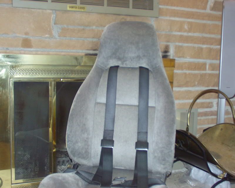

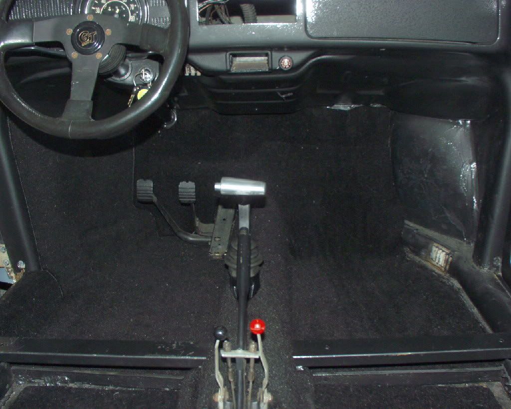

What kinda seats are those? I'm assuming you added the shoulder harness setup?
I've got the same fireplace in my house :shock: . It was in pretty bad shape when I baught the place so I took it off and cleaned it up (not nearly as good as yours look though). I painted the outer frame flat black and just cleaned up the 4 door frames and the vents
They're Eagle Talon, pretty comfy - bit of PITA to modify like this...still need to do the other one :roll:

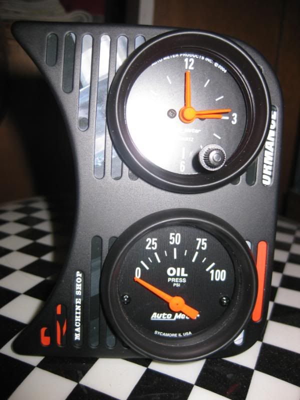

Wired in a clock and oil pressure gauge, dotted the i's, crossed the T's and she's alive again.
