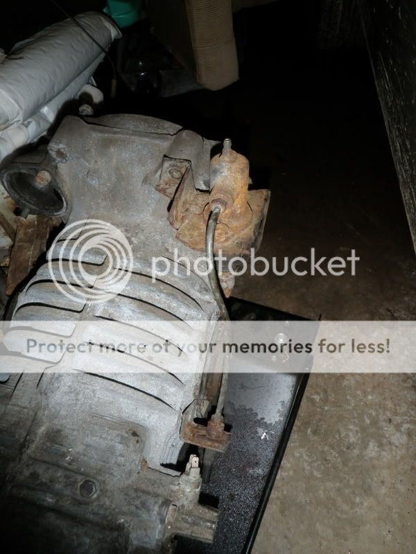

Well to deal with the clutch arm that doesnt move
I got a new bellhousing that im going to build up
next i working on etting all new parts from various places hopefully it comes together soon then timeto pull the engine and trans again

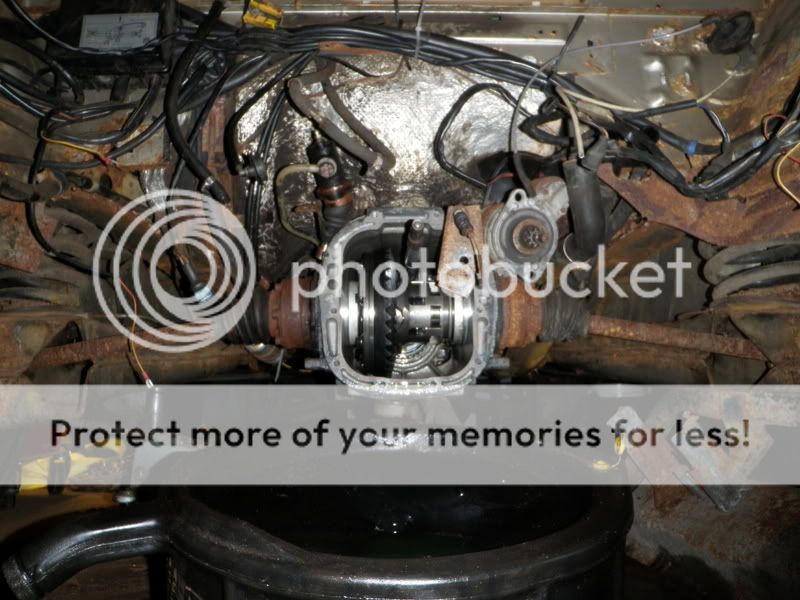

oh and we need to play engine and trans doctor soon, Iwanna see a blown 1.9, and i bet you wanna see a locker go into a 091...

well time for an update. i tried replacing the slave cylindar not easy but would give me some clues still not good
. My engine and wheels was more wheels than engine as it has pissed coolant all over the garage so it will become a reseal. time to finish the engine in the garage, got my pistons ringed now need to get them to temp the the wrist pins will move. I also discovered one reason why it wasnt running so good before, the rust in the end of the intake runners was aparently adding some unmetered air into the intake

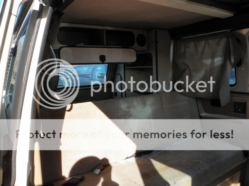

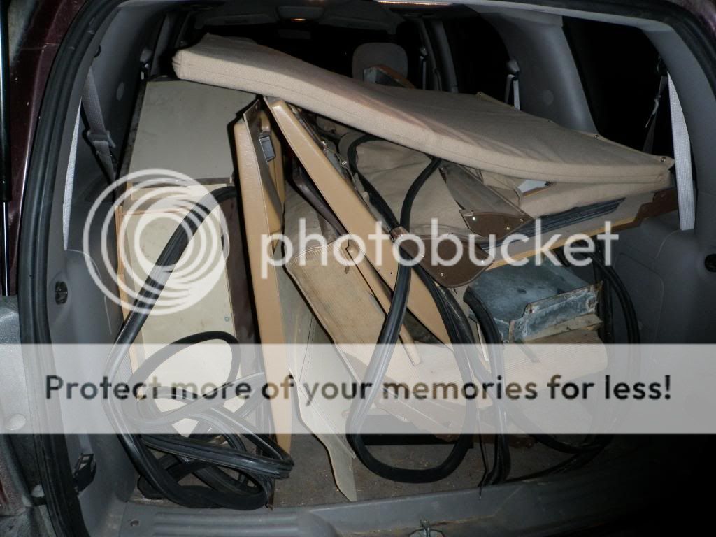

that and i picked up a westy top and intirior for the second syncro.

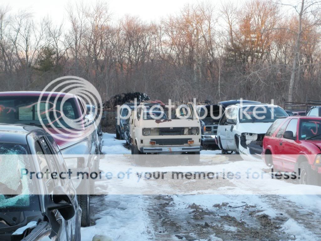

This is my other syncro as i got it
Some cleaning
more cleaning
the new intiror in its previous home
The batted donor.
The interior brought home.
The roof as i brought it home
After i get the silver van driving again synco weekender time
Some cleaning
more cleaning
The batted donor.

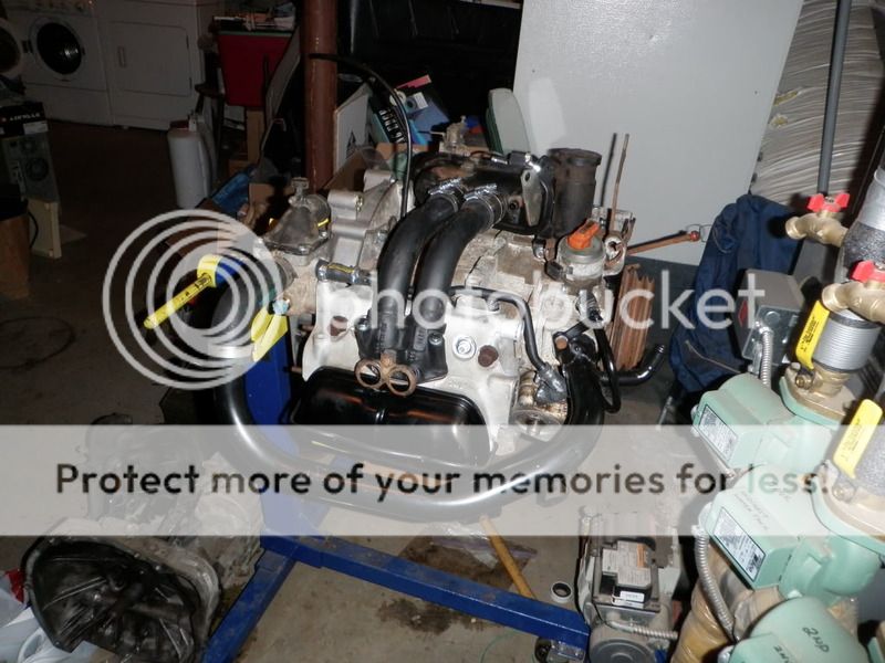

well the canadian remanufactured engine is rebuilt and almst read to go back in the van
now all I have to do is get the subau transmission in the photo back into my legacy wagon so I can stop driving my mothers forester luckily we have 6 registered cars for the 5 of us.

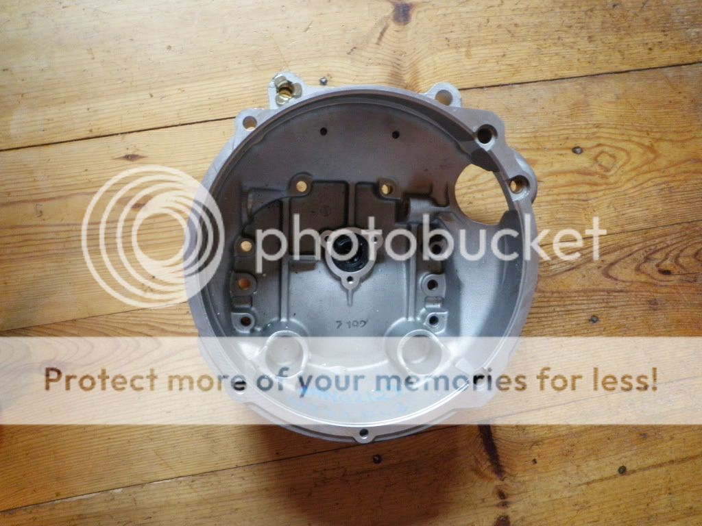

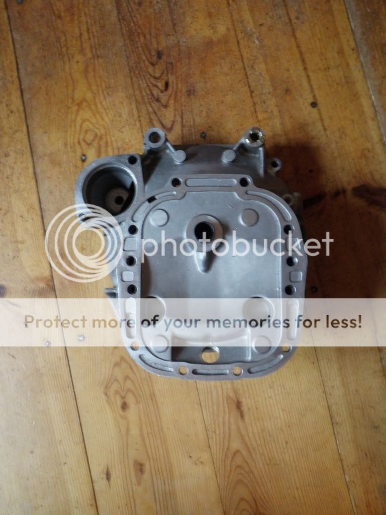

got a bit done yesterday getting the van its getting close to being a runner again.

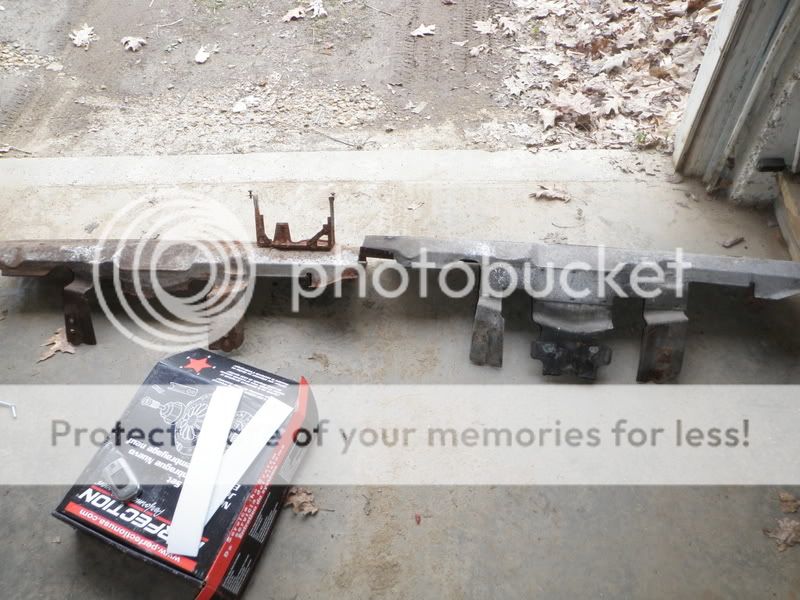

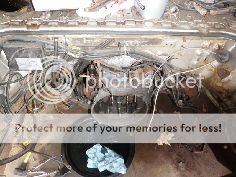

to deal with the seized clutch arm and the unavailability of bushing
i picked up a used 2wd transmission for the bell housing and after some trouble getting the correct gasket it all together.

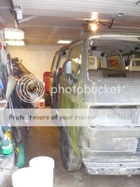

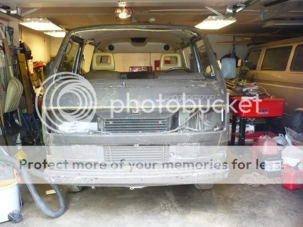

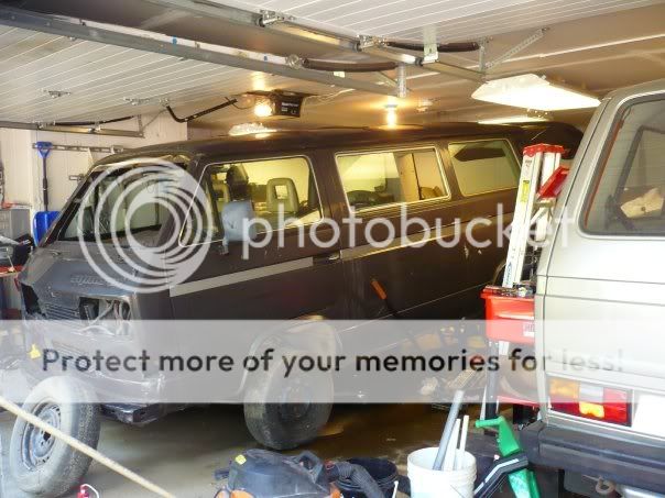

The day started like this with the van:

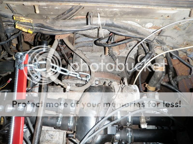

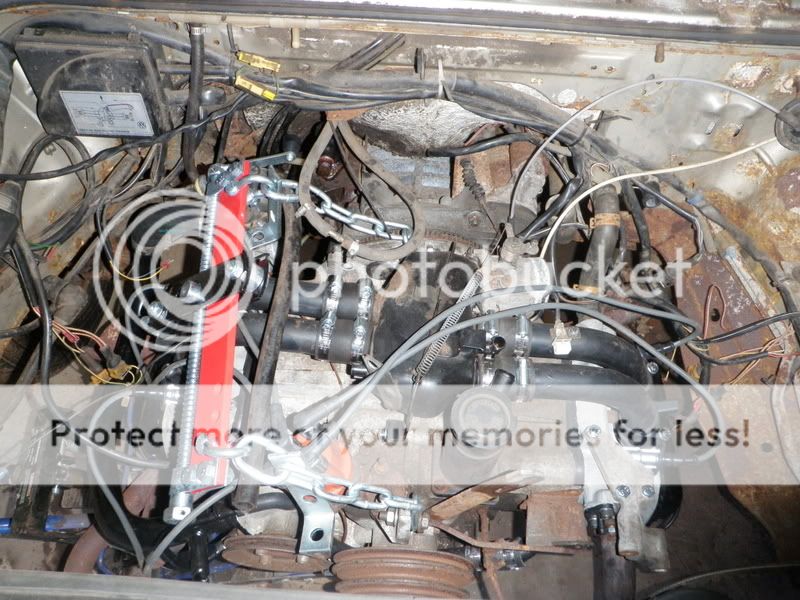

The engine had the new rotor, cap, and wires installed and the valves some what adjusted
next i installed the exhaust and bell housing and got the engine from the basement to the garage with some issues i wish i could get some good help once in a while
I knew my rear aluminum panel was cut up never really understood why picked up some syncro parts a while ago glad to put some correct parts back on
and finished sliding the engine under and close to put in still need to get it mated and oil filler on and hung.
I am close but will have to wait for next weekend.

- fusername
- Posts: 6806
- Joined: Sun Jan 28, 2007 11:26 am
Re: Getting the syncro back on the road
ooh very nice. only diff between 2wd and 4wd bellhousing is the vent holes right? or are they identical? I need to find a new bushing solution soon, my 091 spare is in need, but I may be getting another spare soon...
