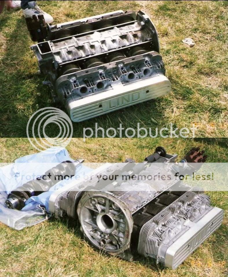

I wish we could get them rocker covers for our flat4s.

#likebutton.

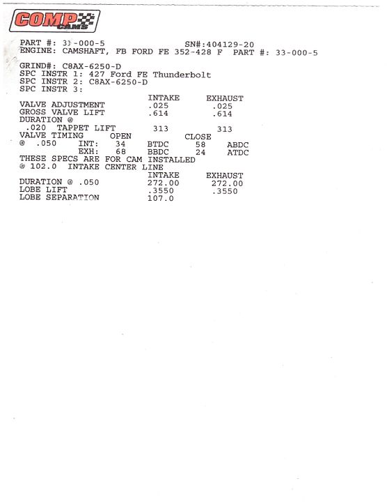

Cams:
