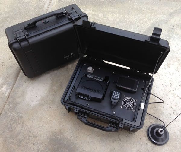

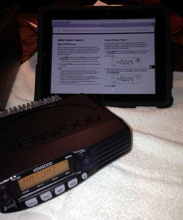

ts39136 wrote:Tk-281a showed up today. :D
You'll find that it is easier to input frequencies using the keypad and to 'label' frequencies on the unit itself... no need for any software.
Finalizing a remote box set-up. Used a 12V Toyo evac fan to 'empty' any heat build up from the heat sink on the radio from the lower portion of the case. In the lower portion, a MFJ921 dual band tuner (SWR meter) will tune the antenna being used, either the Larsen whip or the TRAM base. Still need to finish up a few small details and make it all purdy... but basically the premise is the same.

DesertGuy
Posts: 2303
Joined: Sun Aug 27, 2006 7:45 pm
Re: Race Radio setup and laws.
Post by DesertGuy »
Getrdone wrote:Bond, I'm still working on a pocket version! And please bring it back in one piece, it's still experimental.
...007 style! 8) 8)
Also, 'banked' typical frequencies for different sanctioning bodies in their own area so they can be scanned independently from the main group. That way, if spectating a race, just do a quick set-up with the whip and scan that bank - so if just hanging out at a race, you can hear what is going on elsewhere.
The box is a spectating, testing and remote pit box... just change out the antenna connection and tune in the antenna. Should only take 5 min or so for set-up.

Tell us about the tuner... does it perfect your "antenna length" automatically? Or do you have to dial it in?
DesertGuy
Posts: 2303
Post by DesertGuy »
Still sorting it out... Basically, you cut your antenna to the frequency/frequency band you are operating in, then use the tuner (on location) to fine tune your set-up for maximum efficiency based on those conditions.
Still need to do testing once I get everything buttoned up... making the Deutsch connection for the power supply, then testing

DesertGuy
Posts: 2303
Post by DesertGuy »
bajaherbie wrote:there is an ad on RDC for suitcase radios, no price listed though. doesn't look like they have a cooling fan but it could be on the back.
Not sure you'd need it if you have good ventilation. I added it due to the case being sealed up and I had a couple laying around. They draw .2amps and are rated at 14cfm, plus they were 12V... so figured "what the heck"
