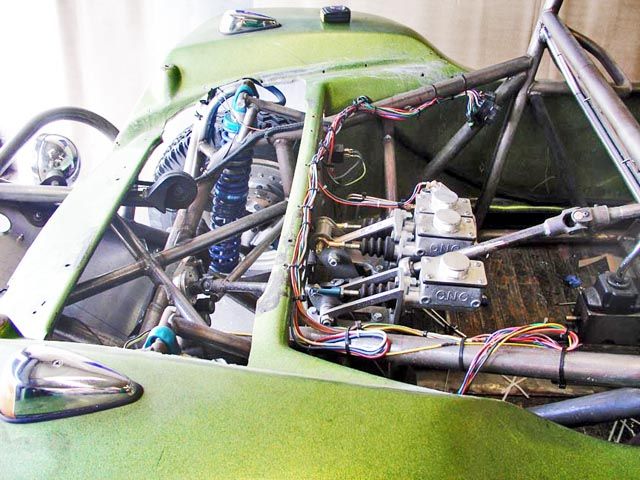

When dealing with Off-roading it is not uncommon for the slave cylinders (caliper/wheel cylinder) to sit higher than the floor mounted MC; e.g., tall tires for example. If there are turning brakes involved and they are mounted on the tunnel then you might put a residual pressure valve against the MC to stop the bleed back from the turning brake assy.
Yes, the residual pressure valves are there to keep the shoes/pucks close to the drums/rotors the reason being to keep the brake fluid from seeping back into the MC which allows the shoes and pucks to back away from their duty position.
It is not uncommon for Bajas or even glass buggies to be converted to swing pedals (MC mounted up high) and use a bell-crank setup with rear facing MCs to stay inside of the body.
I can post some pictures of one if you would like.

Re: brake efficiency problem
Now that you brought it up you just might be right... with closer introspection I do think we are closer to the origional hot rodders in as much as we put ("hash" in some circumstances) things together that don't belong together; masssage them to make them work as a unit.... which is the old hot rod idea. Road racers, by concept, are just another style of hot rodders too.
Modern day cars do use swing/hanging pedals as they allow the seats to sit lower in the car (like rails and many buggies do in order to sit within the confines of the body) and retain leg to pedal geometry rather then having to point your toes to brakie as with floor mounted pedals (I still have mine), shift or work the throttle.
I do agree with the civilizing of a buggy... it can become boring if it is too civilized but.... naaaah, it can't be done sucessfully and still have a fun ride.

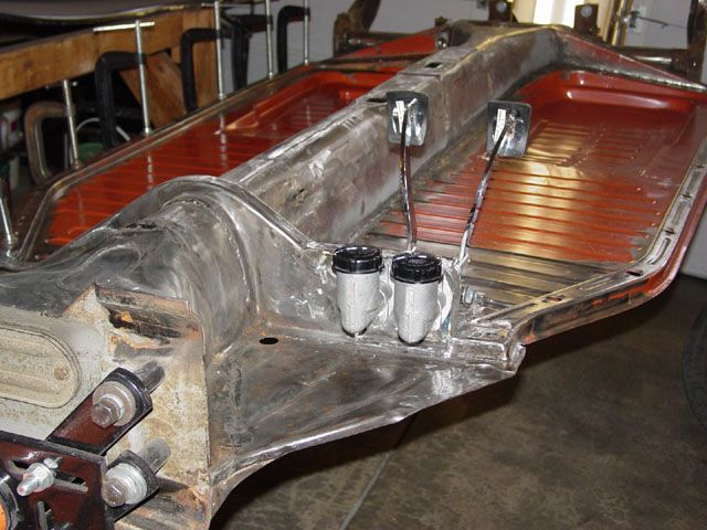

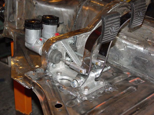

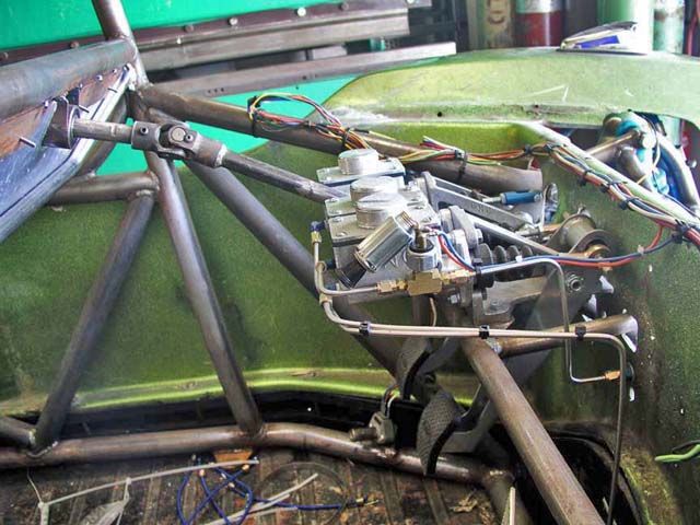

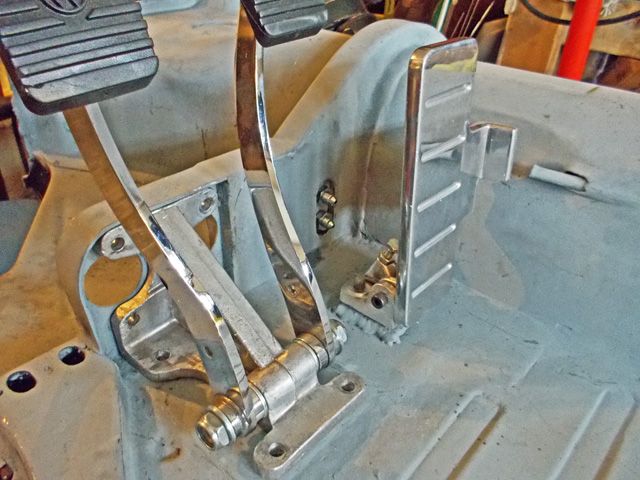

This is how I did the LR pedal assy mount into a bug pan. This does not show the body lift.
This shows where I am now with the through bulkhead brake line fittings. I am making a fairly easy job the hard way just to learn how to accomplish it.
A bell-crank style of swing/hanging pedals in a glass buggy.
