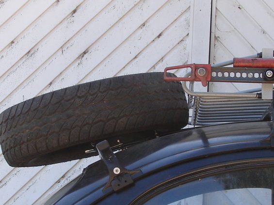

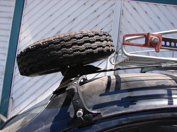

Rack update
new mounts
working on spare tire mount
and shovel mount

Just about done with spare tire mount will post up pictures later.

high lift locking lug
Re: new to site with 64 baja bug
Roof rack looks good. Hope no problems with it coming loose. Lot of weight, lot of movement. Where did you get that spare tire, they still make those?

Leatherneck wrote:Roof rack looks good. Hope no problems with it coming loose. Lot of weight, lot of movement. Where did you get that spare tire, they still make those?
Found it at the junkyard... it was about the right size so I grabbed it
Put some serious bolts on there and locktite that thing. Watch it close. I hope I am wrong but it does look good, also a great idea on the Jack lock..

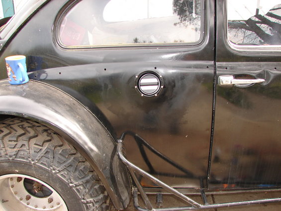

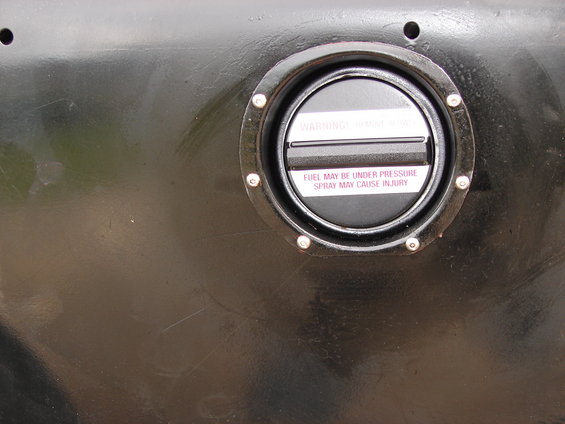

Well the bug has been sitting for a while started working on it again Did not like the way the gas cap looked when I got it
So I made some changes by recessing a cap in the qtr panel
with plastic trim cover
this is the one I like the best no plastic cover and label removed from cap

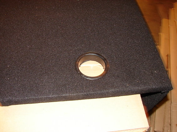

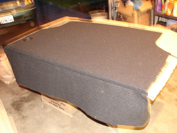

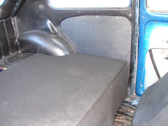

Rainy day work l
recovered rear seat delete/ gas tank cover
Got rid of ugly diamond tuck
used black speaker box cover from Ebay
added a trim ring for filler neck

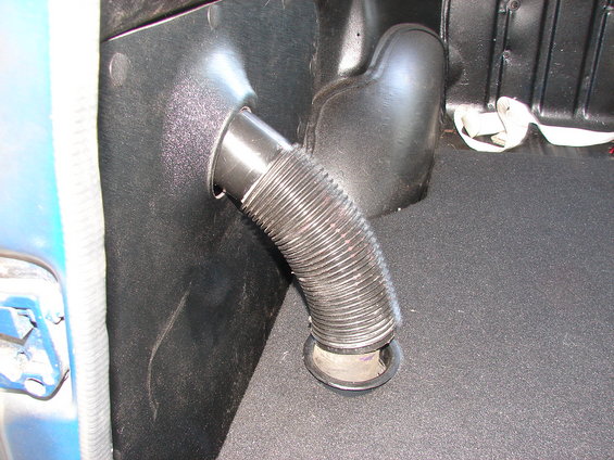

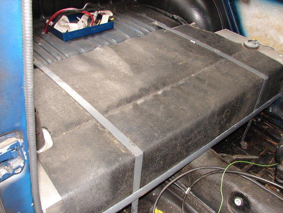

gas tank mounted
ABS filler panels I am working on
driver side rear panel installed and tank cover
passenger side panel with filler neck still need to find a different cover for neck
not too bad for home made
Looking good, what size tank?
5.0 Chero
Posts: 74
Joined: Sat Jun 20, 2015 7:47 am
Post by 5.0 Chero »
Leatherneck wrote:Looking good, what size tank?
From what I can find out it is a Long Ranger Tank 20 or 22 gal tank

Love the canon plug connectors for the roof lights. I also like the rear interior quarter panels What is the material? I like how it forms around the fuel filler tube. Is that something you did?
5.0 Chero
Posts: 74
Post by 5.0 Chero »
chuckput wrote:Love the canon plug connectors for the roof lights. I also like the rear interior quarter panels What is the material? I like how it forms around the fuel filler tube. Is that something you did?
The roof light plugs and mount are from a Servo Motor
The panels are 1/8 thick ABS the raised portion for filler neck was formed with redneck iniquity i used the Plastic insert trim I got with the jeep recess a couple pieces of chip board a head light ring heat gun and ammo can for weight to form it.
