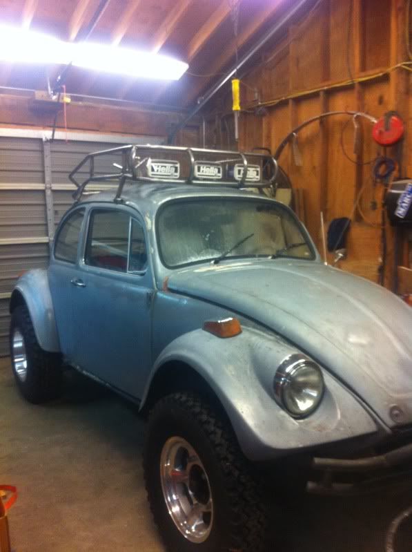

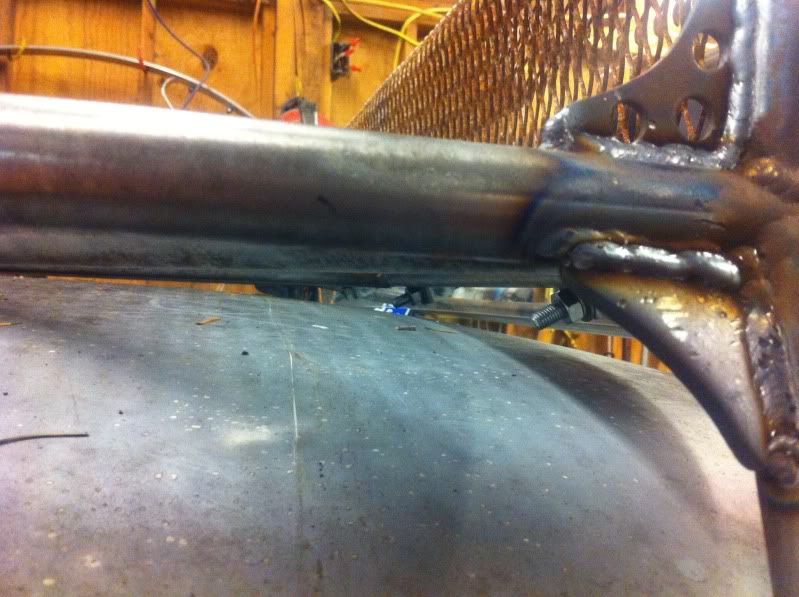

Finished gusseting the rack today (came in right around 67lbs), and played around with some plexi - thinking of making a guard:

Nice! I see you're making the most of your time off work :D . I think I've got twice the weight of your rack in sound deadening material alone... :(

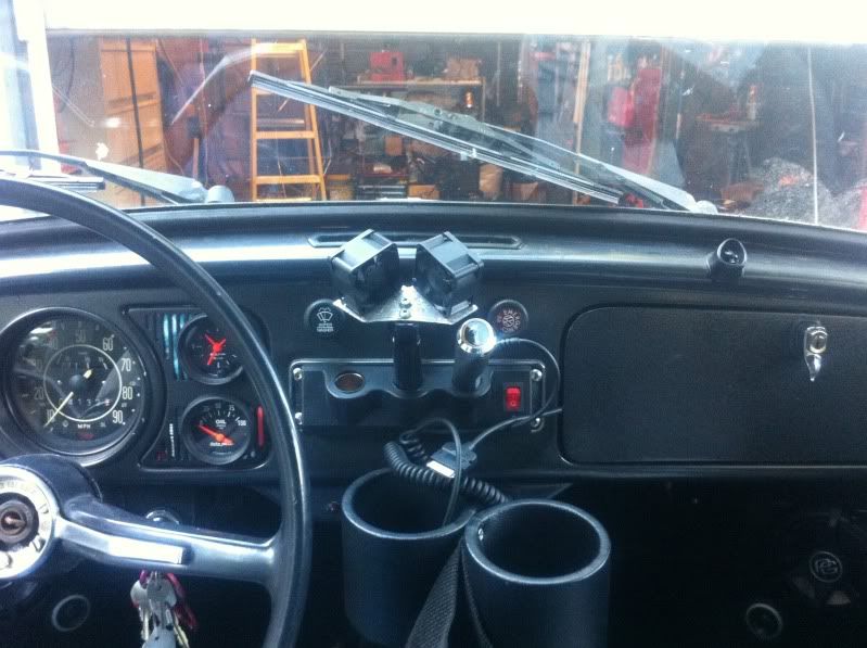

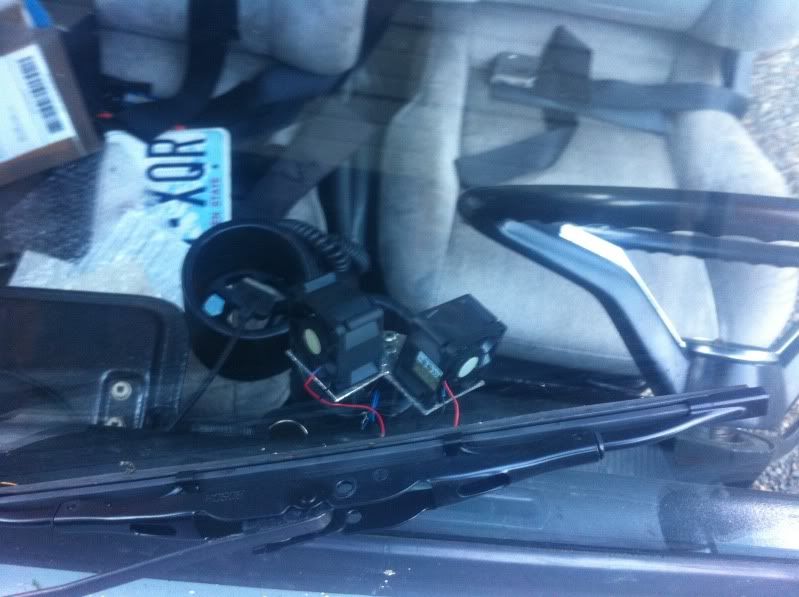

So, what to do when it gets cold & nasty...sit next to my heater in front of the TV w/puppy and dis-assemble CPU fans. I purchased three used fans for like $7.50 inc. shipping only to find out each fan is two fans! They're fairly strong, certainly enough to irritate the dog and less surprisingly the girl ;)
Hopfully I'll have windshield defogging and maybe even rear-window too by next weekend!

Hey Chris, are those 12V fans?

Yes. Nearly all computer fans are 12VDC, and they come in a range of sizes. Most have plain "sleeve" bearings (bushings, actually) ...there do exist higher-quality ones made for hi-endurance service in servers, but they cost many times as much. Since for our purposes (defroster fan, etc.) where it's not the end of the world should one die, IMO it's not worth the expense of the high-end type, your garden-variety cheap fan will probably work just fine for a long long time. Bushing-type fans tend to wear faster if they're positioned with the axis horizontal, so you're better off mounting them with the shaft up-and-down if practical.
Do install some sort of fine screen on the inlet side to stop garbage from getting sucked in; even if the fan blades aren't damaged, anything adhering to them will throw off the balance and the bushing will die prematurely.

The ones I picked-up are ball-bearing server fans:
I robbed a couple pieces off an old FM transmitter for an Ipod to make it simple to use in the Baja (wound-up with just enough room to pull-out the headlight switch, which has a buzzer if it's left on by accident):

Does that work? Looks like your just blowing cabin air onto the windshield. If that works, I'm all over it. I have trouble with fogging, too.
