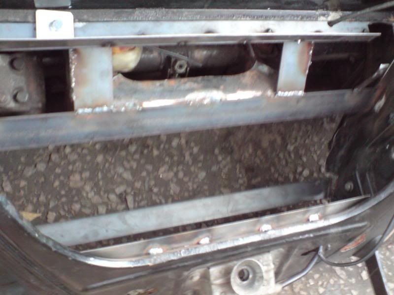

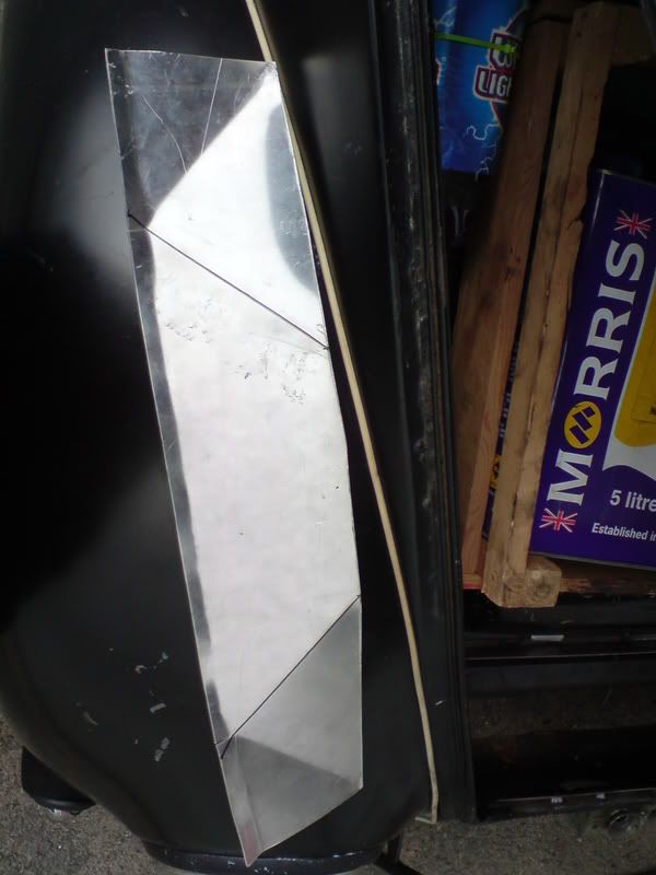

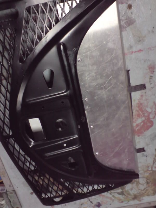

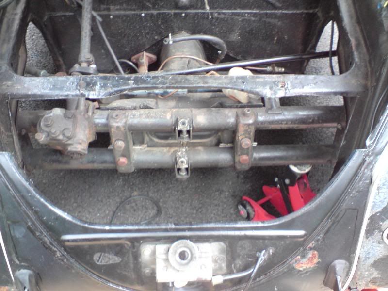

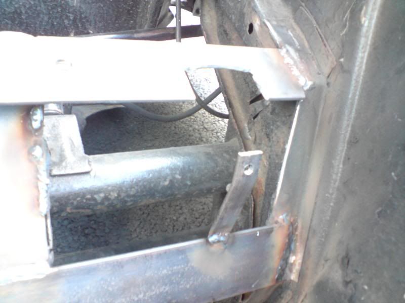

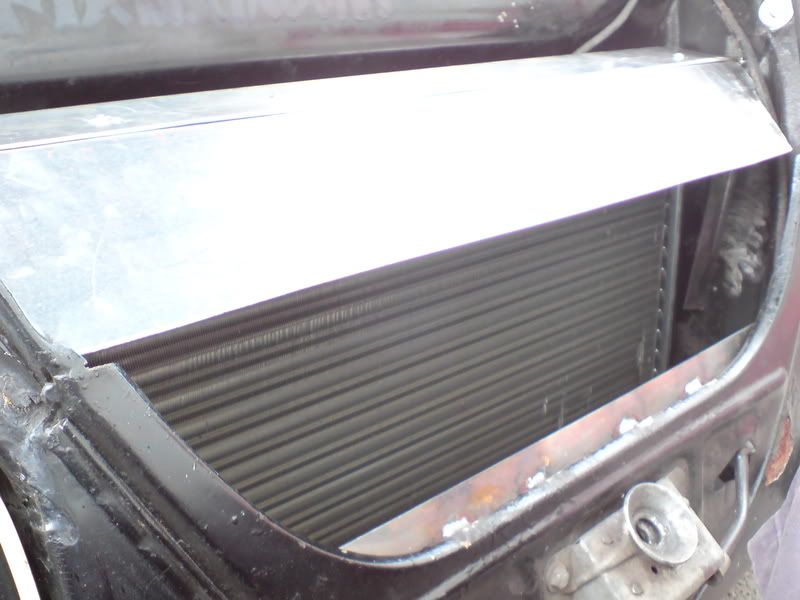

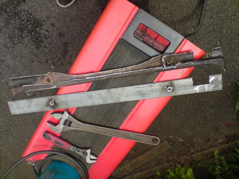

Stephanhipwell
Posts: 94
Joined: Wed May 14, 2008 1:59 pm
Post by Stephanhipwell »
AMBROSIA wrote:
Bolting it in is the easy part - it's the cooling system that will take the time - there's no standard or right way to do it - be creative! Idea
In a nut shell :wink:
tell me about it! i just ordered my hoses they come to 70 quid plus vat!! that's bout 140 usd.
that should be all for the time being, got my mate from vw to check my engine over and it needs a head but from what he can see he says it's ok. :D
have done most of the rad instalation and cooling ready for the engine and loom is al present and tidy, i will be testing the engine out of the car so as to overcome as many probs as pos.

AMBROSIA
Posts: 248
Joined: Wed Jul 27, 2005 5:37 am
Post by AMBROSIA »
Looking good 8)
I doubt you will need any additional scoop with the valance cutouts you have.
I look forward to seeing the finished project!

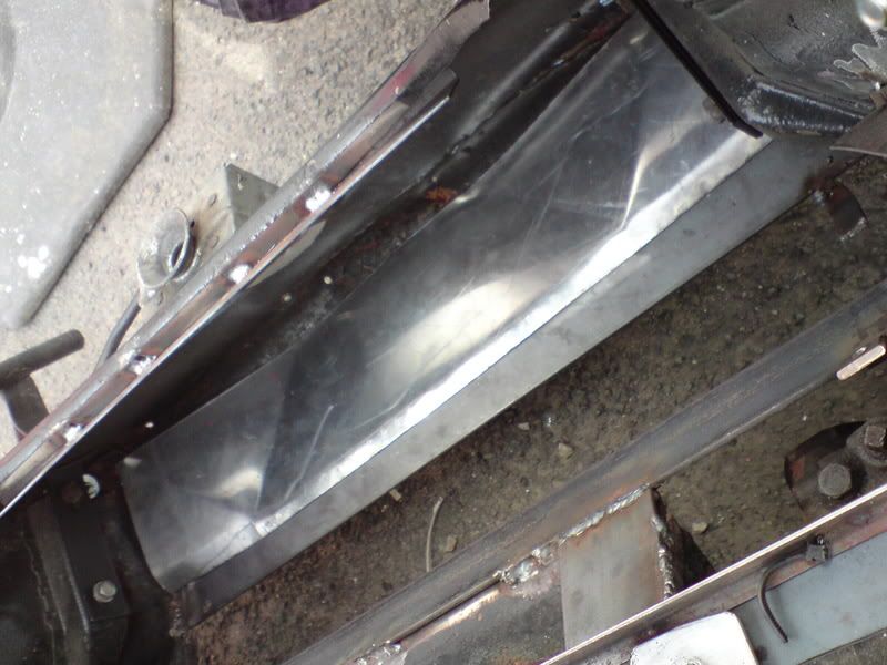

Stephanhipwell
Posts: 94
been busy this week. all is in and tomorrow i test the cooling system, engine runs fine.
been uber busy but will do a project thread when it's all done :wink:

Stephanhipwell
Posts: 94
i chopped the flages off bolted them to the heads the cut turned and welded to fit. it will do for now i think but i want to make a stainless setup at some point.
it is awesome. i tried it out today in the wet and was skidding all over. :D
