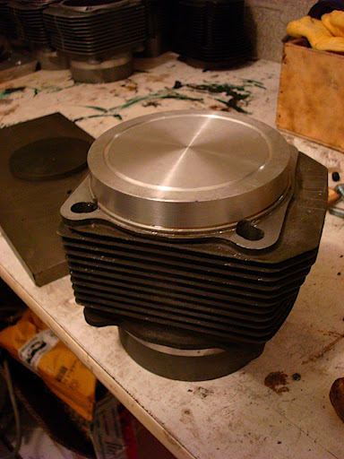

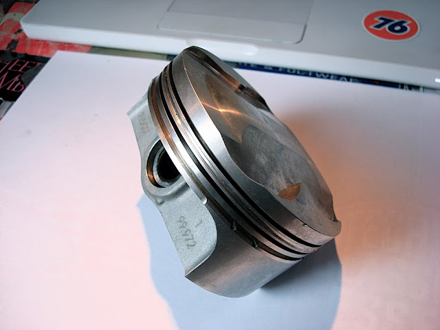

New 100mm Pistons:

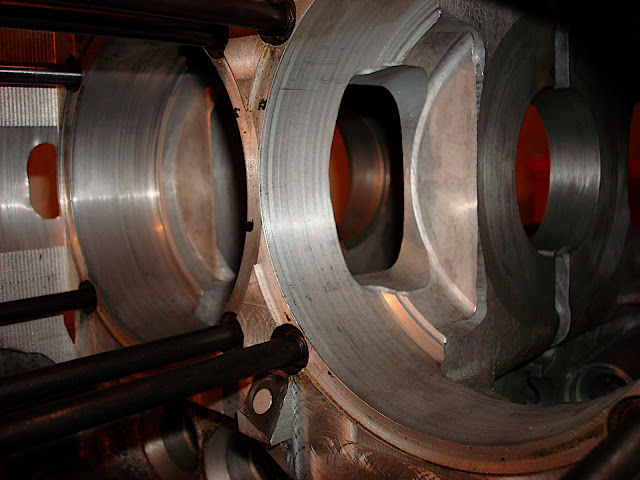

and some work on the Case:
before:
after:
Unkl Ian
Posts: 872
Joined: Sat May 25, 2002 12:01 am
Re: aircooled WBX 2546ccm
Post by Unkl Ian »
So now you need some 100mm barrels.
aircooledWBX
Posts: 33
Joined: Wed Nov 04, 2009 1:59 pm
Post by aircooledWBX »
Damn right :wink: Deutz 912 i think !

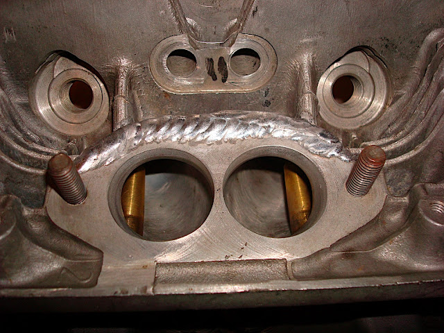

The heads were tig welded, cause i don't wanna use the pre-owners idea of hemi chambers. The Edge on the Top is for a second sparkplug:
To get a bigger gasket face with bigger inlet ports, there was some more welding:
Thanks for any tipps or comments !

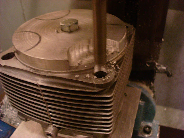

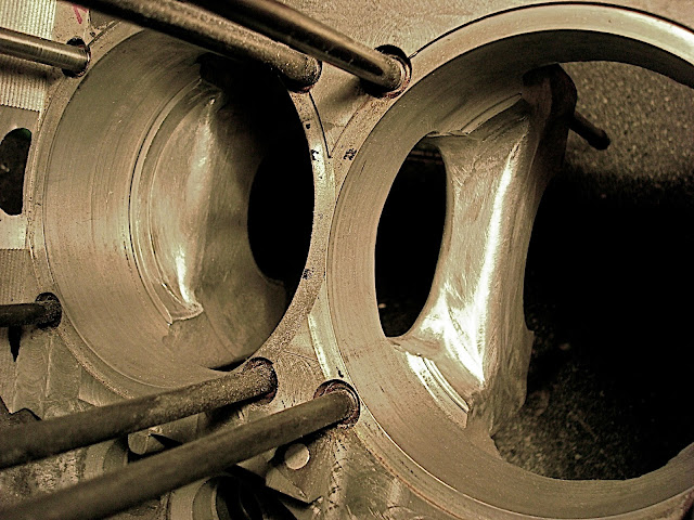

Some work on the cylinders done today:
Seems to fit:
Sadly found a little crack :cry: Don't think its caused by the machining. Seems it has been there before. I suppose unsafe keeping/disassembling of the pre owner is the reason:

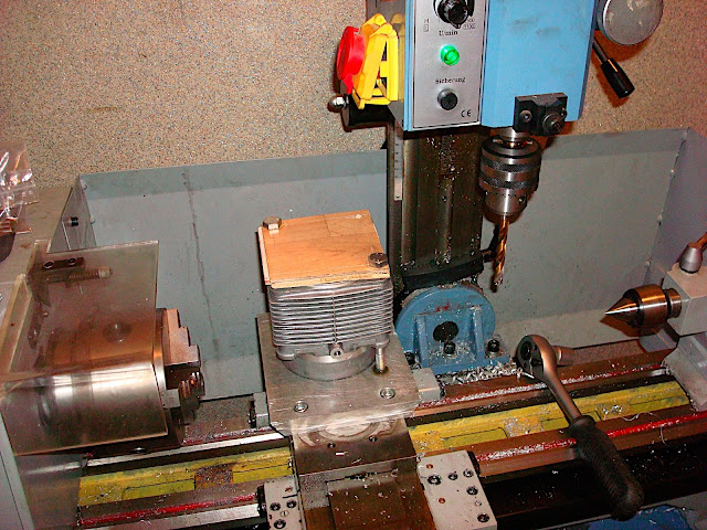

Today i began to lathe the cylinders. I did not have any technical schooling,
so everything is learning by doing :roll: Concentricity was about 5/100 to 1/10mm.
Hope you are pleased with my work :wink:

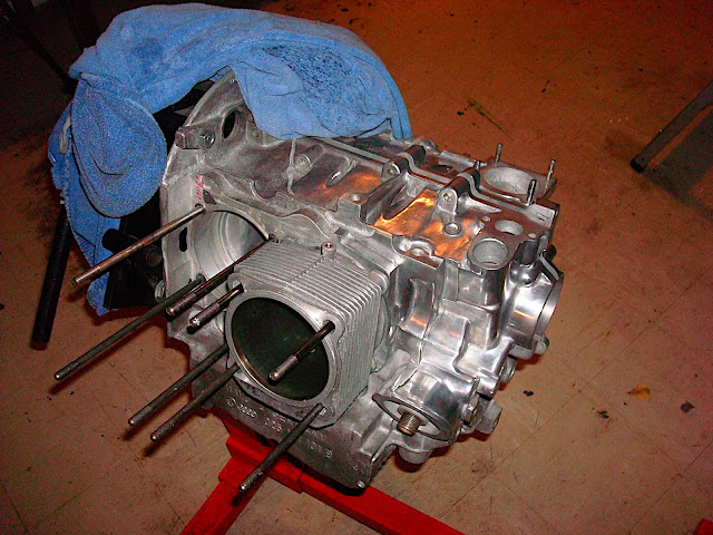

Do NA Engines not interest anymore ? :mrgreen:
First Cylinder fits:
Wally
Posts: 4569
Post by Wally »
Your cylinder is upside down :mrgreen:
Nice work man!
