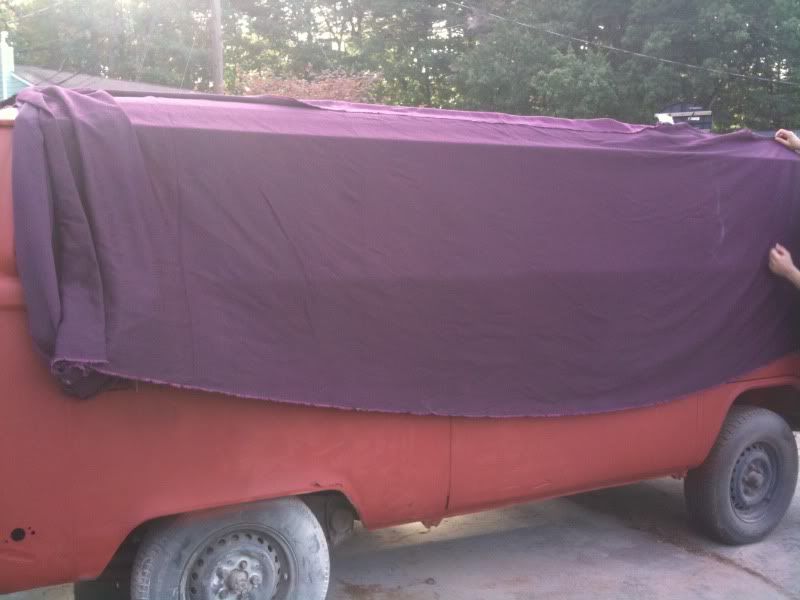

It does, and my daughter's bay has a matching pair...
We decided painting it was too much of a pain so we figured you could just cover it in purple fabric instead, whatcha think?

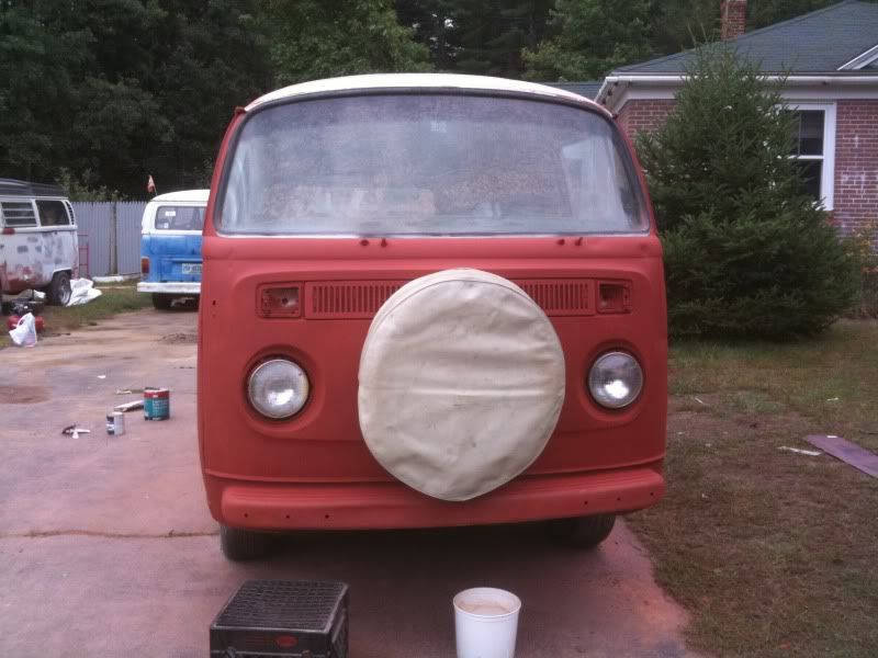

Gots a nose!
The weather today isn't very friendly - cool and windy - so I pulled the carb off for a rebuild. Apparently this was done recently by the PO but I think he was in an altered state when he thought of it cuz it was NASTY inside. Cleaned it up. The bus wasn't getting fuel, between the jammed needle and the float with less than 1mm of travel, I don't know why it wouldn't start :roll: . I'll put it back on tomorrow and see what happens.

That purple cloth is lovely. Who needs to see out the windows, right?
HE HAS A NOSE! Awesome :D

So, I was traveling most of the day (moving my mom out west) and it is raining. Still. BUUUUUUuuuuut, it wasn't a wasted day. I put the carb back on him.
And.
He
STARTED!
Didn't run long or well, backfiring through the carb and the choke needs to be adjusted but HE RUNS! Hopefully tomorrow, after the battery is charged, I can set the timing better and adjust the choke so it doesn't fling itself open when cold instead of 4/5ths shut.
