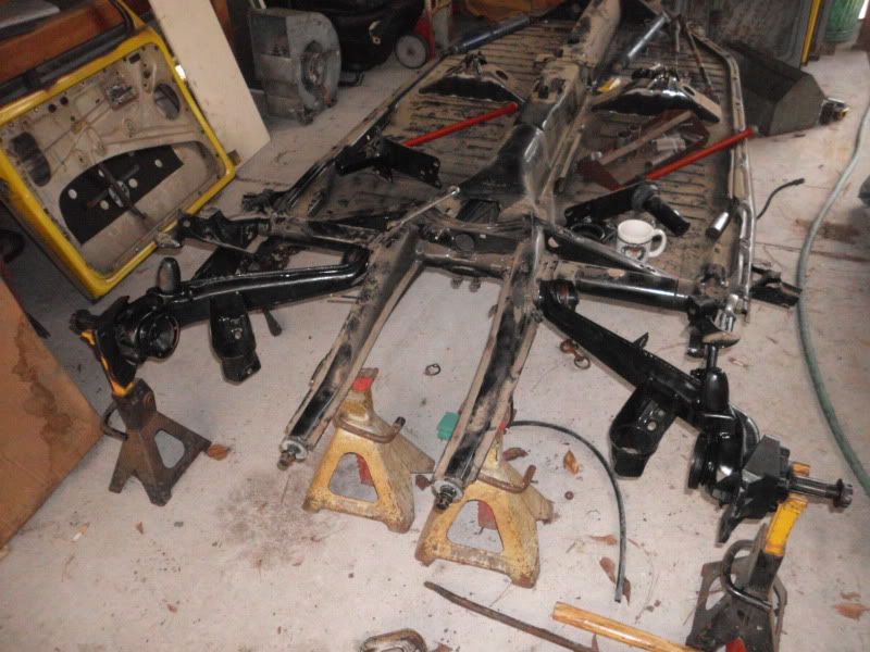

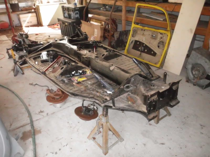

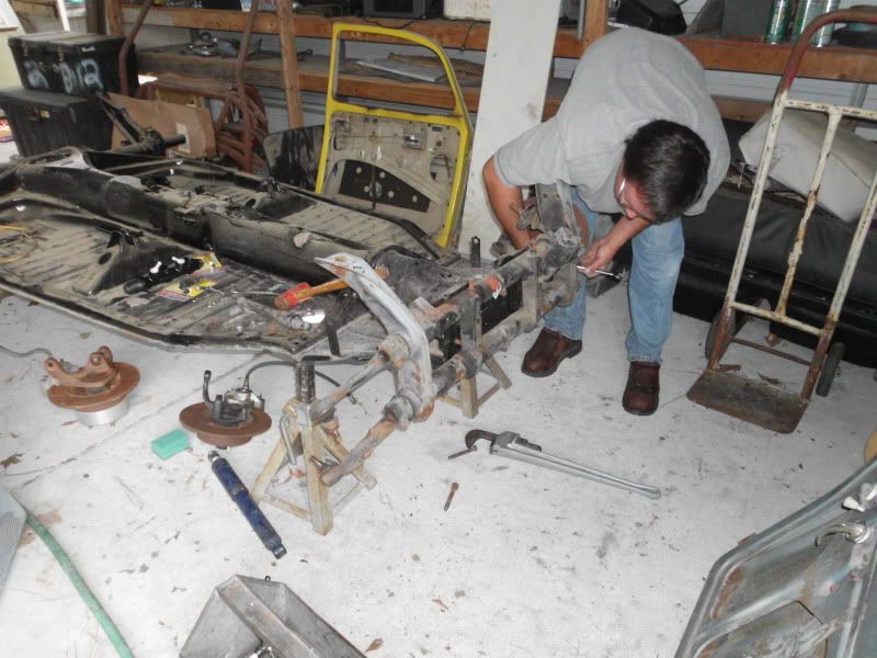

I am taking all the good parts off the pan the 62 is on and putting them on a 74 pan that I have. The 62 is already on a IRS Ball Joint pan. On the rear I will be using the coil overs that came with the 62. Just putting it back together and painting as I go.

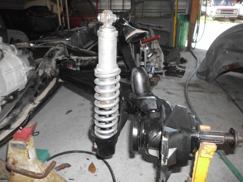

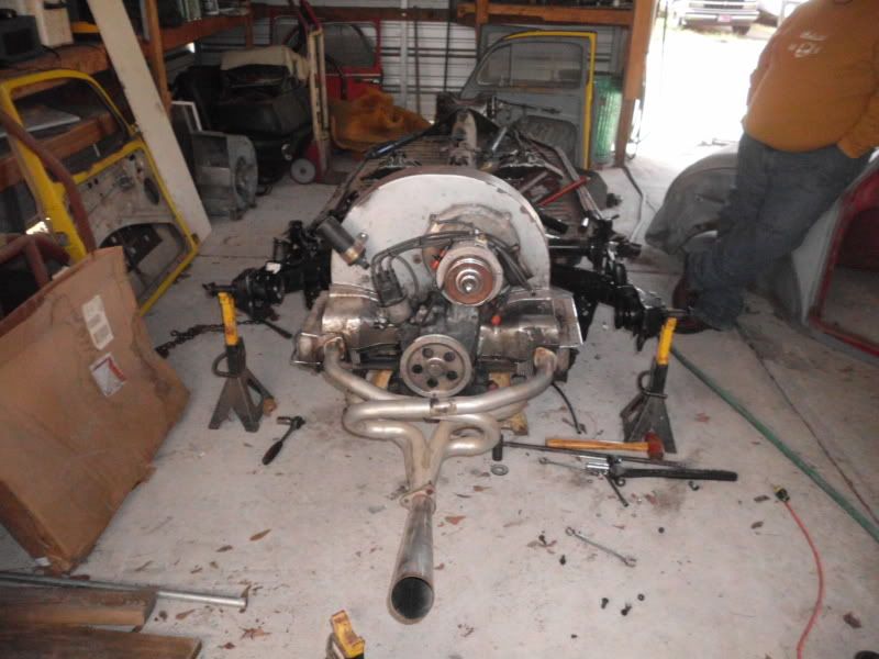

I got the rear suspension pretty much put together on Saturday. We removed the torsion bars and then installed the rear arms with the torsion bar eliminator kits. I still have to get some rotors for the rear.

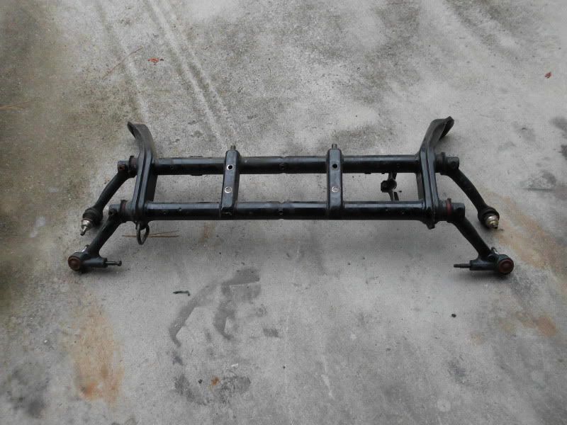

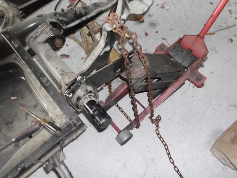

Removed the old crusty pretzel shaped front beam so I can narrow the new one and install some adjusters.
The beam is brand new all I need is tie rods for it and the suspension will be like brand new.
I am installing the coil overs upside down the spring fits the factory lower bracket (pocket) like it was meant to.

We slide the tranny and engine on and called it a day in less than 2 hours.

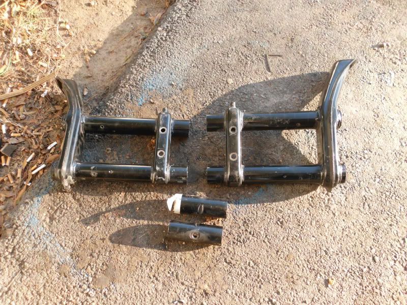

I know you re-aligned the Beam using a piece of angle iron when welding it back together....However Jesse James slid two new pieces of steel tubing which fit perfectly inside his open Beam on each side, then adjusters. It's much stronger! But you know this already. Where did the other Beam you replaced bend/twist, or had it been in a accident?

I think from watching this video he just welded the adjusters in the front beam however on the torsion housing he used the tube in a tube technique.

When the Show originally ran on TV it showed him using tubing in the beam. He also joked about it being a long time shortening a VW beam.......He wasn't sure if he could still do it! The foreign Youtube video left the step by step process out....I remember recording it on my DVR but later lost the program because the DVR had to be replaced.
