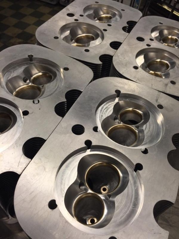

Re: 2,23 ltr - not so cheap - type 4 turbo build-up
Hi Wally
I forgot to ask earlier, what material was used for the seats ? JM 7 Bronze ? I thought I remember hearing that Beryllium Copper wasn't allowed to be used in Europe ? And what stem diameters on the valves ? 6 & 7mm
I would like to try the JM 7 Bronze or something compatible with less safety issues on a set of heads I want to switch to Titanium.

Hi Richard,Type 4 Unleashed wrote:Hi Wally
Yeah, its not berrilium-copper, but exactly what alloy combination it is, I dunno tbh. Probably the JM7 bronze you mention. I think if you email Jacob at gbot.dk I am sure he will tell you what alloy it is.
Yes, intake is 6mm, exhausts are 7mm. Iirc Jacob runs a type 4 with Titanium valves and these seats in his own car as well.
Sorry for the delay in respons, as I didn't seem to get notification anymore from STF..

After some nice, longer, rods - together with the marriage gears
- came in from Pauter just before X-mas, I got back into the engine finally being able to measure PR length and valve notch depth.
With the ratio rockers, I now got 15,5mm valve lift! I've never ran that much lift
We're finally getting somewhere! (firstly it will run N/A however, just to get a base line).

Wally wrote: with the marriage gears-
Is that slang for Straight Cuts
I like around .600" for a daily driver, and with 6 & 7mm Tit valves they will be really lite even with the head dia's you are running. So spring pressure can be kept down, I would look at 350 to 380 over the nose and 130 seat.

Yeah, in reference to the 'whining' they usually seem to induce as was mentioned beforeType 4 Unleashed wrote:
Is that slang for Straight Cuts![]()
With the Ti retainers and even Ti keepers, it will all be indeed very lightweight. I chose CB650's as I have really good experience with them. Since the valve length was kept a tad bit longer iirc, spring pressure will be a little less then the CB650's run with in stock installed height mode of course. I'll measure installed height again soon as I don;t have the head porters info handy atm.
With the relative short duration cam relative to the amount of lift and an anticipated 7500-8000 rpm range at a considerable amount of boost (in the future), a bit overkill in valve control is good practice I thought.

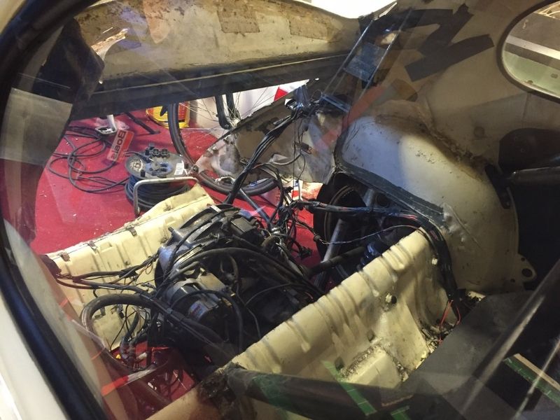

And the parcel shelf is back in, upsidedown this time. Should be ample room now for turbo placement more forward in the car

Looks real good Wally! I am envious of the space you have in there!Wally wrote:And the parcel shelf is back in, upsidedown this time. Should be ample room now for turbo placement more forward in the car![]()

It is indeed a big gain in space. Later when I will build the header will it be more clear why I need the room for the turbo there
Here you can see a bit more where it starts and ends in the cabin:
(sorry for the darkness of the pics)

Nice modification Wally!
