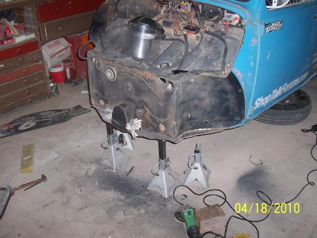

step 1- do this to the front of your baja
- bajaherbie
- Posts: 9967
Re: “Another Texas Baja”
just kidding, step 1 is not necessary!

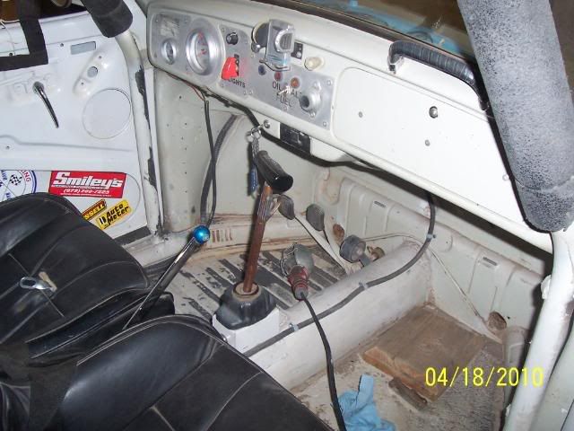

here is the best photo of my install... you can see the shift shaft above the tunnel. i used the stock shift shaft, straightened it and welded an adjustable end on it and used the "early" style coupler to mate it to my 002...
i cut a 8 x 10 (approx) hole in the vw sheetmetal and fabbed a removable cover out of some ghia sheetmetal. if you look closely you can see it.
i also bought a empi shift box which i welded on top of the tunnel in the stock shifter location. i fabbed a plate to cover the old hole before welding the shift box in place. if you have any questions, pm me you phone number and i'll call you...........collect!
