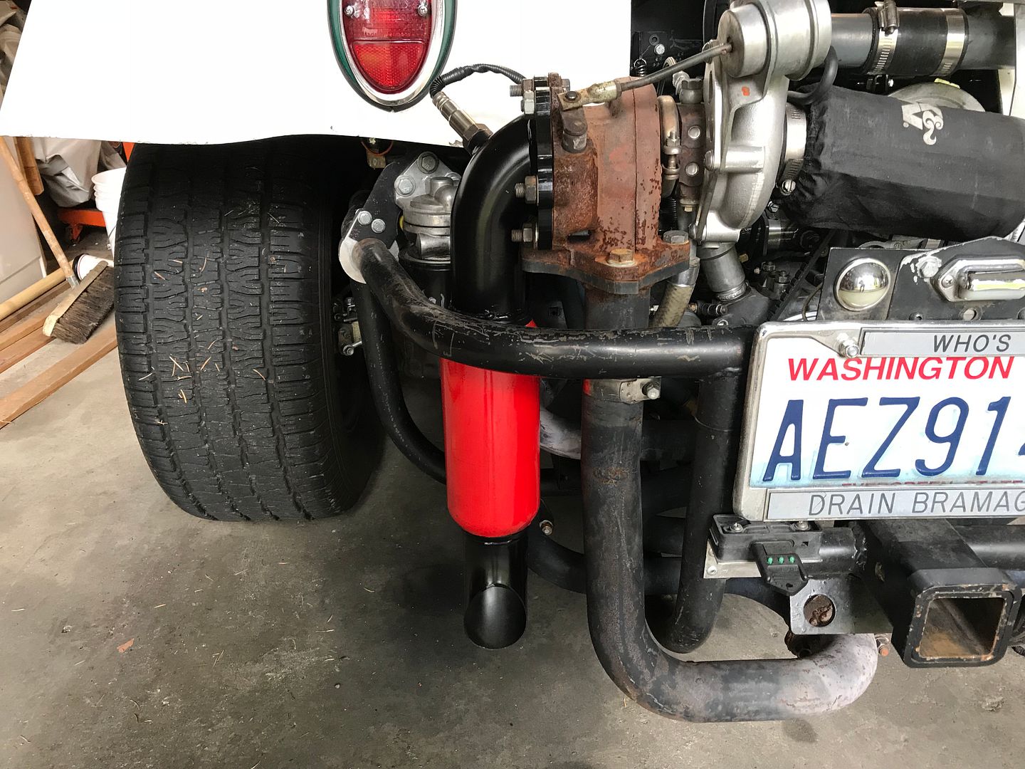

Any secrets on keeping my O2 sensor alive. My analog Autometer gauge wasn’t reading on my last short joy ride. Maybe the ride was too short? But I’m guessing I’m too rich.

Re: Another blow thru 1600 build
Hate to say it, but I haven't had to get a new O2 sensor since switching to My PLX ,Clonebug turned me on to them

Clonebug
- Posts: 4756
Do you have it mounted between the 10:00 and 2:00 position?
Any other position than that area will allow condensation to get into the sensor on startup and will kill the sensor.
It should be maybe six inches max from the outlet of the turbo and on the high side of the exhaust pipe to stay dry.
It also needs to be hooked up to ignition power and the engine started right away so it doesn't get shock cooled from the moisture in the exhaust.
Mines under the turbo, in the up pipe. When the engine been sitting and it cold, it doesn’t start right away.

So it's Before the Turbo, I think it needs to be on the discharge pipe You can see mine
This will give incorrect readings. Back pressure has an effect on what the sensor outputs. I saw 10+% years ago when I installed sensors pre turbo, compared to the sensor after the turbo. Move it to the downpipe.
Most O2 sensors that I know of take an 18 mm thread.
If or when you move it to the dump pipe....you will need to make sure your dump pipe is long enough that you don't get a false reading from reversion of fresh air.
I would make sure you have at least a foot if not 18 inches of exhaust after the sensor. A muffler would help keep fresh air out too.
Also make sure you have your sensor clocked in that 10:00-2:00 position so no moisture can get trapped in the sensor end and ruin it. Keep it as far up the outside of a bend as possible.
This position has given me very good results with high mileage using the same sensor for years.
