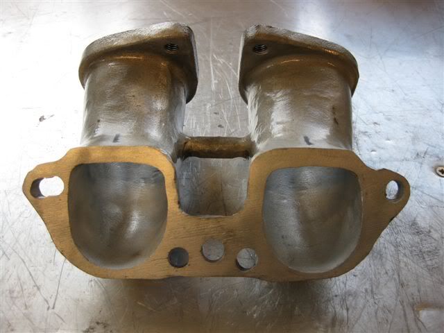

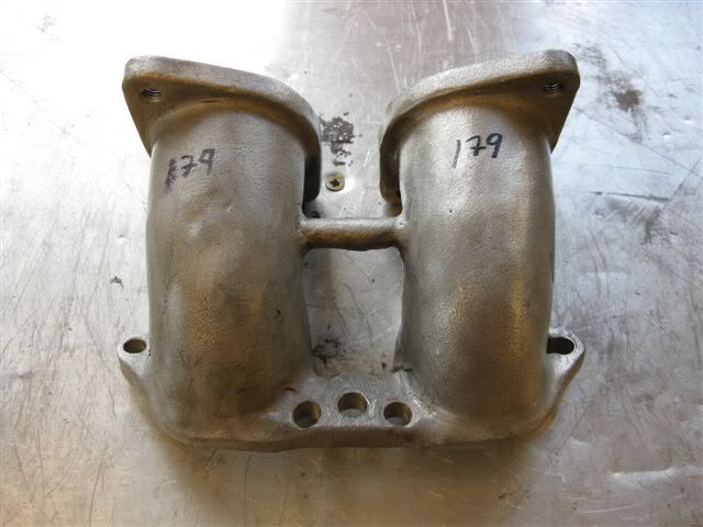

The manifolds were welded and shortened...bj wrote:did you make your own manifolds?
very nice i must say. looks very stock in the car too!!!
did you have to modify the body much?
i used stock length rods, but need to trim near the passenger side valve covers a bit to make more room.
bj
Before:
After:
I had to modify (bend) the body a bit to make the engine fit...
