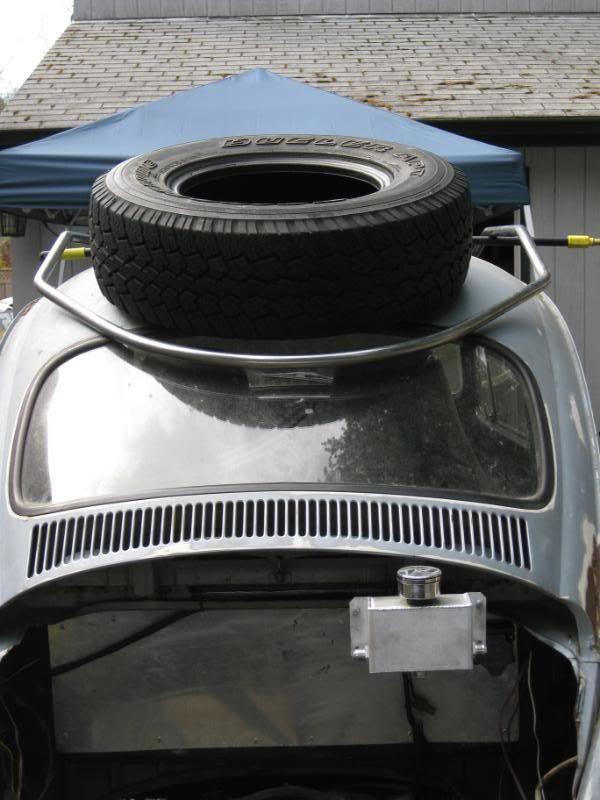

I bought the tank second hand off of TheSamba I think, it was years ago :oops: The guy before me is the one who massaged it for a stock 165 spare if I'm not mistaken... It's one of those aftermarket 15 gallon units, but I think it's probably more like 14 now. For the spare I'm thinking just above the rear window on a roof rack, or maybe even over the engine - really depends on the cooling system/intake/exhaust.

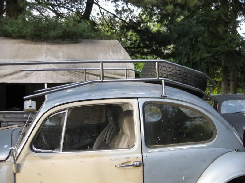

Had to pick up more tubing to build the other nerf bar, and decided to pick up some extra just in case...and guess what happened:
20 footers are a pain to maneuver my oneself :x

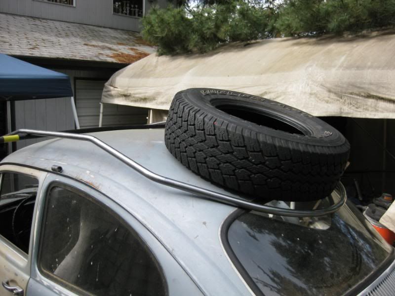

Re: Chris' car (aka, "project someday when it's warmer outside")
nice job on the large radius....
what did you use?
Chris V
Posts: 3416
Joined: Tue Sep 03, 2002 12:01 am
Post by Chris V »
Hand bent it around the baja's back tire...I was lucky, got just enough bend before having to cut the fender off (pretty sure all the bolts are frozen SOLID).

namelesswonder
Posts: 838
Joined: Sat Sep 22, 2007 10:37 am
Re: Chris' car (aka, "project, yo it's warmer outside")
Post by namelesswonder »
Oooo that is a very cool roofrack. What are you doing with the front end of it?
Posts: 14100
Chris V wrote:Image
This really gives me a great idea for my roof rack.

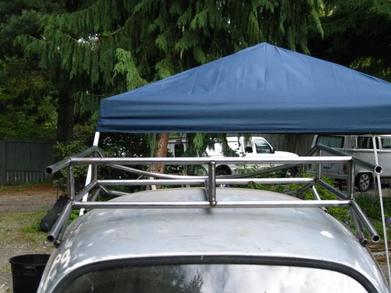

Chris V
Posts: 3416
Post by Chris V »
Thanks, I'm thinkin' I saw BajaHucks (right?) sweet light setup with a linear actuator rod for aiming them - I'd like to go that route down the road...so for now it's going to be left somewhat unfinished :lol: It's too much of a luxury item to justify it at the moment $$$.

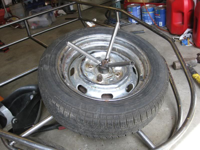

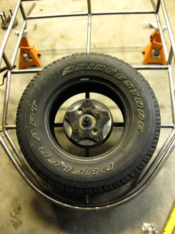

Went back out after dinner and got the spare tire mount squared away for the most part...have you any idea how long it takes to cut a stub-axle in half with a chop saw :shock:

turbobaja
Posts: 2826
Post by turbobaja »
Rack's lookin real good Chris. I saw a baja @ spring fling with a similar rear contoured tire mount, but with some heavy looking 1.5" tube. I like the tire mount with room left for gear, very slick.

Chris V
Posts: 3416
Post by Chris V »
Would that be the "ARMY" baja? I've heard of this car, and have yet to see it...Guys name is Bret, he's on Olydubs forum.
1-1/2" sounds a bit intense, I've seen a couple that the bottom tube looked to be 1-1/4" and thought that was more than enough :lol:
This thing is still just tacked together, and it has no problem holding my ~170lbs with little to no deformation...I've got about 52' of tubing into it right now...give or take.
BTW, plan right now is to run an expanded steel deck in the storage area and bolt an old steel toolbox up there for some spare room...besides the extra space for carrying coolers and whatnot. I'd like to find a mini (trailer size) diamond plate 'bed box' too.
fusername
Posts: 6806
Post by fusername »
Chris V wrote:have you any idea how long it takes to cut a stub-axle in half with a chop saw :shock:
yes, yes I do, but i like the design plan, finally a good use for all those doughnutted rear drums
that is one gorgeous rack, good to hear its nice and firm
