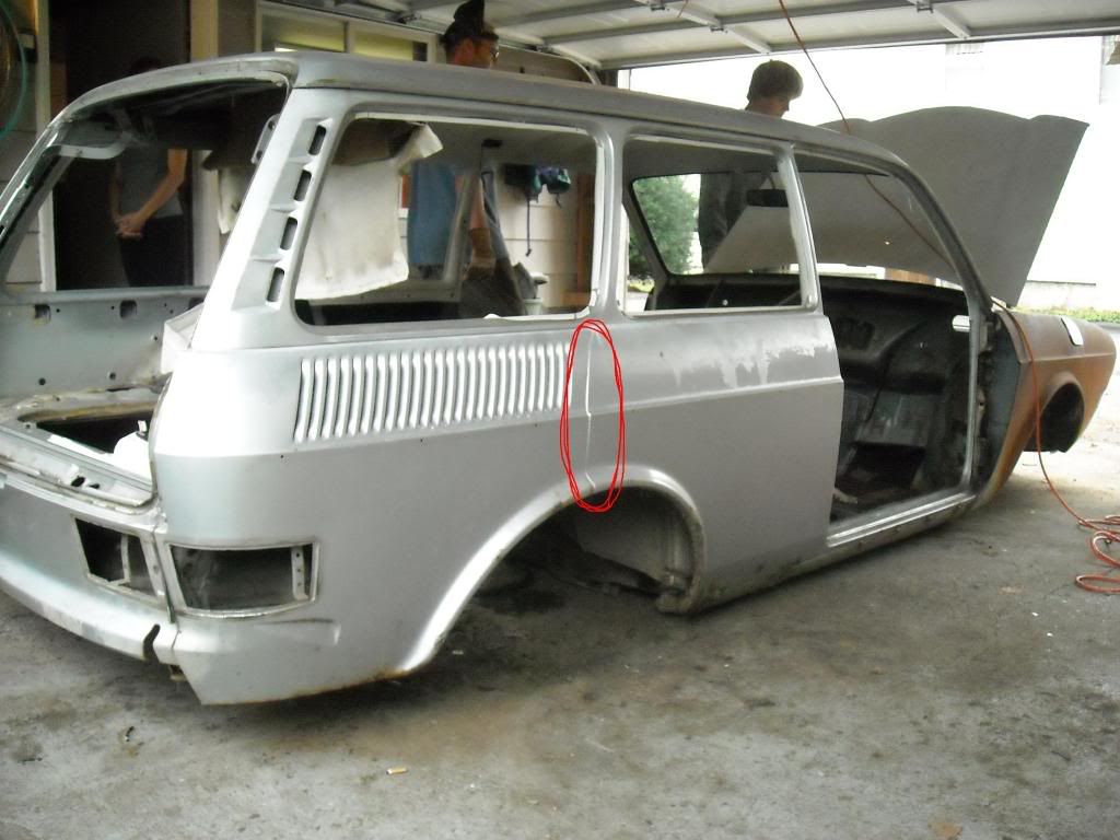

The Links arent working at the moment, but I seem to remember plumcrazee bondo-ing the rear body panel into the car (see below pic). Did you in fact do this (I can't see the pics anymore)? If so, how did it work? Can anyone forsee problems with leading, welding, or bondoing this panel to the ajacent one? See pic below. The reason is that I am planning on painting my car in a few weeks and think I would like the look of a completley smooth panel, and it shouldnt add a lot more work to just tack this on to the list of things to do.
plumcrazee
- Posts: 128
- Joined: Mon Jan 02, 2006 10:18 am
Re: 412 resto
hi mate right the only problems are if you have a small knock then it expensive to replace as you will have a far more repair to do than just unbollting the wing other than that there is no problwm apart from upsetting the purists
i did it on mine by bolting the wing on and then using just normal body filler and yes it has cracked on the seem as i guessed it would but when i spray the car later this year i will most likely use fiberglass reinforced filler of just tack weld it every 30mm down the joint to stop any more craking
hope that helps buddy
- bradey bunch
- Posts: 189
- Joined: Tue Aug 04, 2009 9:13 pm
Re: 412 resto
It helps immensley. I plan on doing the same thing because lead filler is almost NLA over here.
