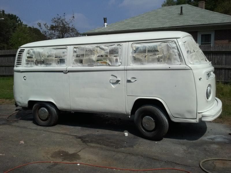

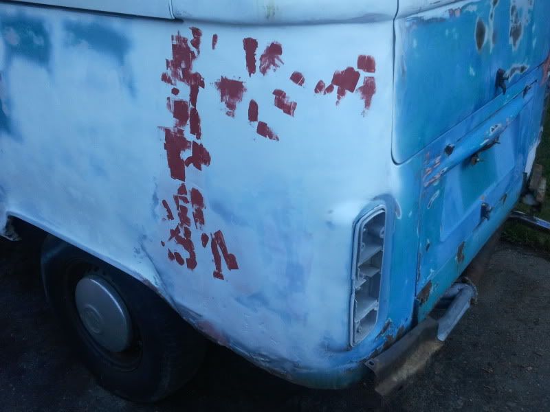

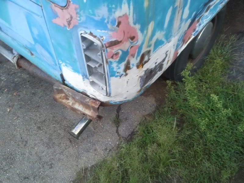

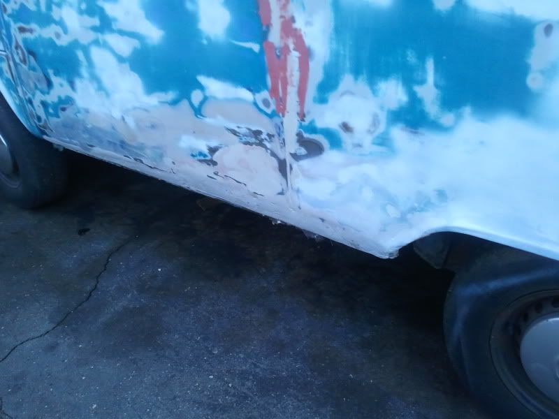

Ok, so the weather this weekend was amazing. We sanded and prepped the roof for paint. Today was perfect temp for painting so I shot it with a high gloss white. Then, I got a little carried away and ended up painting the whole thing just so it would be all one color finally. I need to still do bodywork on the doors, slider and rear corners (filling and sanding) but by painting those areas, it really helped me see where I need to still fix stuff...and where I thought I did but it looks good. Once I get the other issues fixed, I'm going to shoot from the beltline down in a screaming yellow. I'll do the wheels in yellow and the hubcaps in white. The front grill, bumpers and emblem will be white as well. I think my daughter will like the finished product.
