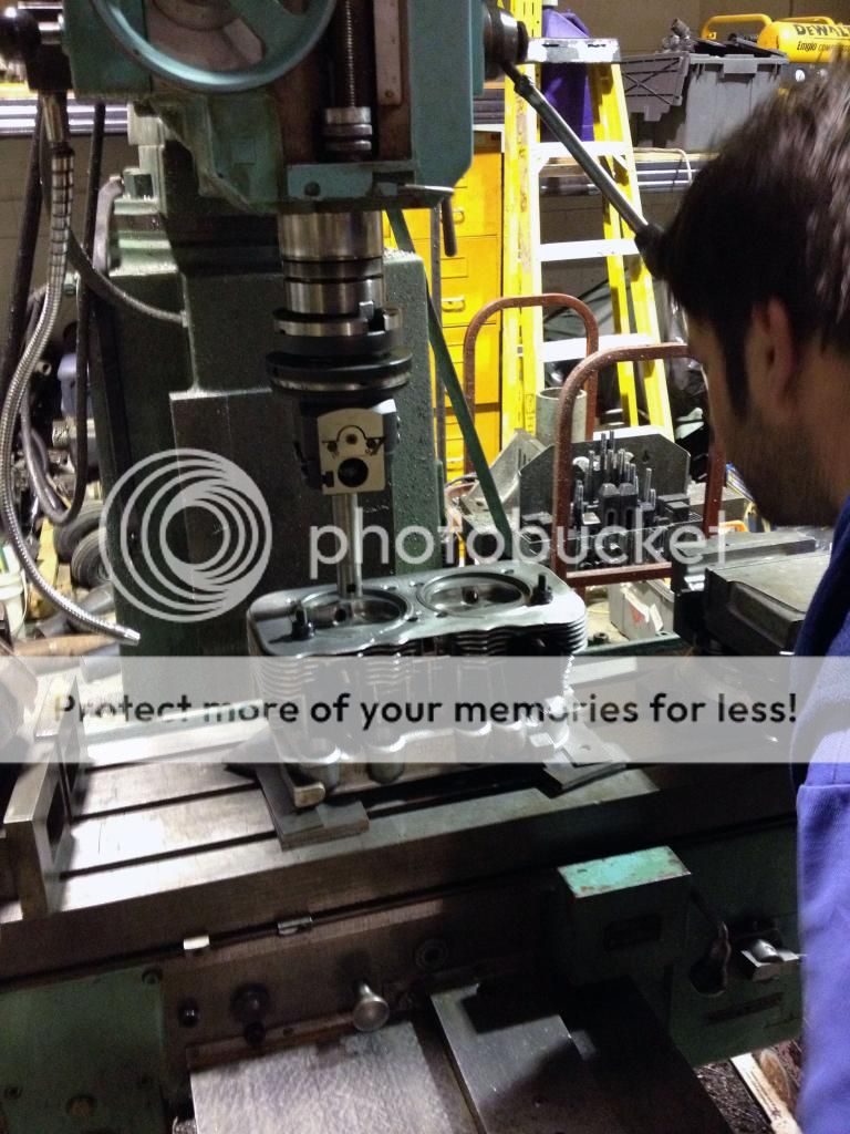

Ok I am back from my European experience and have set up shop in Montreal. The turbo engine is out and I am full speed ahead on the type 4.
Here is a shot of Steve working on a set of my heads.
I ended up taking the heads off to fix the exhaust studs right and decided to shave .45mm off the deck height (it was 1.45mm) by machining some meat off the back of the cylinders, so now it should be perfect.
http://i473.photobucket.com/albums/rr94 ... 8b8eb8.jpg
