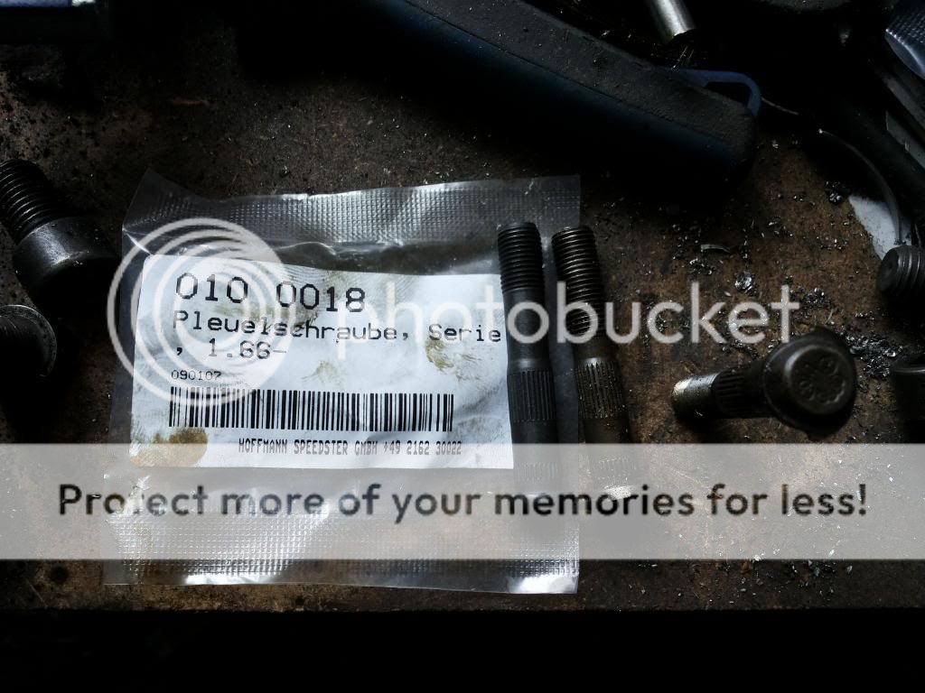

ruben
- Posts: 21
- Joined: Wed Mar 07, 2012 4:13 am
Re: Waterboxer engine
i'l chime in on The rod bolts, ordered these not 3 weeks ago.
came from germany hoffman speedster has them in stock.
http://i431.photobucket.com/albums/qq36 ... 512bc2.jpg
puled the old one's out and put these in on my ex works rebiuld 1.9. DF soon to be DG with some tricks
have you asked the vw dealer? they are reputed to be able to order these parts atleast in europe...

Passatman
- Posts: 1039
- Joined: Mon Apr 08, 2002 1:01 am
Ruben did you check your big end to see if it was out after changing the bolts.ruben wrote:i'l chime in on The rod bolts, ordered these not 3 weeks ago.
