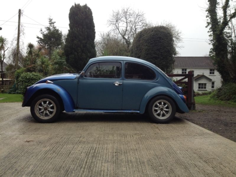

I had a look at the car today and it's touch the bump stops but this was parked facing down a hill so need to re check and probably trim them!
andy198712
Posts: 2433
Joined: Wed Apr 13, 2011 1:01 pm
Re: Bit odd at speed?
Post by andy198712 »
Little cams day pic on a flat surface!

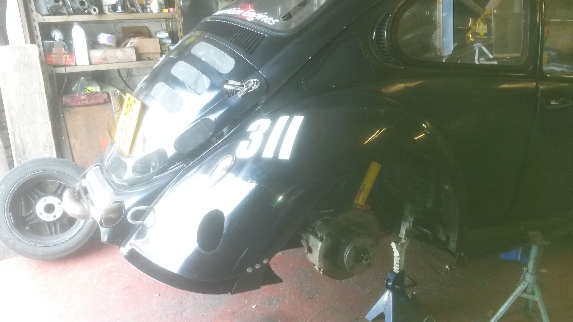

Sorry Andy, bit of a high jack, but just about applies to the topic, Steve, it's not a very clear pic, but you can just make out I have the Porsche torsion covers in use, I've over slung the rear Spax shocks to free up space underneath avoiding all the clutter and allow the Venturi to fit, the a arms are flipped for camber reduction and turrets are done in the wheel arches ready for coil overs if needed, top shock mountings are built into the roll cage.
next I need to come up with something along the lines of piles idea for custom bushes, the Porsche covers certainly offer more scope for better bearings, I know there are some high quality billet uniball set ups out there, but I really want to keep as near the VW original concept as possible, is your car still a VW when it has mendy suspension front and rear??? , not in my eyes, keeping to the VW concept helps win races as it annoys the hell out any opposition, even more so when it's a ball joint car still using a beam...
