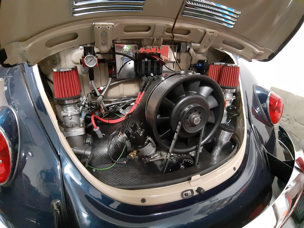

After assembly of the exhaust:
And the engine finished just before the first 15-20 minutes run
I hope i will have the engine with the new throttle control finished next weekend. Then Ill post a new (more up to date) update. :-)
Mark

That underside picture looks mean..

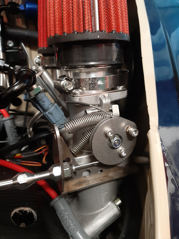

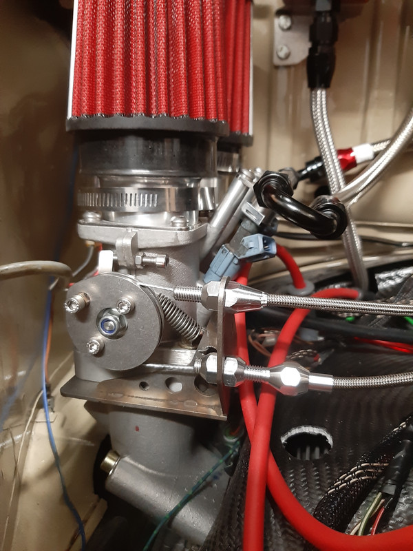

Just some pictures of the new linkage. I got the idea of the sync link, but build my own version.
It took some heavy spings to have the cables put back to idle position, but for now it works. Maybe in the future an update regarding this.
Mark

Sorry another question, but how do you use your magnetic distributer, it seem connected, (the 3 wires), but no leads to the plugs?
And I see a coil pack mounted to your breather box.

Regarding the ignition, I use the distributor only as cam trigger. The trigger rotor is modified so it only has 1 of the 4 trigger signals. I use it in my MS2 ecu for sequential ignition. And the coil pack is used for ignition. For now it doesnt work like it should, so I take a step back to oldschool 009.
Mark
