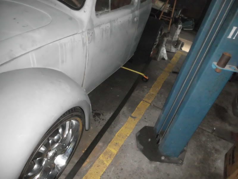

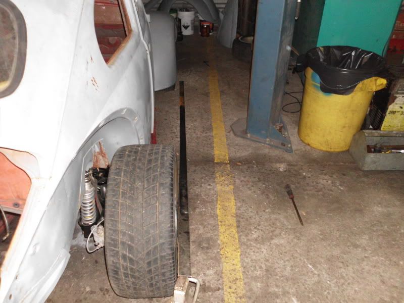

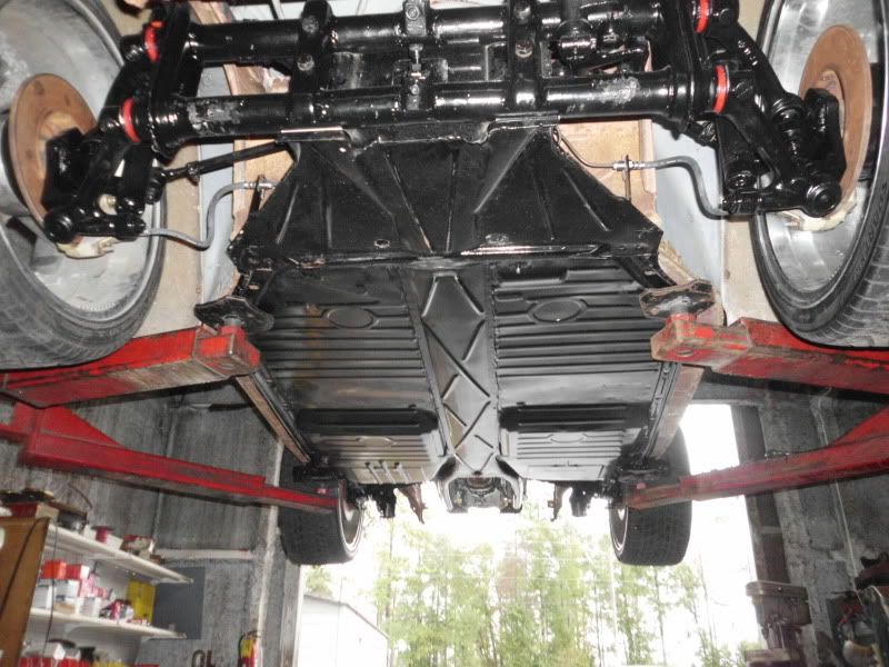

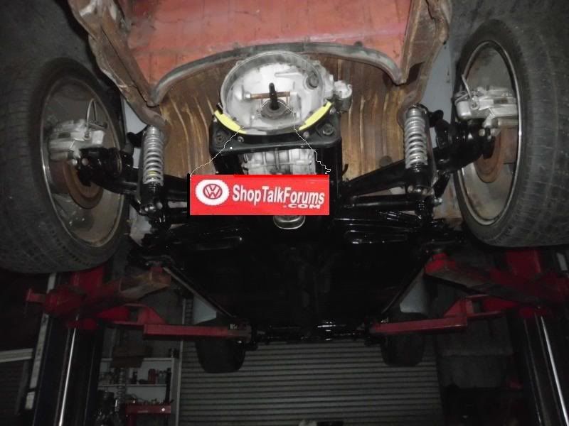

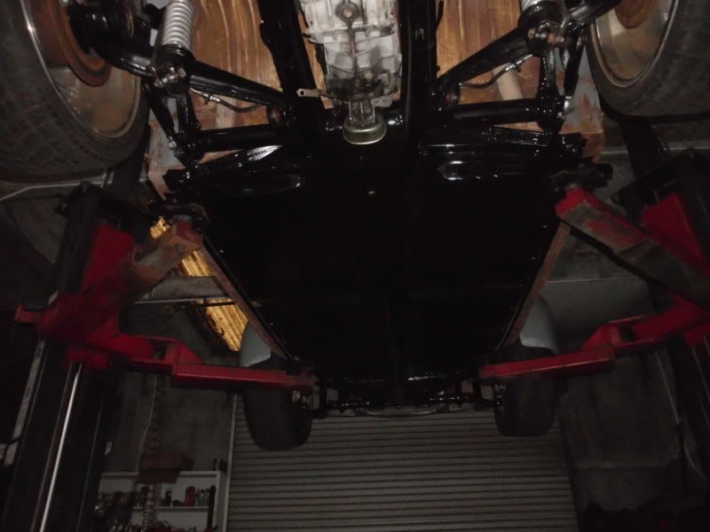

Spent the morning and early after noon trying to figure out why the left rear is toed out and the passengers side is real close to being right. We took off the torsion exterminator kit and measured the pieces to the kit and then swapped sides with the kit even though they measured the same. When I got the car it was on a different pan, and different rear arms and had the same problem with the left rear wheel being toed out. It makes no sense that I still have the same problem.

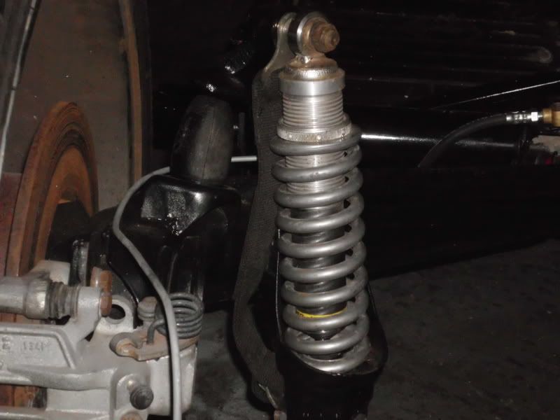

I did get some limit straps installed on the coil overs, so now it is easier to jack up the rear of the car.

It looks like the passenger side rear is toed out....Is that the wheel you talking about? Or am I seeing something different....the passengers side is real close to being right.
You may have a bent swing arm. Did you make sure the pin washers were spaced properly when going back together between the swing arm bushing.....

A nights sleep and a new perspective on things.

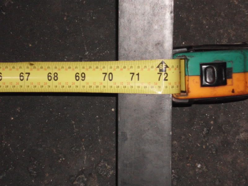

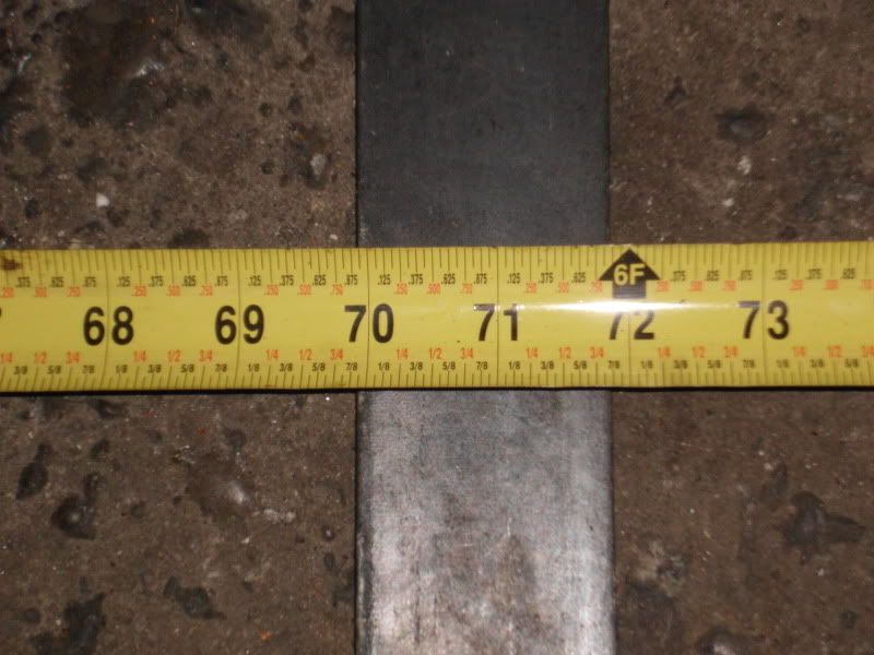

What we have here is an optical illusion. I was ready to snatch the rear arms off and bolt them down to the work table to see if one was bent. When I got to the shop this morning after cleaning up the tools and bolts under the car, I decided to use a 10 foot piece of flat bar to see exactly how far off the toe was to my surprise both rear wheels are the same from side to side, as you can see in the pics I took.
These first 2 pics are measuring the flat bar from one side of the car to the other side right behind the front wheels.
These next 2 pics are measuring the flat bar from one side of the car to the other side in front of the rear wheels.
These 2 pics are showing that the toe is the same from side to side so there is nothing bent or wrong.
So using the measurements I have. I have an exaggerated 7/16 of total toe in, which is not actual toe in. When measured at the front and rear of the tire it should be close enough. I will get it measured when I have some help.

Nope. We only had to turn the left side hem joint 1/2 a turn and the right side 1 turn to get the toe in specs.

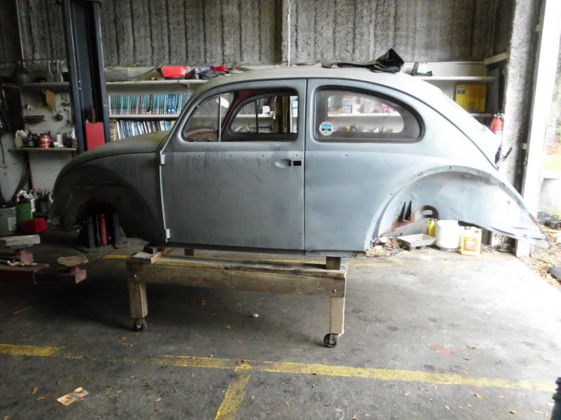

Got the new mounts on the tranny and a new nose cone gasket. Should be pulling the body off tomorrow and getting her running so I can move it around the shop on it's own power while I do some body work.

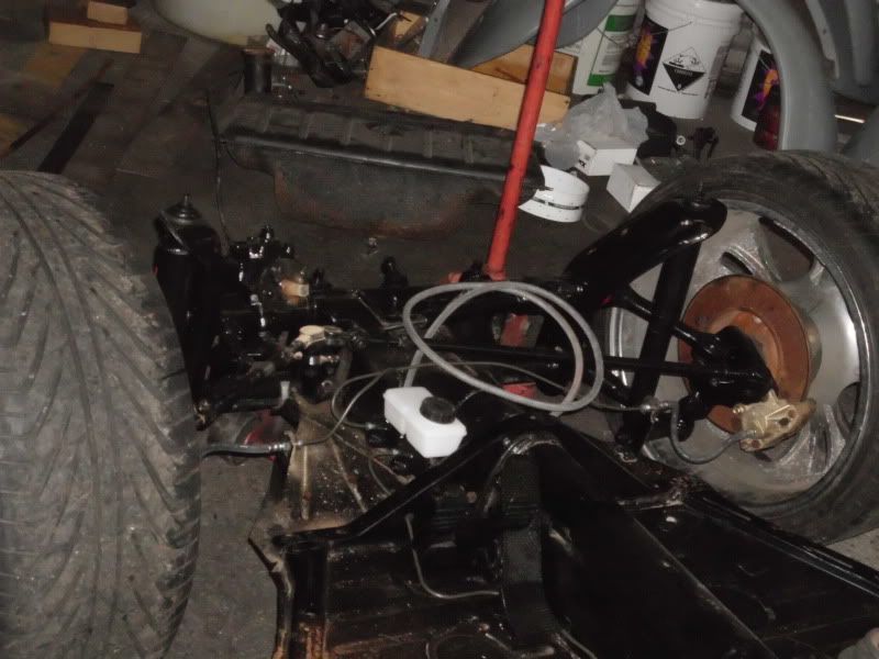

Is that a new change you decided on using the Brake Fluid tank at the master cylinder
I thought about doing it back when removing my tank and lines from the original location.....The only problem I see in doing so, is, it will be a little harder topping off/filling when flushing out the old stuff.
How's the clutch arm the release bearing is attached to. Remember back in NO JOKE heading home!

No line X on this one just the paint that was on it when I bought it. Yes it may be hard to fill but everything is brand new on the brake system so it shouldn't need any added for a decade or so.Lew wrote:No Line X!Is that a new change you decided on using the Brake Fluid tank at the master cylinder

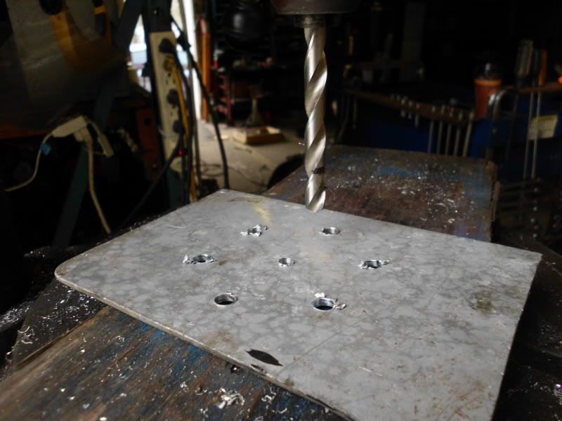

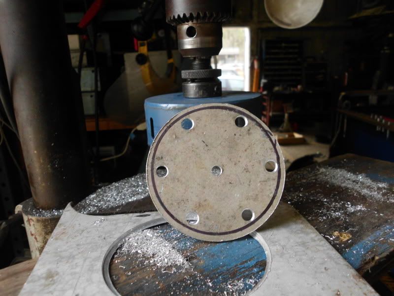

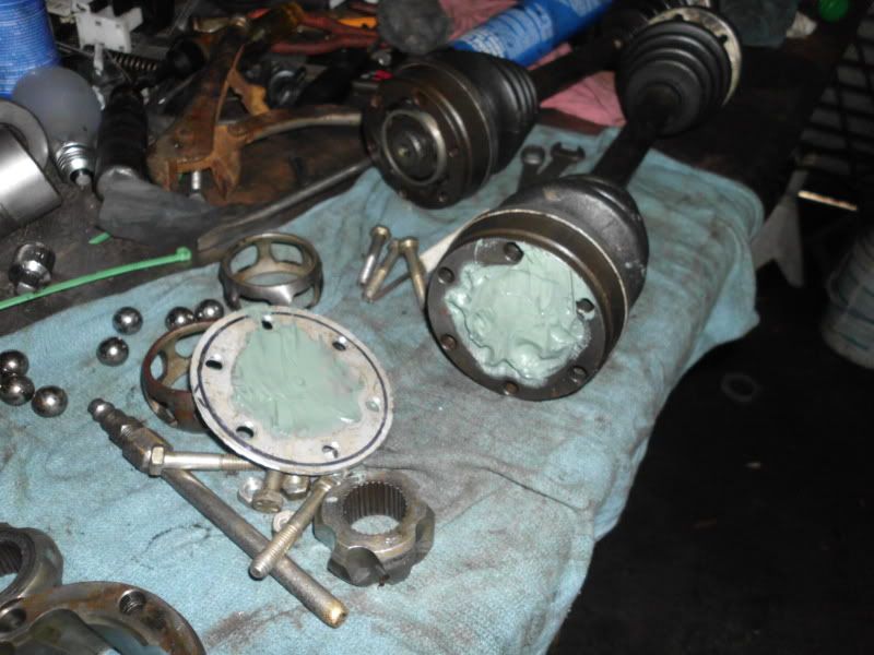

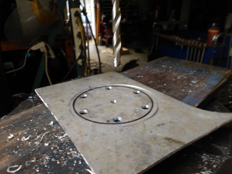

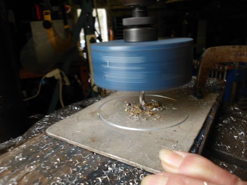

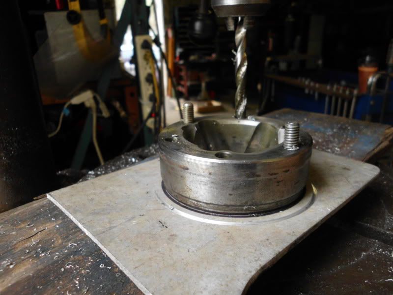

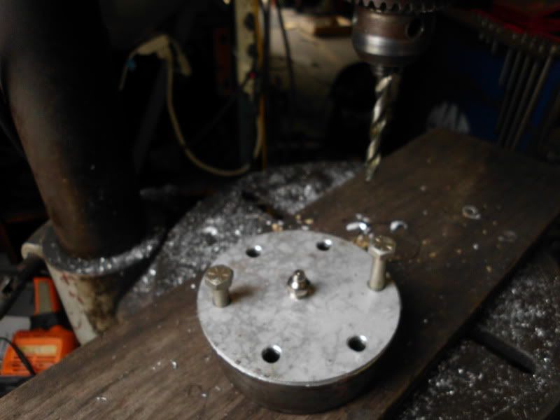

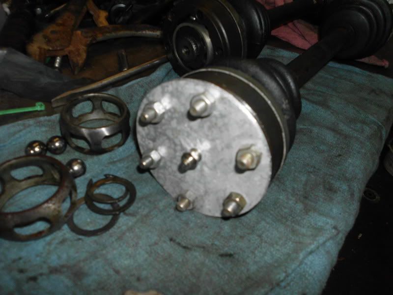

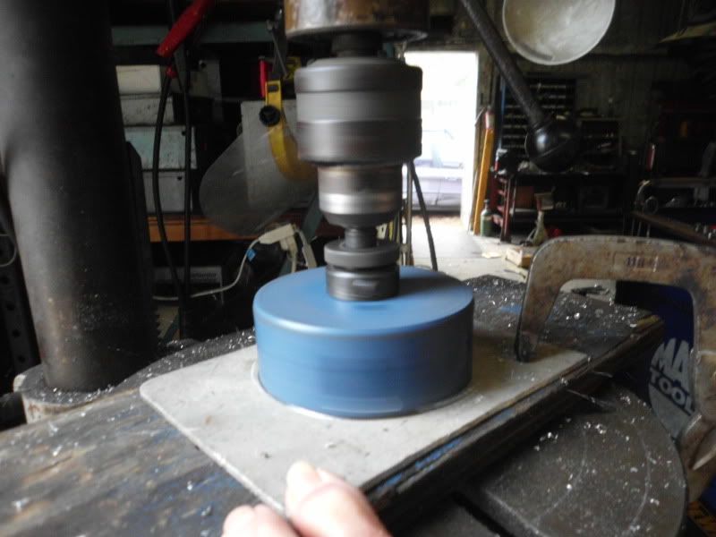

We used a piece of 1/8 inch aluminum plate and a CV joint to make an adapter plate to grease the CV joints. You can tell when you have enough grease in the CV's if you push the boot towards the CV when pumping the grease in.

OK I am wondering what I can do with the headlight buckets on the fiber glass 3 inch wider fenders for the 62? The 20's are fouling against the bucket in the fenders when turning either way. Is there a head lamp assembly that will work with about half the bucket cut off on the back side of the fender? Just something I am pondering about, because I won't have the body back on for quite some time. Got to smooth out the wrinkles in the body and throw some paint at it. Just hoping someone has a solution, that looks good.
