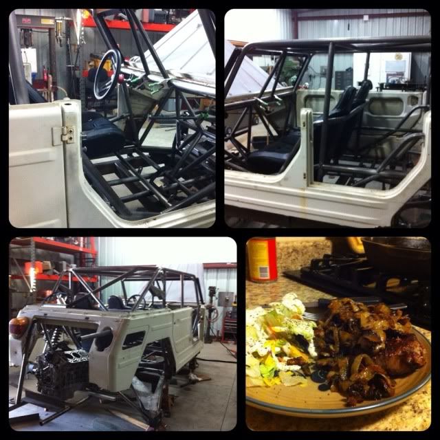

Well, mounted the rear seats stadium style and added some door bars. It is actually very comfortable! Moving on to front seats, mounting my Matomi steering column and fab'n up a fuel tank. Never made a flat tank. Hoping there won't be any issues. It is going under he rear seats. 16"x6.5"x47.5". I'll post a model for the experts to want on.
I can put it up front and use the under seat for storage. Any ideas on weight bias? If I have a choice should I put it under the rear seat or up front?
This should keep me busy for a while until I can get brakes. Talking to Dan today hoping he can get something from Jamar to get me rolling.

Finished the door bars and mounted the column. The. Had a 5lb. Ribeye!
